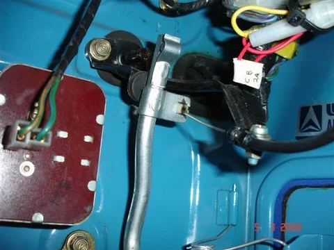

Gas pedal - at least on a diesel.
Here are some pics:
:cheers:
