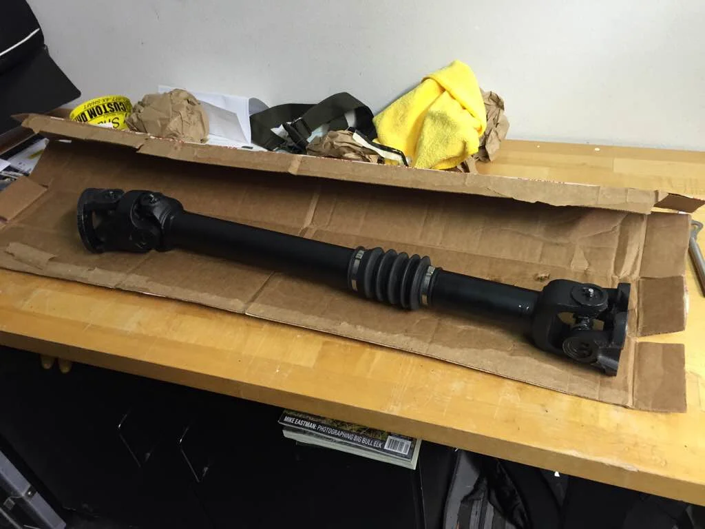

I got my dc shaft for 380 shipped made to order

So taking out the caster correction plates that came with the 6" kit reduced a lot of vibration on the standard driveshaft, but I ended up putting a DC shaft in the front. I have yet to reinstall the caster plates in fear that the vibration will return but was wondering if I should be afraid? Anyone running a DC up front with caster correction? This would make the pinion angle pretty high, which goes agains proper DC shaft geometry.
Your DC shaft runs ok but your castor angle is way negative. Those, including myself, with taller lifts of greater than 4” find that converting to part time is the best way to avoid dealing with front driveline vibes while being able to also enjoy plenty of positive castor angle for much improved handing characteristics.
To answer your question: If you put the castor plates back in, your DC shaft will vibrate and possibly worse than the stock shaft.
