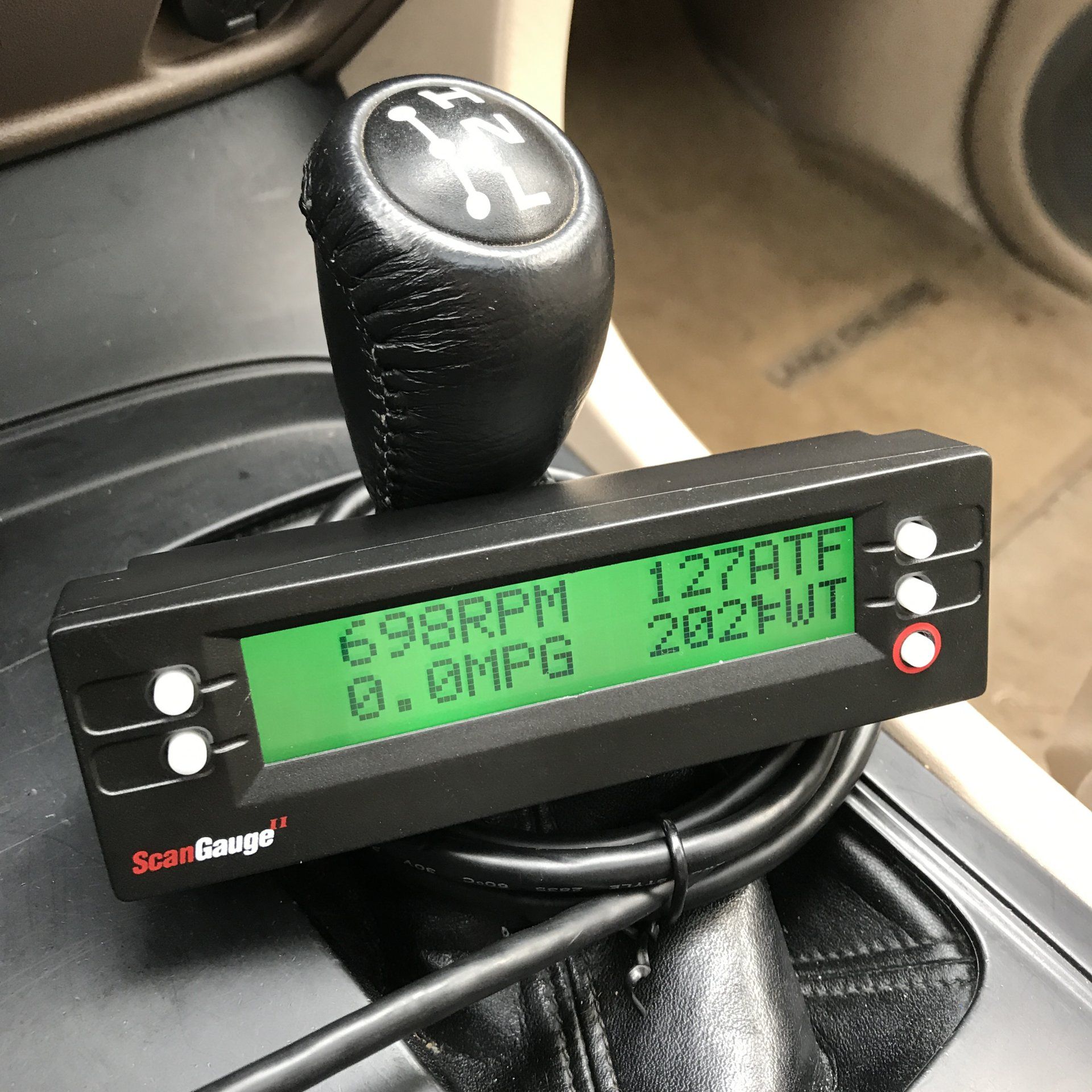

Ooooh, this is fun...
Overheating?
Not while I'm idling in my driveway :). Seriously, just set it up... gotta find me a hill to conquer.
For reference, ScanGauge transmission temp setup codes for my '98 LC:
TXD – 686AF101B4
RXF – 044105B40000
RXD – 2808
MTH – 00090005FFD8
