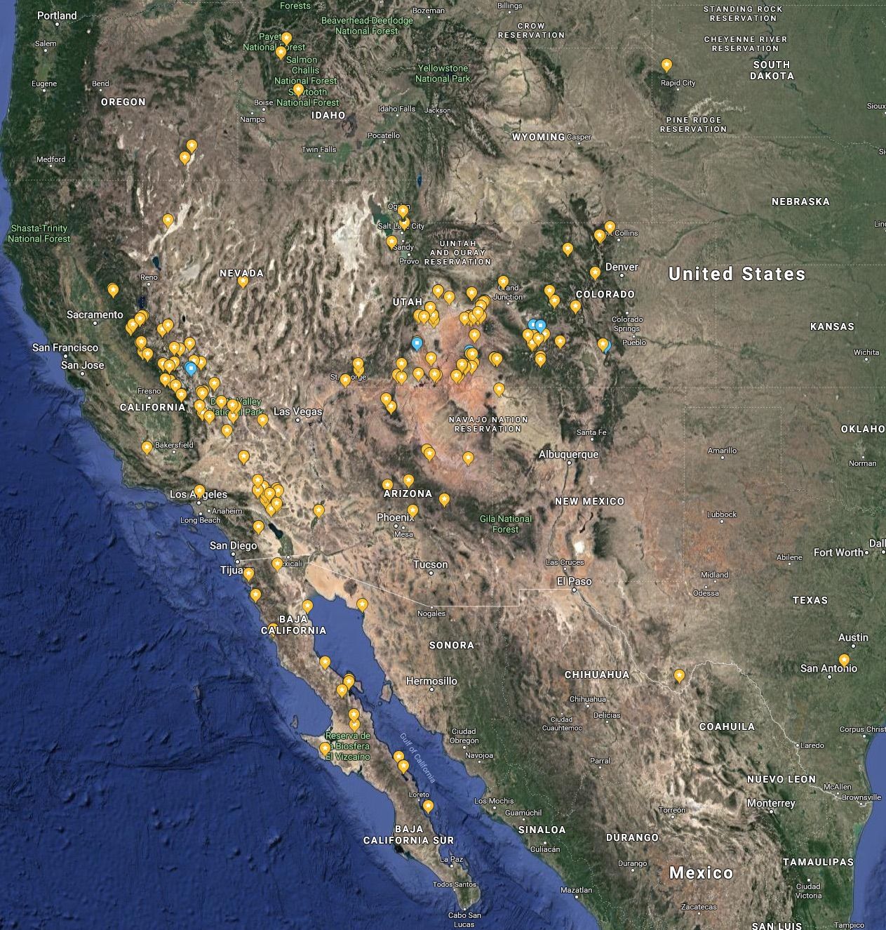

I just added it to my map. Anytime I see a cool photo or trail I try to find it on google maps and pin it. Here is my current collection, I've been to some of the stars, but not enough:
