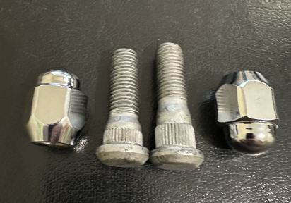

Yes they can be replaced. M12 x 1.5 thread. Heaps common as aftermarket studs at auto parts stores. You need to remove the hub to replace them with a press (or using brute force via a lump hammer if not broken off) unless someone knows of a special tool to force them out.
There appears to be different pn's for the front studs compared to the back. Not sure what the difference is as the thread spec is the same for all wheel studs.
90942-02049 for front hubs
90942-02052 for rear hubs (on 80's with full-floating axles).
Touch wood I've only ever had one break (with a bang, doing a hard turn in a carpark). If the nuts are not over-tightened and all are torqued equally they should be good.
front on the left and rear on the right
