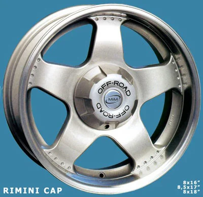

Conservative MIM Rimini Offroad. Good Italian wheel.

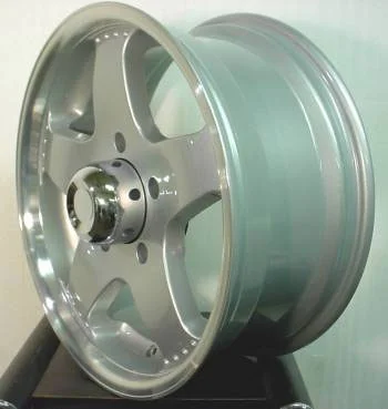

A little out there, but sort of stock looking is the ATS Cetus. Good German wheel.

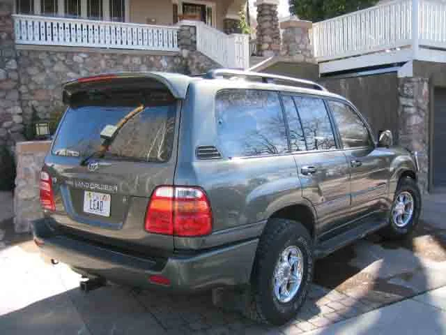

You can also keep your wheels and run BFG 285/75/16 which will be a 33 in. tire and looks good on the truck.
I guess I got lucky finding them but here is what I have.
