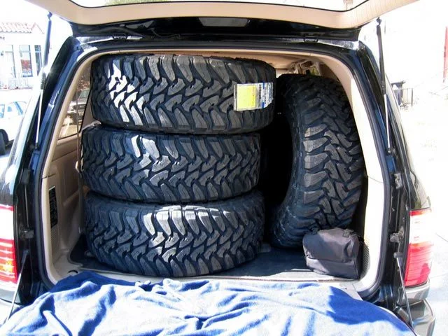

I've been waiting months for these bad boys! They are at the shop getting mounted and balanced on a GSP9700 as we speak! They are Toyo M/T's in 35x12.5-18s. Gotta finish installing my diff drop bracket now...

hoser said:I've been waiting months for these bad boys! They are at the shop getting mounted and balanced on a GSP9700 as we speak! They are Toyo M/T's in 35x12.5-18s. Gotta finish installing my diff drop bracket now...

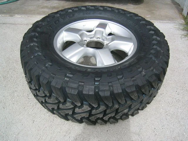

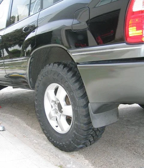

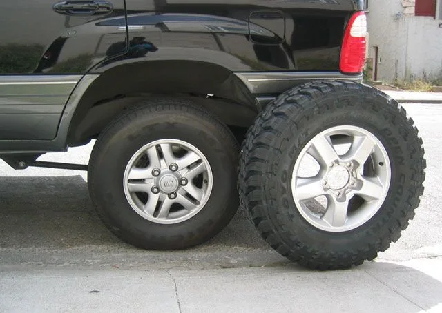

As for the tires, I picked them up from the shop and test fitted one of the front tires. As I suspected, the tire hits the upper ball joint by about 1/2". I have some spacers on order. So as soon as those come in, I'll snap some pictures.
The tires weigh in at 81lbs each plus the rim... so the whole wheel is over 100lbs each. All the Toyos balanced with no more than 3.5oz One tire took only 1.5oz.

I am not too sure if the spacer is need in this case, the tire wall is 1/8" from the upper arm.

I'll post some pictures tomorrow. The nice thing is they measure a true 35". The 12.5" width offers plenty of rim protection.mthomp6 said:Hey Jay-
