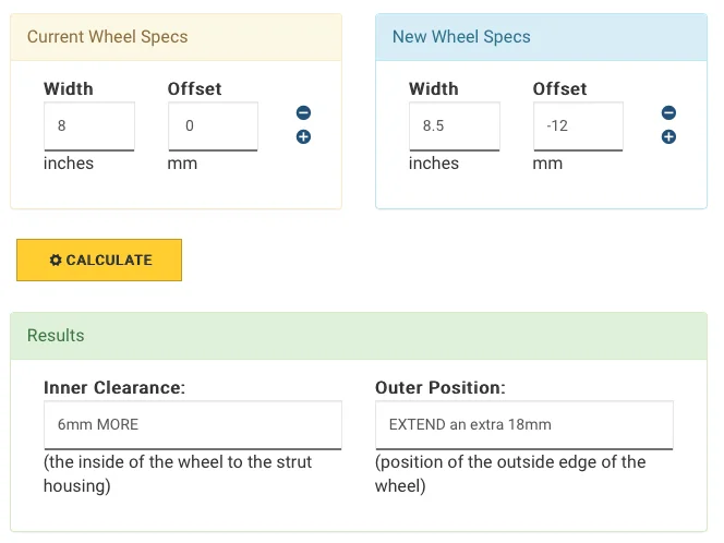

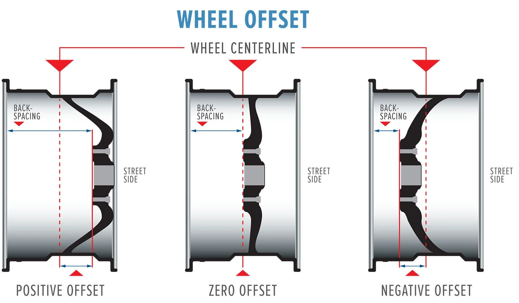

I need some help on picking a wheel size. Method as a 17x8.5 with 0MM/4.75 back spacing, which I understand is factory for our 80's. However they also have a 17x9 with -38mm/3.5 backspacing. Does this pushing the wheel out further or pull it in? Which offsets preferable?

a good way to sort out options.... but be sure to factor that offset also affects scrub radius, and that could cause rubbing on turning on the body mount or front fender / control arm etc....

Incorrect. Factory backspace is 4.5 inches. I would not go any further in than that.
If you will run 37’s, go with the 3.5 back spaced 9” a wheel. I run 37x12.5 trXUs which have a slightly narrower tread area than most 12.5’s and I had to use a 1” wheel spacer with stock 8” wheels in order to maintain decent up travel keeping the tires farther from the inner wheel wells and also to retain turning radius because the tires would otherwise contact the front control arms.
