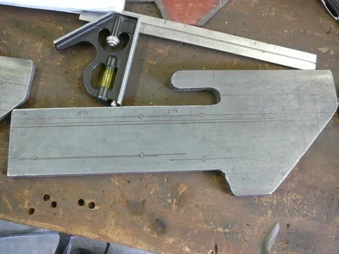

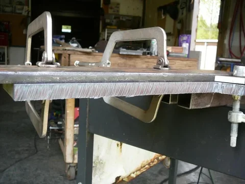

I got myself a Hypertherm 45 plasma cutter. I haven't had this much fun since I got my drivers licence! I'm designing and fabricating a bumper for my 60, hope to offer it to people when I'm done. But *******, this thing is so much fun!! P1020841.webp :eek:
It runs through 1/2" like butter, this is the first time I've ever used one. I'm getting better now. There are a few more pics of what I'm doing over on VI Cruisers on the club page.
