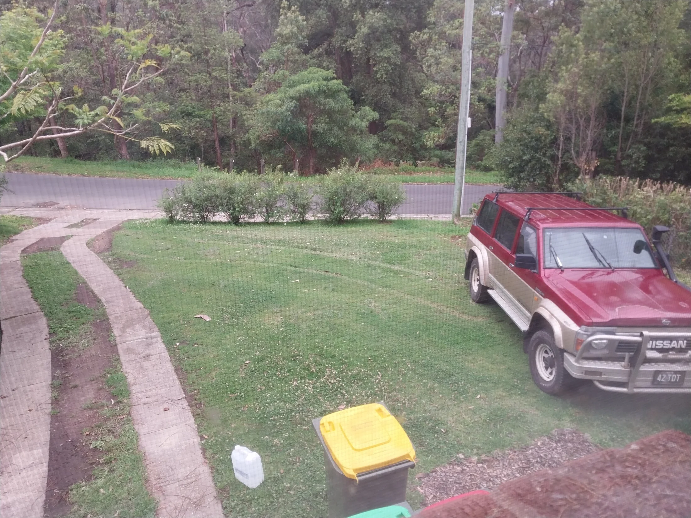

My Patrol is part time, after a rain it's impossible to park it in my usual spot, same happened with my part time 80 on MT's. Check the grass.
