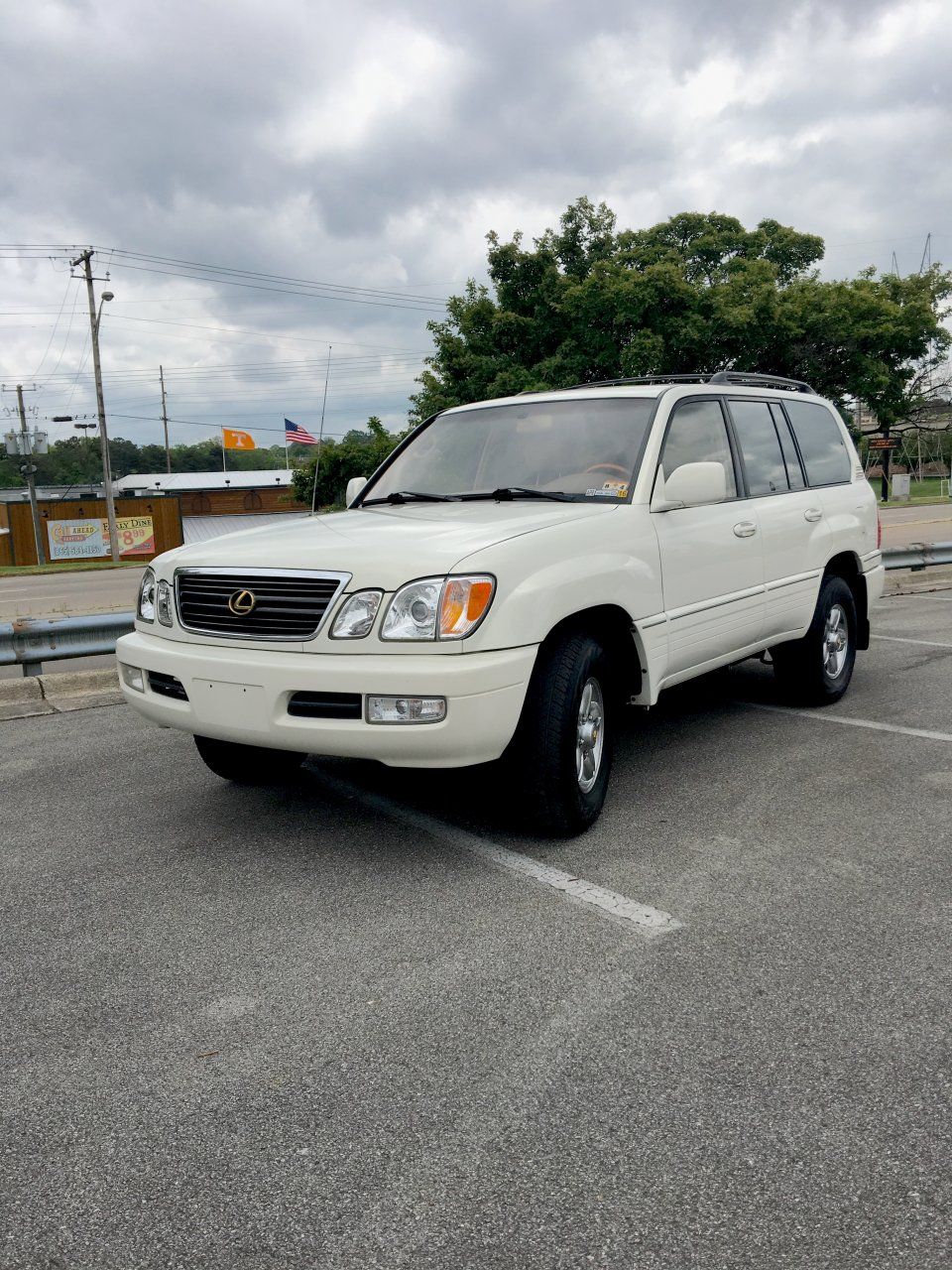

For me it was easy. Find the best deal for the money!! I would rather have a Lexus. Just my preference. The year to me did not matter!! Yeah, it would have been nice to find a 98-99. But I found a Texas rig, bone stock, LX, with under 170k, for 10k. And it is in immaculate shape for the money. Tires,lift,lockers,armor etc to come soon!!
