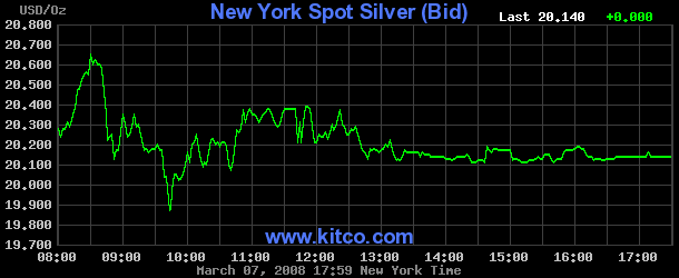

Buy 300 oz of silver.
Sell it in a year when the price doubles.
