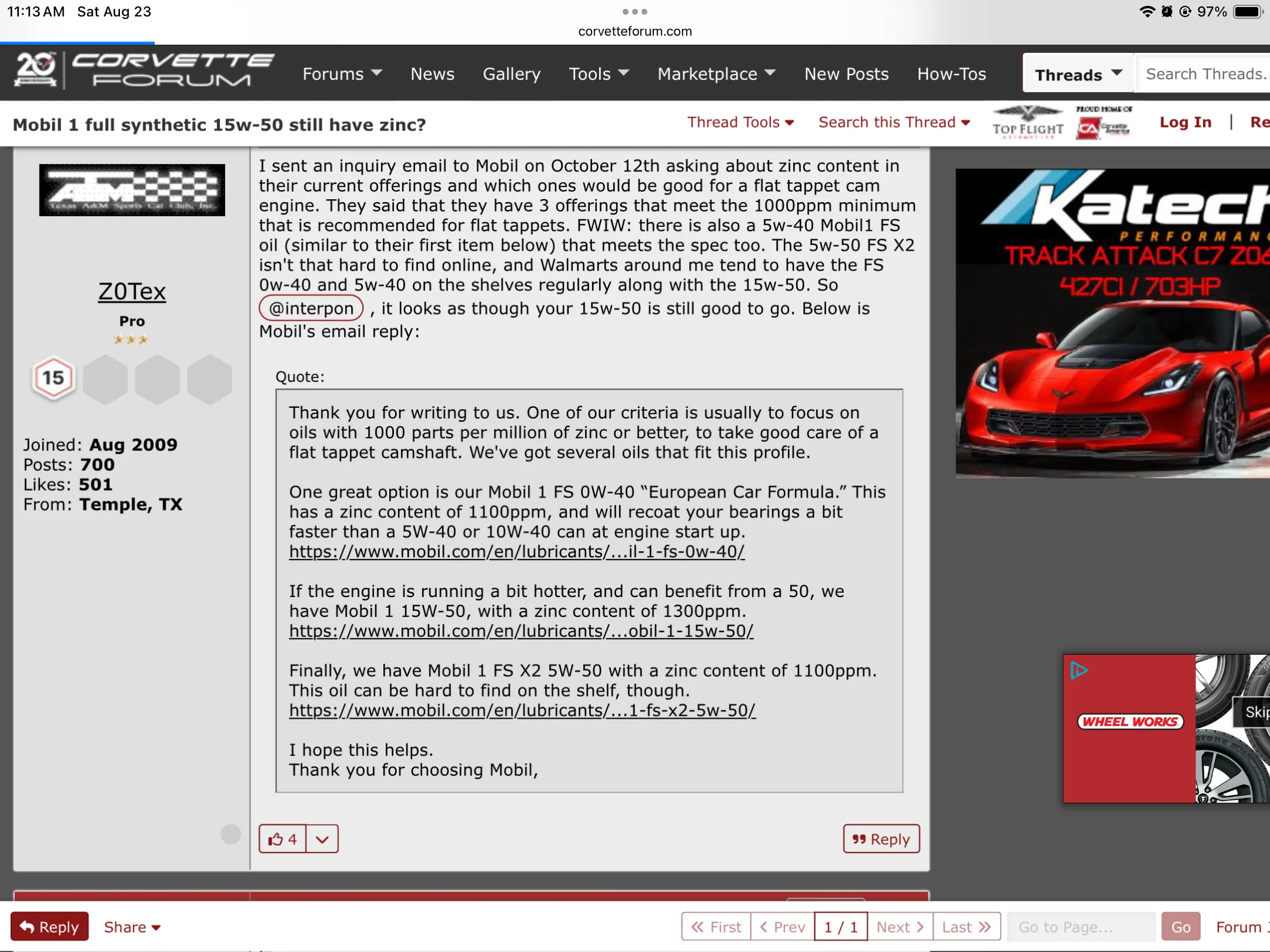

On another forum someone posted a response directly from Mobil regarding their zinc content of their 15w-50. This was posted in 2021…Mobil says 1300 ppm. Just an FYI.
