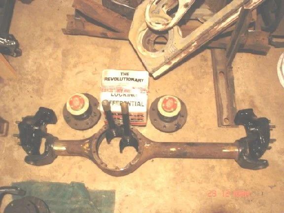

BINGO! I got the ends pounded on, located a diff drain, just gotta wait for TechTim at ARB to return my phone calls for my rebroached ARB side gears. Got the 4.88's & inner/outer shafts but still need to get the inner seal worked out. Here's a really old pic of the project:

looks beefy, did you make your axle like Woody's "super toyota axle?" The one Nolan talked about in the TT.
Rezarf <><
No way! I'm not putting more $$$ into a birfield equipped front axle unless it's those monsta D60 birfs Bobby Long sells. This one is 35 spline D60 outers & 35 spline inners w/ a rebroached 35 spline LC ARB RD33.
