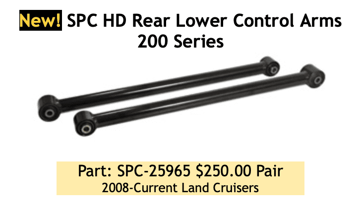

What's the product number of the SPC rear lower control arms? Haven't heard of them before.
They are black...but I suppose you could powder coat them if you first emptied the ends of all fittings so they aren't destroyed during powder-coat baking...
Personally, I'd suggest just painting them if you don't like black...
Paint is quick, easy to apply and easy to touch up.
(Screen grab from sleeoffroad.com)

Thanks for the share on the rear LCA’s, haven’t seen those before. Do 200’s also benefit from adjustable rear panhard rods after a lift?
