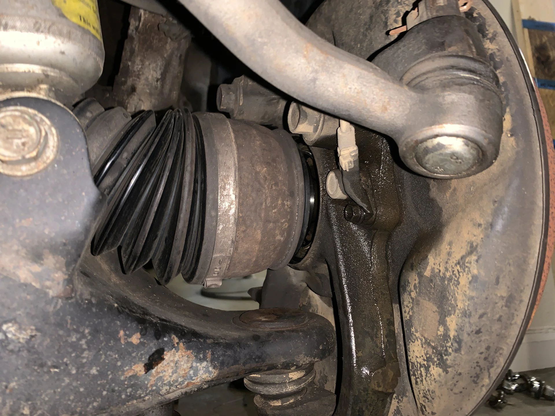

Get the kits(wheel bearing and shim) from cruiseroutfitters. Good to have on hand. Also check out the FDS(cv) splines and how they look. Do you feel play or a clunk yet?
There’s always the whole of what to do, with 192k on my 03. My next big thing would be uppers and lowers, which would also tilt me towards replacing my FDS and keeping the old ones to reboot for a spare. Most of those bushings are toast just by age.

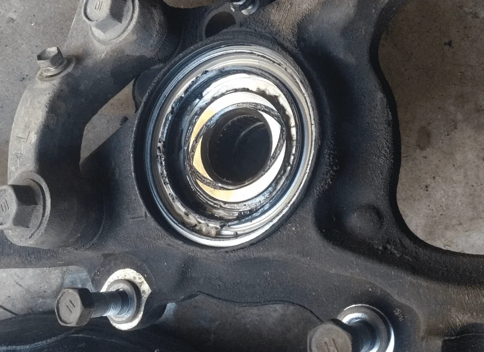

I'd likely get a set of c clips for the flange when pulling out the CV (also Cruiserteq/ cruiseroutfitters) as well as a brass punch for the races.
I've kept reading up on this job and I see why these are necessary - looks like which thickness C-clip is necessary depends on how far "down" the 54mm nuts go when you torque them correctly.
re: the races - if I don't have a press, am I going to be unable to install a new bearing race? That part wasn't clear, since ChowCares copped out in the video he made about the job and just left the old race in there.
The c clip shouldn't be impacted by 54 mm bearing nuts. The 54mm nuts provide pre-load on the hub bearings which ride the spindle. The 2nd nut locks in the star washer (with tabs folded) and the first 54mm nut.
The c clips ensure a properly installed front drive axle. If the c clip is too small, it allows side to side play in the drive flange and back of the knuckle. Different c clips allow you to obtain proper tolerance between the end of the drive axle and the flange. Too much play results in excessive wear to flange, drive axle and brass bushings.
Yes you can install races without a press. Use the old races to tap in the new races (cut slit in old races so they don't get stuck)
When I refreshed my lower control arms I couldn't get the ball joint in as it was always sliding/ tilting away. Drop it off at a shop, they pressed it in $30, good to go...
Or perhaps there's someone in your neighbor hood or a member of the forum close by who could help. Shouldn't be a big deal. Just watch out not to destroy the surfaces when you knock out the old ones. take your time.
