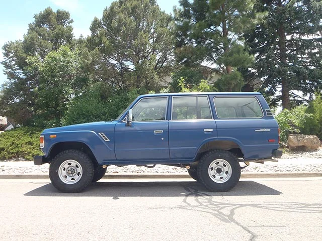

The one in my photo was my 78FJ55. Clean as a whistle and less than 70k miles. Sold it for $5500 in 1990. Shouldn’t have done that.
