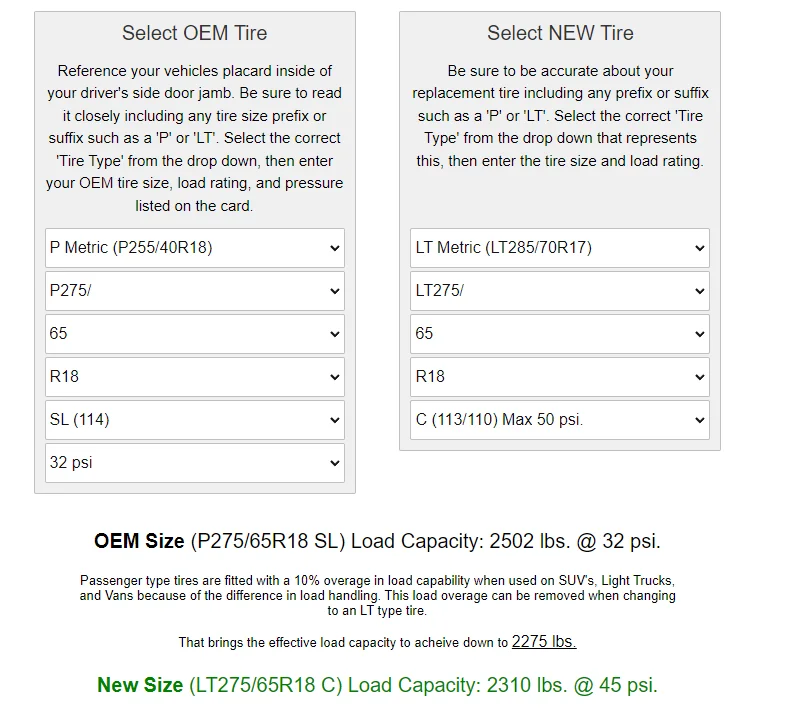

your door sticker provides info about the tire pressure at max load (and perhaps also with reduced load, not sure...).
But you can put the stock tire size/ rating/ pressure into this tool, put your new setting in there and then it let's you know what you should do (again: for max load)

@ouzo12 Instead of listening to my uneducated opinion and everyone's random guesses, click the link below ** I see GerLC100 also tagged this tool. It's very useful
Enter your stock tire size and rating in the left part. Then enter your new tire size and rating in the right. Every tire range has a specific load rating and pressures relating to it. That tool will take your GVWR and figure out what your new LT tire should be run at to accomplish the same thing.

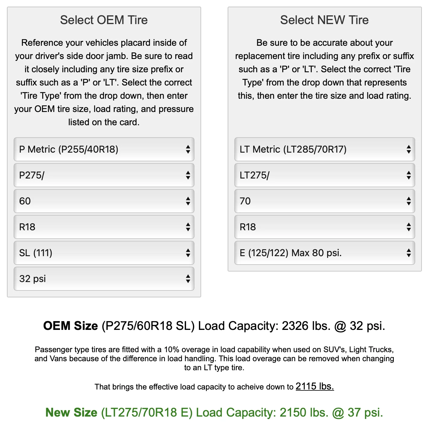

I played with that site/calculator... came away more confused. I'm going to assume I did something wrong here or all I thought I knew about tires was wrong. School me.
Why is the load rating for the E-rated tire 176 lbs. lower than the SL-rated tire? And obviously related to the first question, why does an E-rated tire need MORE psi than an SL-rated tire.

.... Why is the load rating for the E-rated tire 176 lbs. lower than the SL-rated tire? ....
Because the load capacity of a P-rated tire is de-rated by 10% when used on a light truck or SUV, as mandated by (IIRC) DOT.
The calculator takes that into consideration when factoring the equivalent load of an LT tire.
Your using the tool right but overthinking it slightly. That tool is using load ratings based on size to spit out a pressure to allow the same GVWR as your stock tire and is just a good reference point rather than opinion
An E-rated tire needs more pressure than an SL to achieve to same load capacity so if you run it at 32 PSI you have far less load capacity than stock SL tire
I do agree it's sort of weird that they show a slightly lower capacity rating when converting to E rated and I've got no explanation for that BUT the key take away is you know to achieve a similar load capacity as SL but with an E rated you need at least 37 PSI
