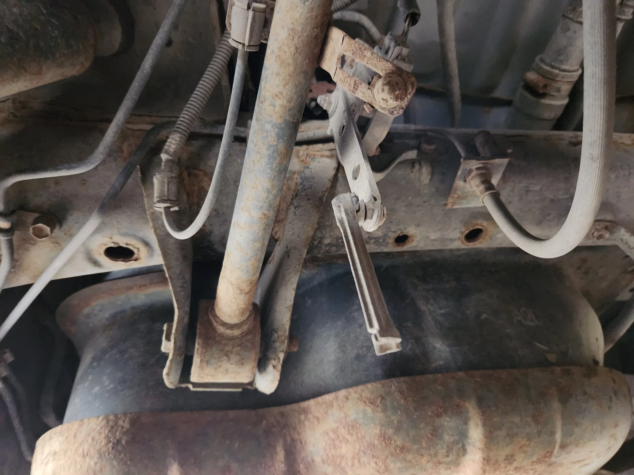

New to the forum and still getting a handle on my new-to-me 2001 LX 470. It has relatively low mileage but clearly had a bit of neglect from previous owners, so going through the punch list to clean things up. The other day I was poking around and spotted this:
This is directly in front of the rear axle, looking towards the fuel tank. This lever (?) appears to have been sheared off at its connection point. What am I looking at here? Doesn't look like a hard fix, but have to know what I'm working with first :)
Thanks in advance
Hmm, doesn't look OEM but I have a LC not LX so I could be wrong.
Can you tell where it broke from?
I'll check later today. Couldn't find it on parts diagram but will look around.
LC so LX may be different.

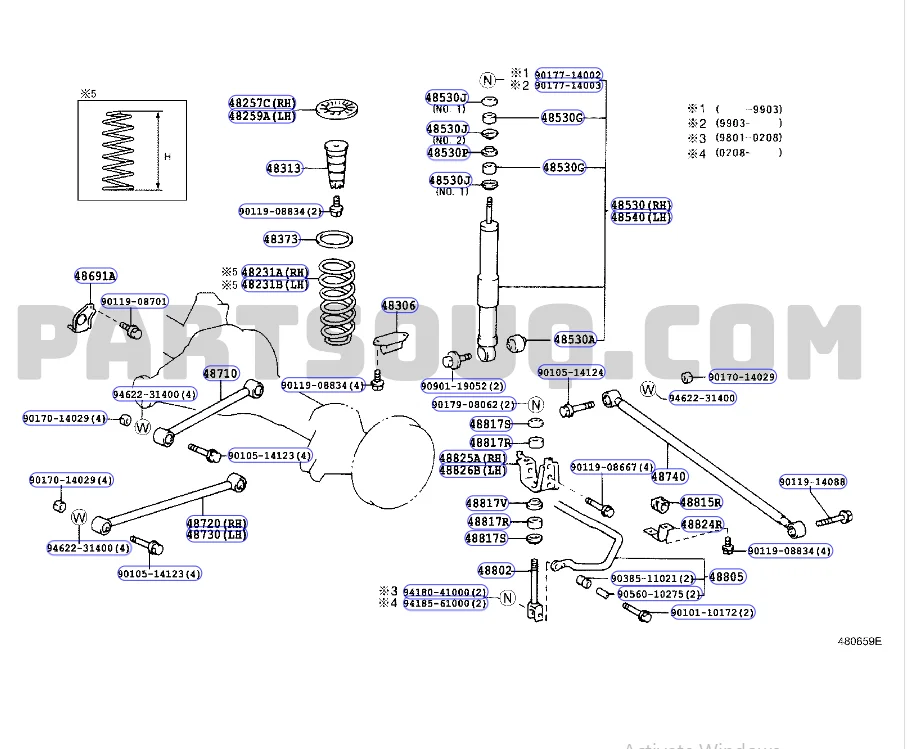

Height Sensor for AHC.
4890660010
LINK SUB-ASSY, HEIGHT CONTROL SENSOR, REAR
$38.57
Confirm... height sensor
