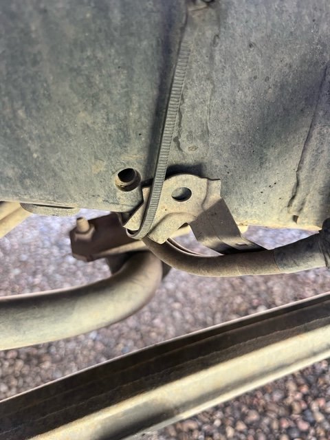

I guess the bolt is missing from this bracket, looks like the PO used a zip tie to hold it and some cables on. Can someone tell me what it is and what I am missing.

It looks like you may have a body lift or at the very least a suspension lift. Can the bracket be pushed over far enough to reach if you do place a new bolt in it?

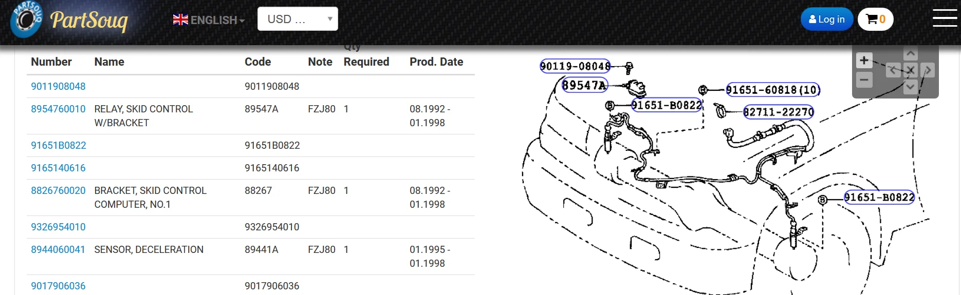

The bolt you're missing is 91651-B0822. It's a hex bolt with lock and flat washer. The bracket is for the ABS circuit harness.

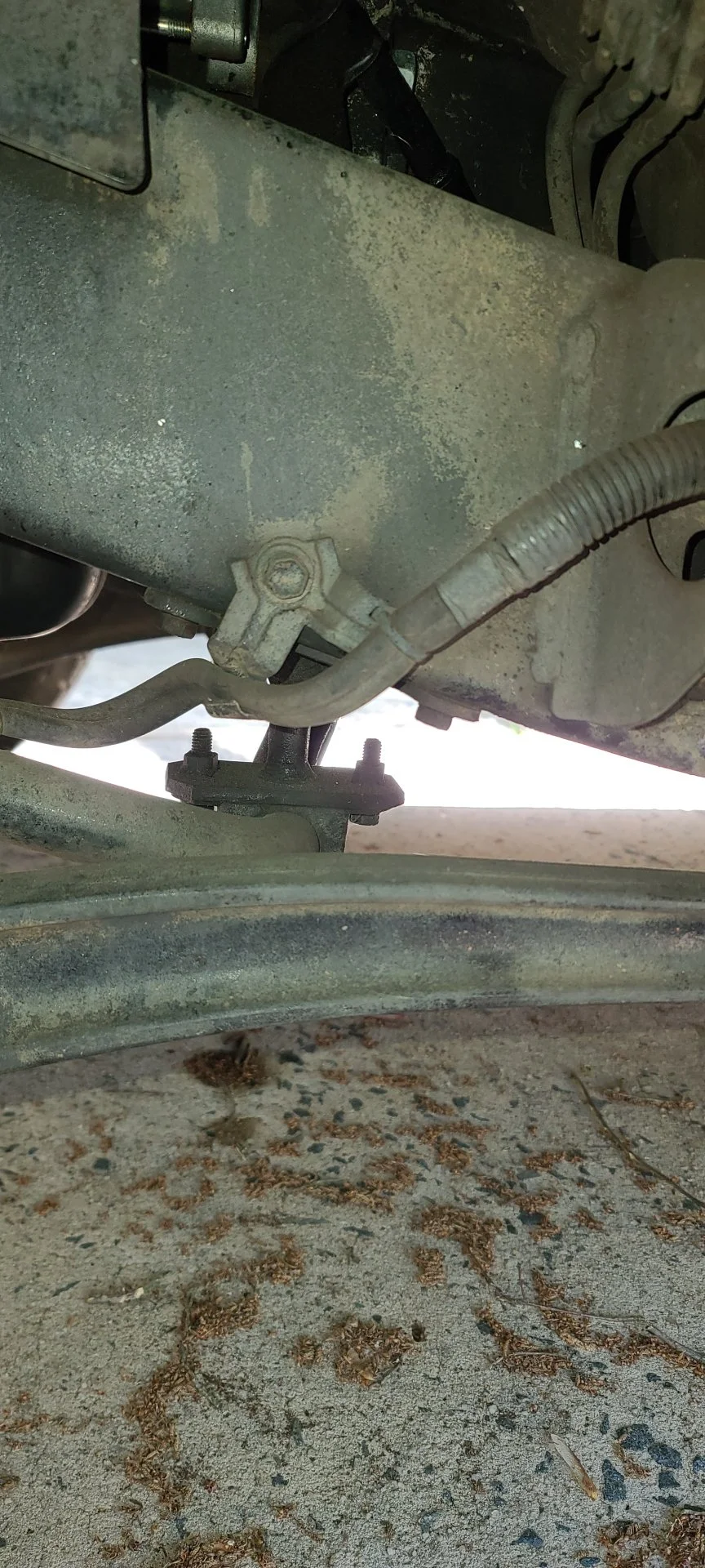

Installed, it looks like this:

Thanks guys, appreciate the pic and part number (!!!), I have updated my signature.
