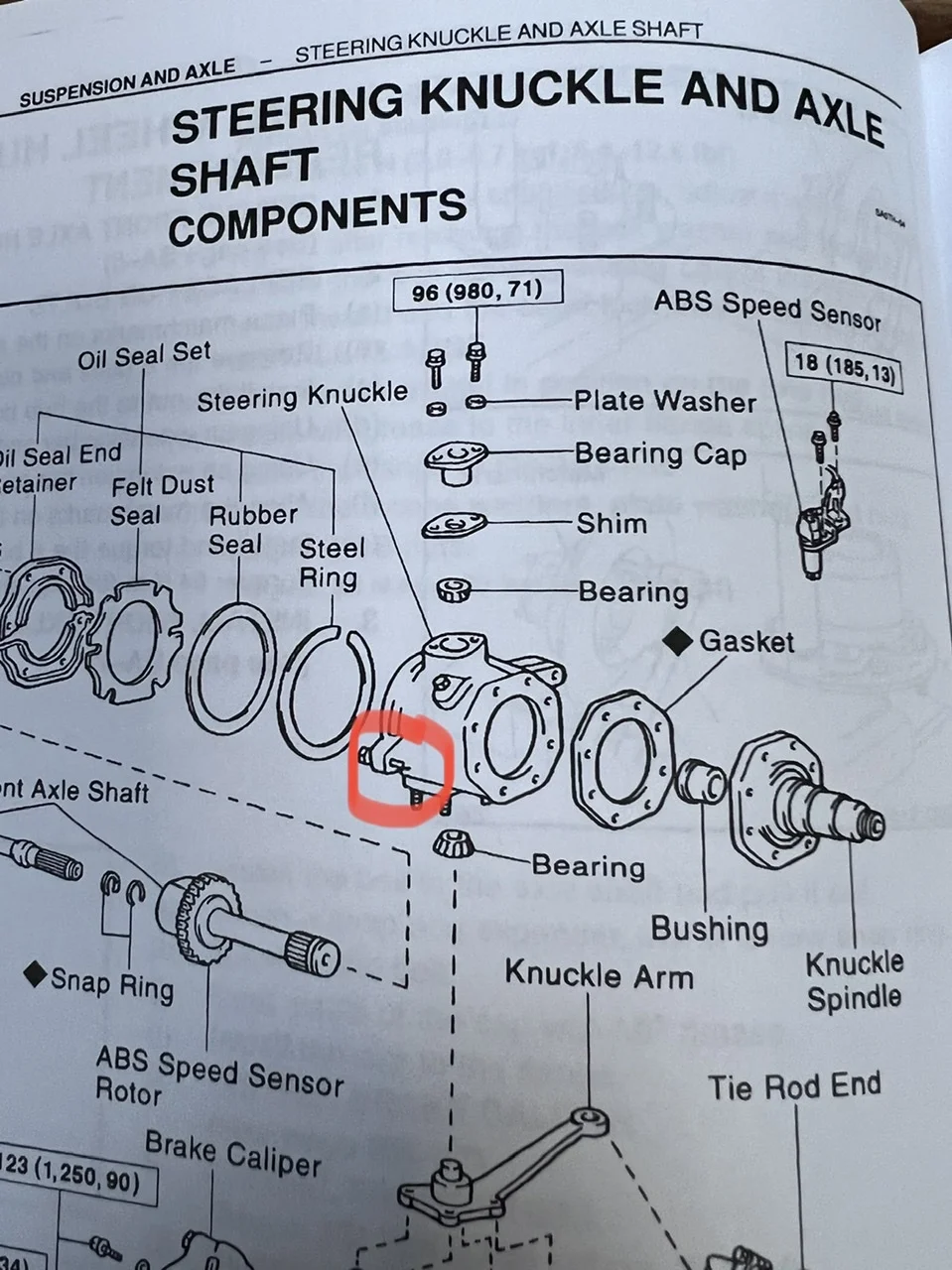

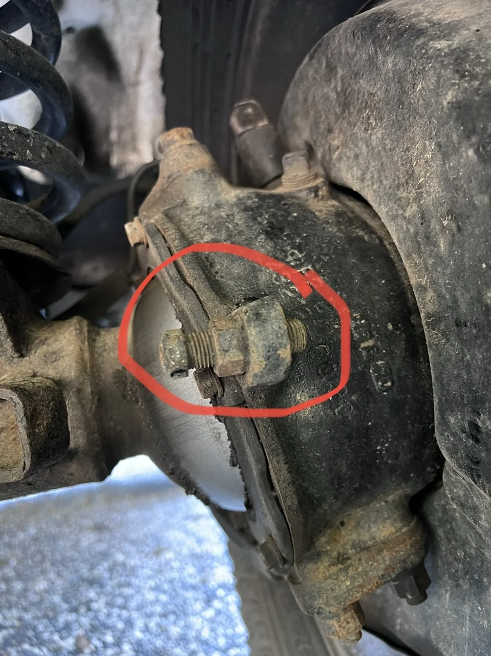

It doesn’t seem to hold any parts together.
Looks like this might be the same bolt in the FSM

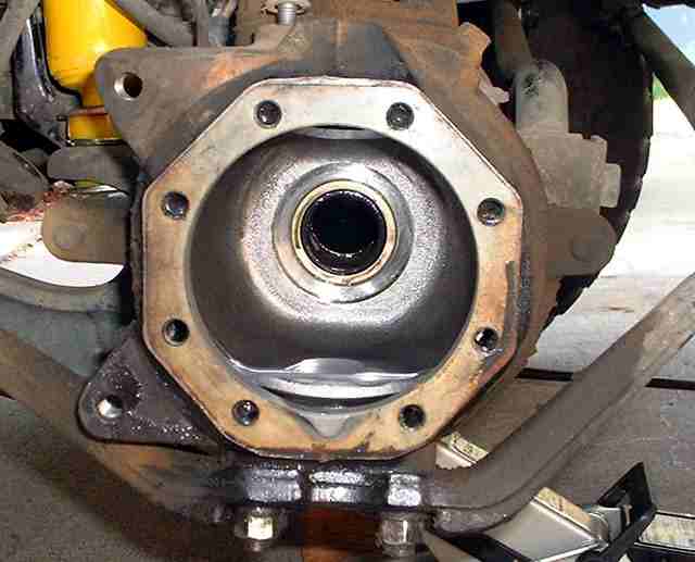

^ yep, you can see them both in the following picture, or at least the bolt thread ends of them. At 3 and 9 o'clock.
cheers,
george.
If you are going to drift your rig you need to adjust them for maximum angle. Not a lot of people drift 80s though so get that 1fzfe tuned and show us some video!

Tools always told me if you max out the steering angle it would stress the birfs. Suppose there is instruction in the FSM?
I’ll take another look at the steering section of the FSM. I am curious to know what Mr T suggests for the length of exposed threads on the wheel side.
