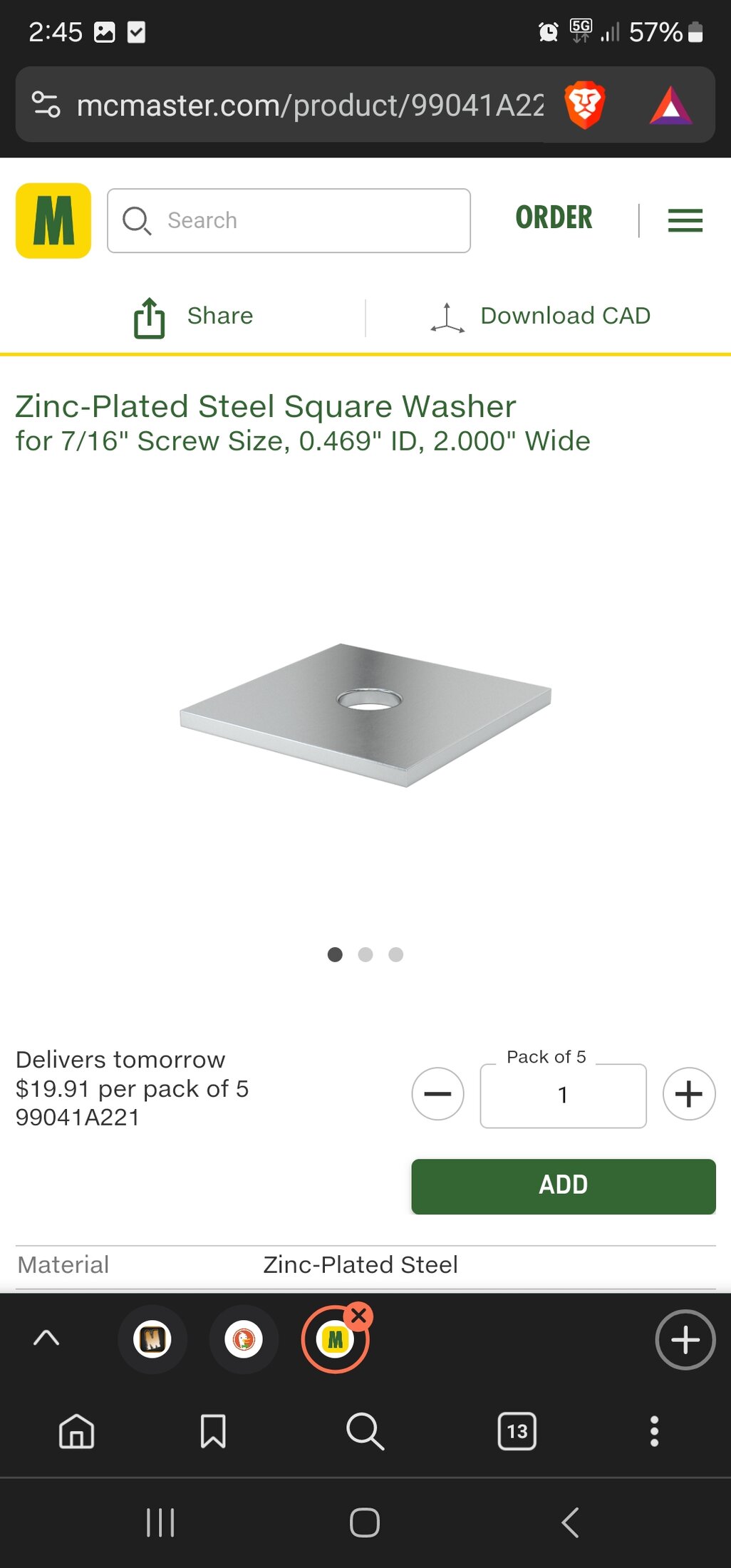

None of my damn business, but if it was me, in that situation, I'd absolutely add a plate to the other side of the floor. Minimally a nut plate like is used for seatbelt harness anchors, larger area if possible.
Sh¡t stirring aside, even adding some structural, square washers under and over the floorpan to sandwich it between two structural washers to prevent bolts tearing out in an accident would be a big improvement.
Still, not awesome, but an improvement.
Something like below. A tiny cost for some improved safety.
That is a great recommendation. I will do that.
