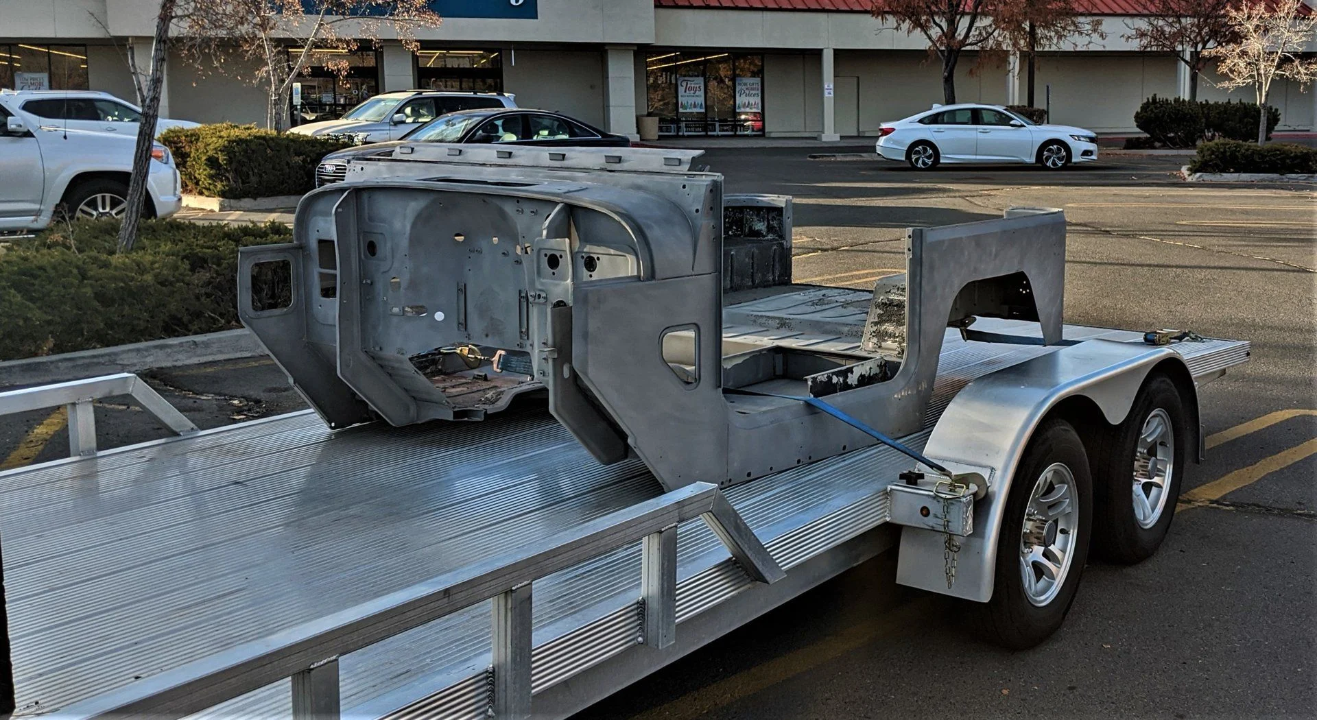

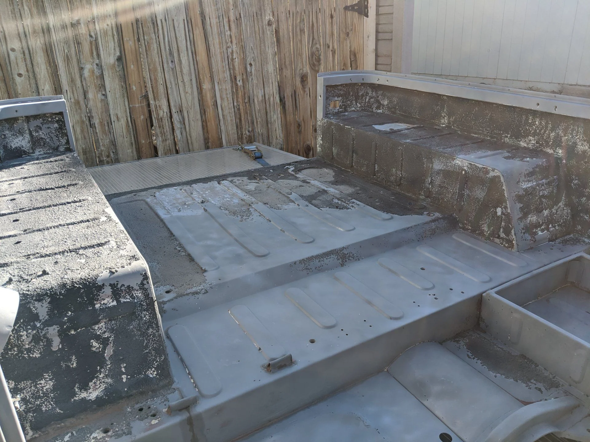

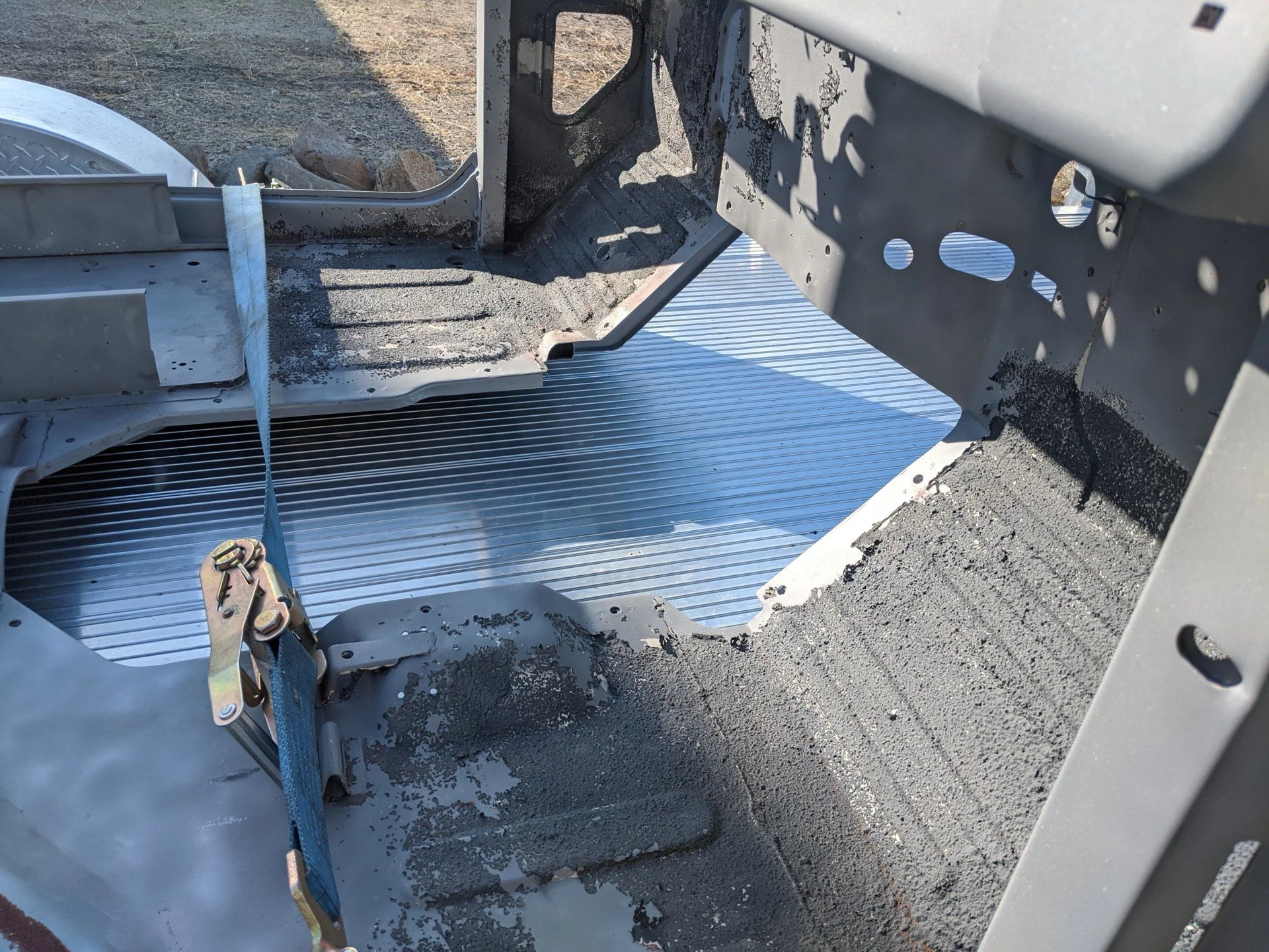

I got my tub back from the media blaster... I flippin hate bedliner! I'll be putting in some elbow grease to get the rest of this out. I am tempted to haul it up to Oregon to have the dang thing acid dipped...
On the upside, my welding work doesn't look too bad for the first attempt. there's a few rough spots I'll need to sort before laying down primer.

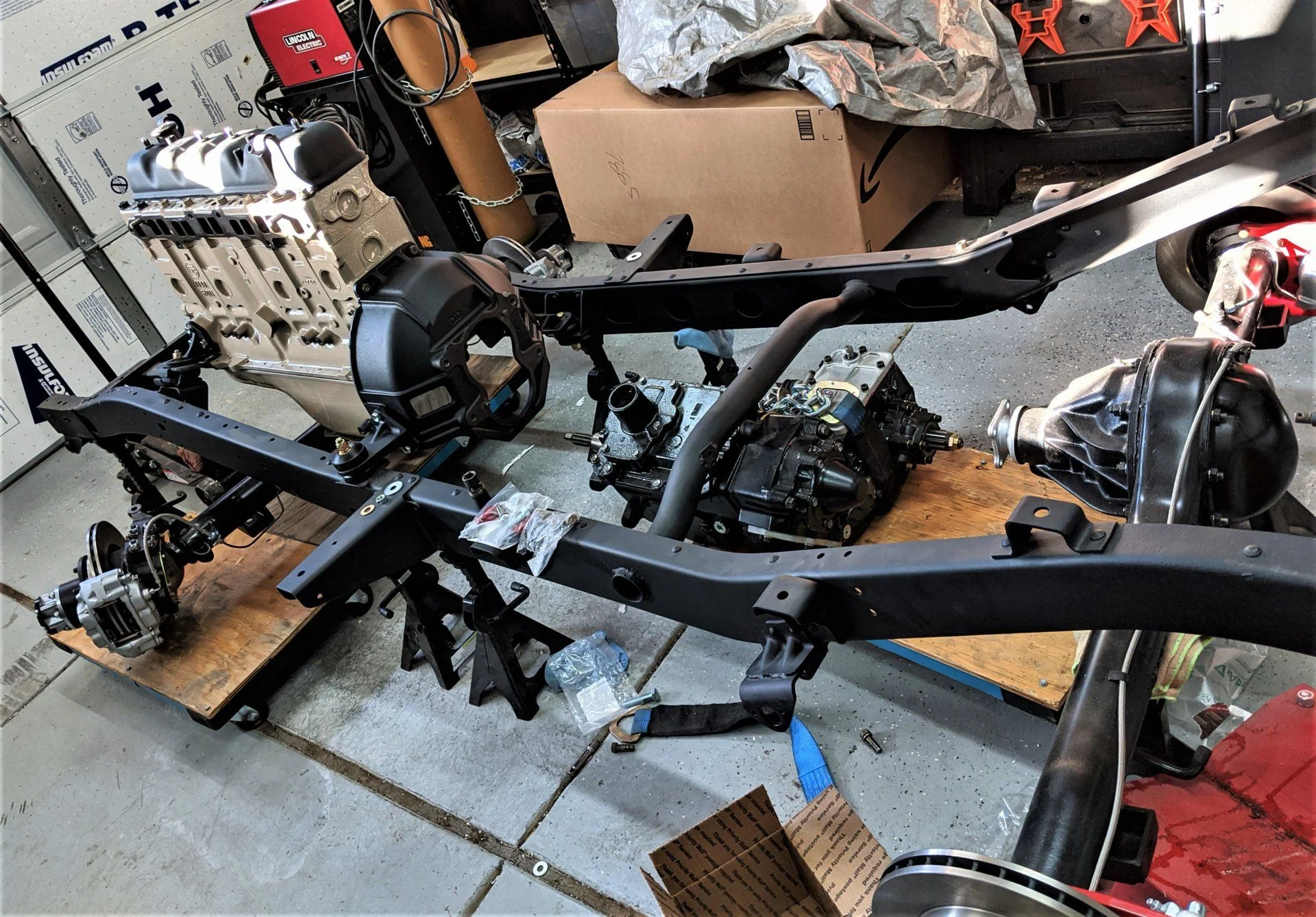

I also ordered my transmission mounts and hardware and dropped off some more stuff for powder. I hope to have the drive train mounted on the frame over the next few weekends.
What a pain with the bedliner. That stuff always seems great until you need to remove it. I would have thought the blasting would have taken care of that. So onto the grinder and stripper? The stuff on mine was so cheap that it doesn't stick. I can just peel it off when I want. Maybe that was a good thing.
Too bad man but at least your progressing. Two steps forward and a 1/2 step back.
What a pain with the bedliner. That stuff always seems great until you need to remove it. I would have thought the blasting would have taken care of that. So onto the grinder and stripper? The stuff on mine was so cheap that it doesn't stick. I can just peel it off when I want. Maybe that was a good thing. Too bad man but at least your progressing. Two steps forward and a 1/2 step back.
Yeah I will probably have a stripper party... not nearly as fun as it might sounds! ;) Four people and some needle scalers, flapper discs, and wire wheels will make quick work of it I think.
For now all my attention will be on assembling the rolling chassis. I'll revisit the tub in the spring since shooting primer and paint in the cold isn't ideal.
try dry ice on the beadliner, works great on undercoating...
I managed to get my motor mounted up today. I got so excited that I almost mounted my transmission without a clutch assembly! I'll be mounting up the springs and axle assemblies soonish.
I'm hoping to have a rolling chassis on all fours before Christmas.

Wow some really nice work you got going on Tony. That's exciting that the motor is in. I agree. Is there any way you can squeeze the tub in the garage away from the elements for the winter? Things are looking great though, keep it up.
Thanks. It is tarped on the trailer right now. I couldn't get it into my garage before the snow started. I'll pull it into the garage on Sunday before I leave for Detroit on Monday.
I am probably going to get it acid dipped to do away with any flash rust and a second attempt to get rid of that flippin bedliner. If it doesn't come off, I am going to spray 4 mils of lizardskin over it and call it a day.
MEK is great stuff to remove bedliner (what we used for overspray when I worked at a truck accessories shop) but that stuff IS NOT to be messed with, need full rubber gloves and respirator if you are going to use and have in well ventilated area. But it will make quick work of the bedliner... just wipe on and it will start to soften the bedliner to the point where you should be able to easily scrape up with a putty knife.
When we did truck beds, we would wipe on the overspray with a rag, give it a few and then wipe everything off with the clean rag.
