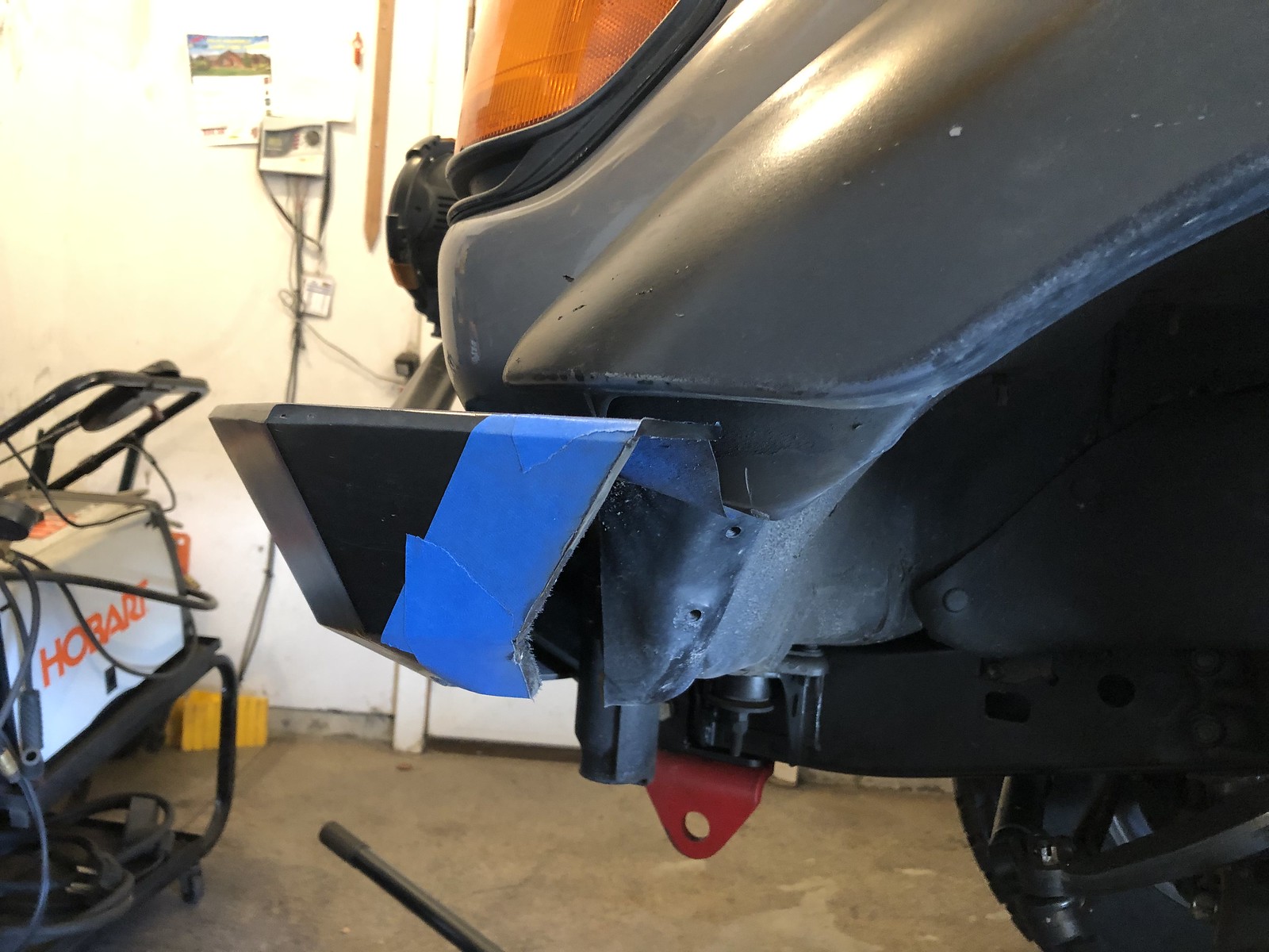

This is after cutting the front bumper wing. It was aligned with the back edge of the flare originally, so I removed ~2" from the wing.
80 mods by Adam Tolman, on Flickr

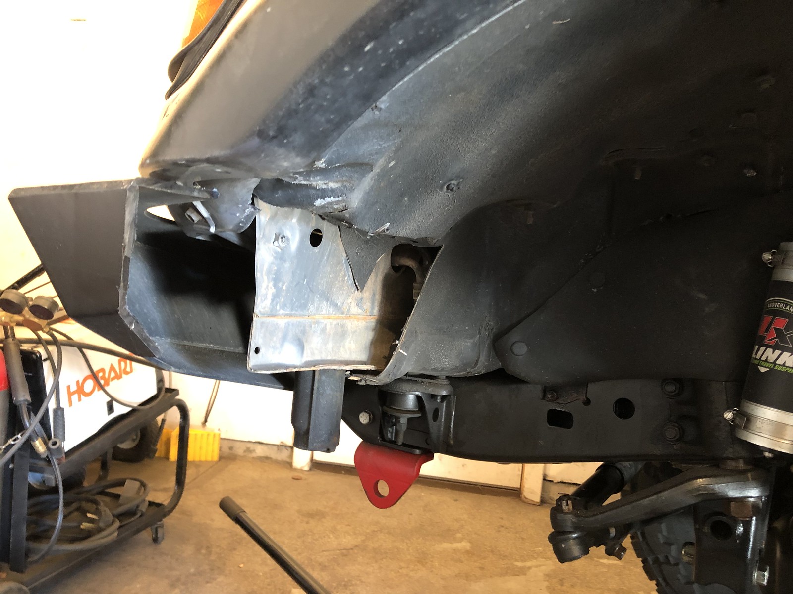

This shot shows the inner fender/core support area that was also contacting the tires.
First cut of inner fender.

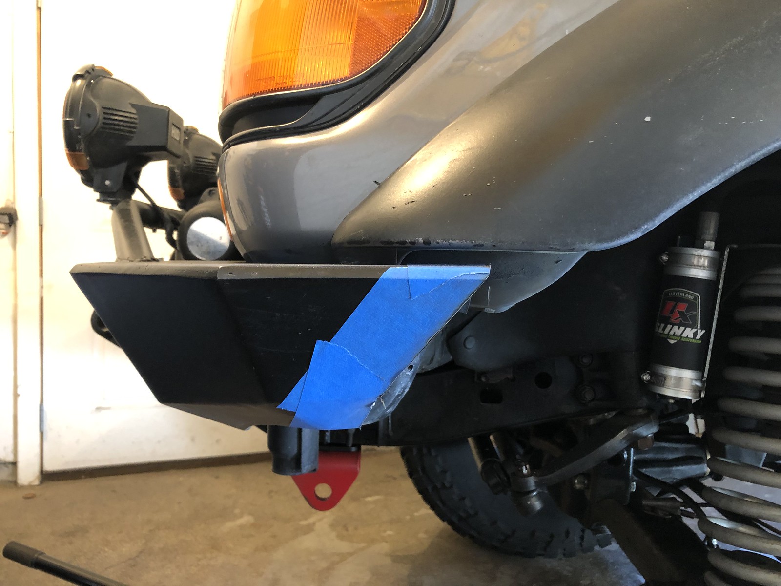

Cardboard Aided Design template to cap the bumper

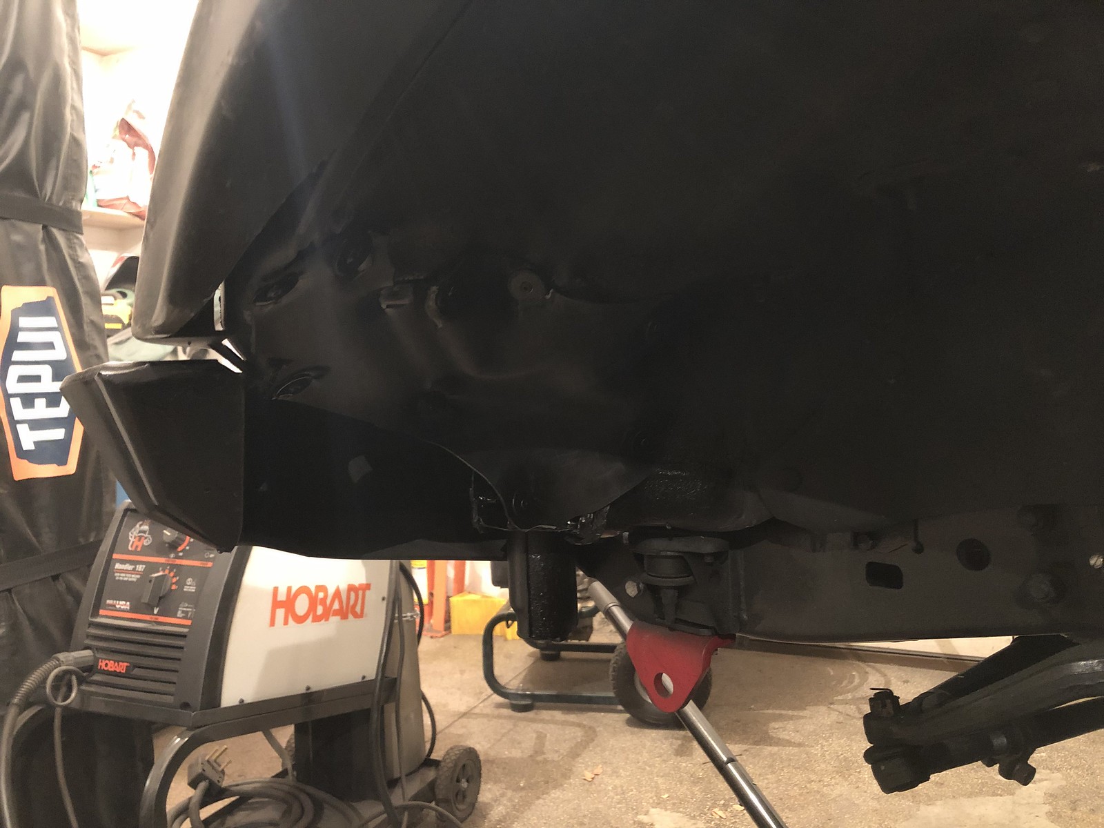

little hard to see in this pic but this is all finished up. "Custom" rubber inner fender liner secured in place to stop the tires from thowing mud etc into the cavity of the core support or inside the inner fender.

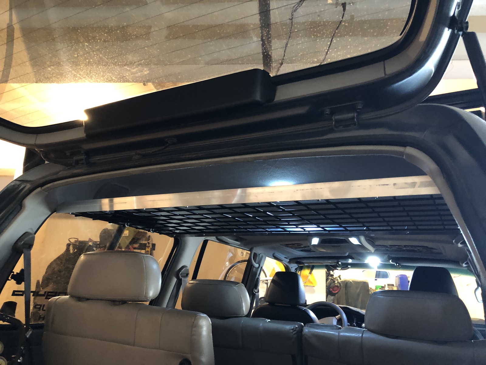

Also added an aluminum edge to the front and back of my attic rack to keep items from sliding off.
