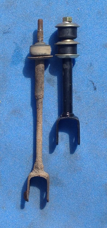

My 81 has always had a ton of body roll since I got it 2 years ago. It has a 2.5" OME lift and 315s.
While prepping it for a trip recently, my buddy said "geez, those rear swaybar links look mighty long..."
That's one of Cruiser Outfitters' 1" extended swaybar links for comparison...
Well I don't know what the heck kind of lift this truck may have had in a previous life but I guess it was big.
Massive improvement in drivability now. Still some body roll but much less, and it's predictable. Wish I'd figured this out a long time ago.
Thanks to Kurt @cruiseroutfit for the links!
