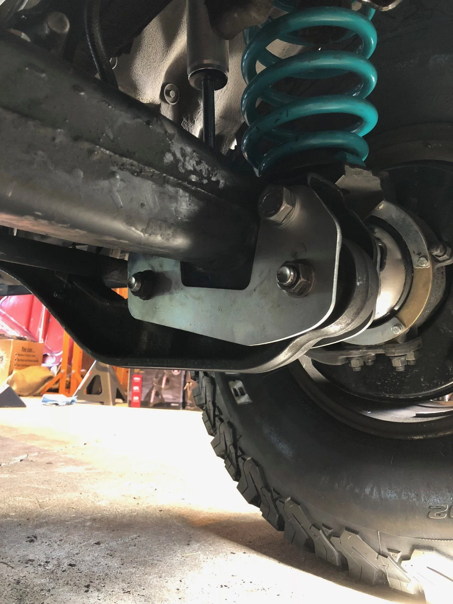

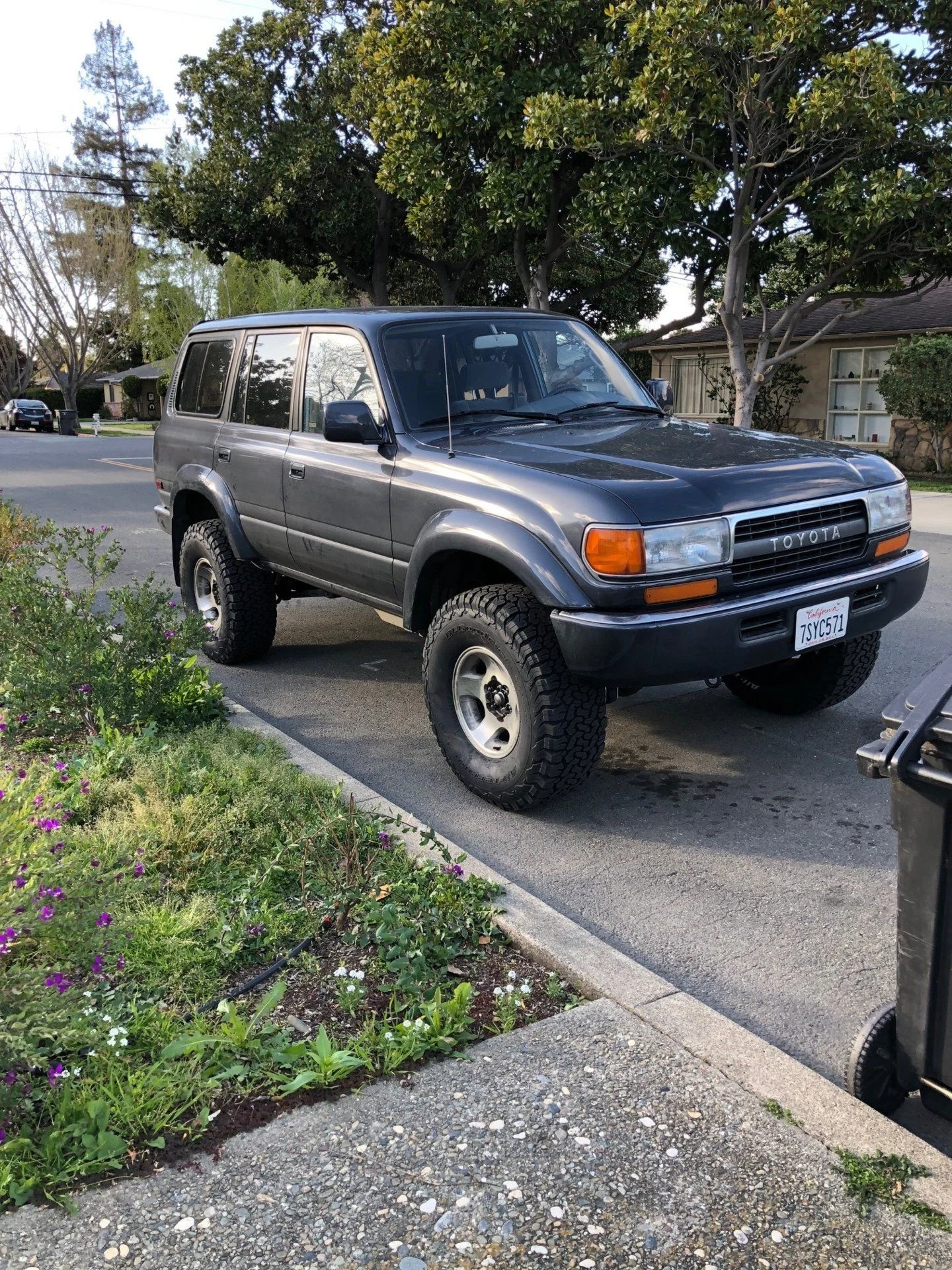

I (with help from a couple of good friends) finally installed the suspension and tires on my 94! Ive been staring at a pile of parts for a couple weeks now, while things have been busy at work. Dobinsons Flexi-coils and Panhard bars, Slee caster plates and brake lines, Fox IFP shocks and a fresh set of 315/75r16 KO2s. More to come, but I'm pretty happy with the progress...

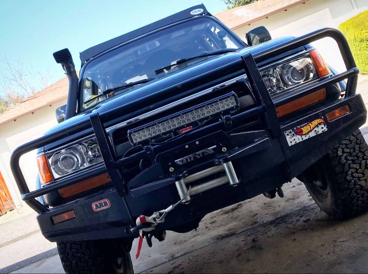

Hit a big puddle about 18” deep at about 30 mph. (Couldn’t avoid it)
Code 21. Hot O2 sensor. Probably wiring or something. Of course I was sick as a dog Sunday and today so haven’t been able to crawl under and check it out.
Pulled EFI fuse. It came right back on...

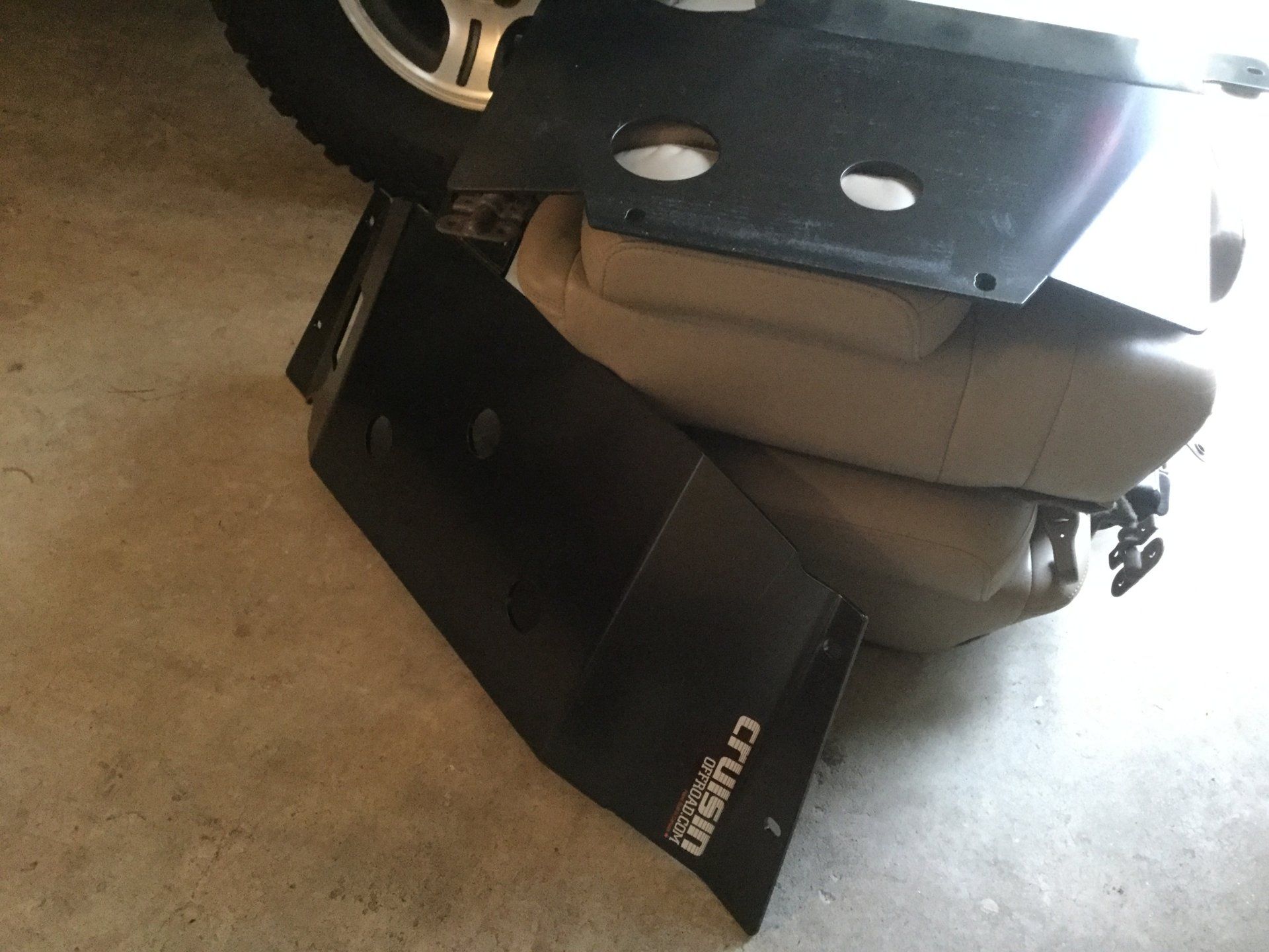

Cleaned off the old paint from the OEM skid plate using paint stripper.

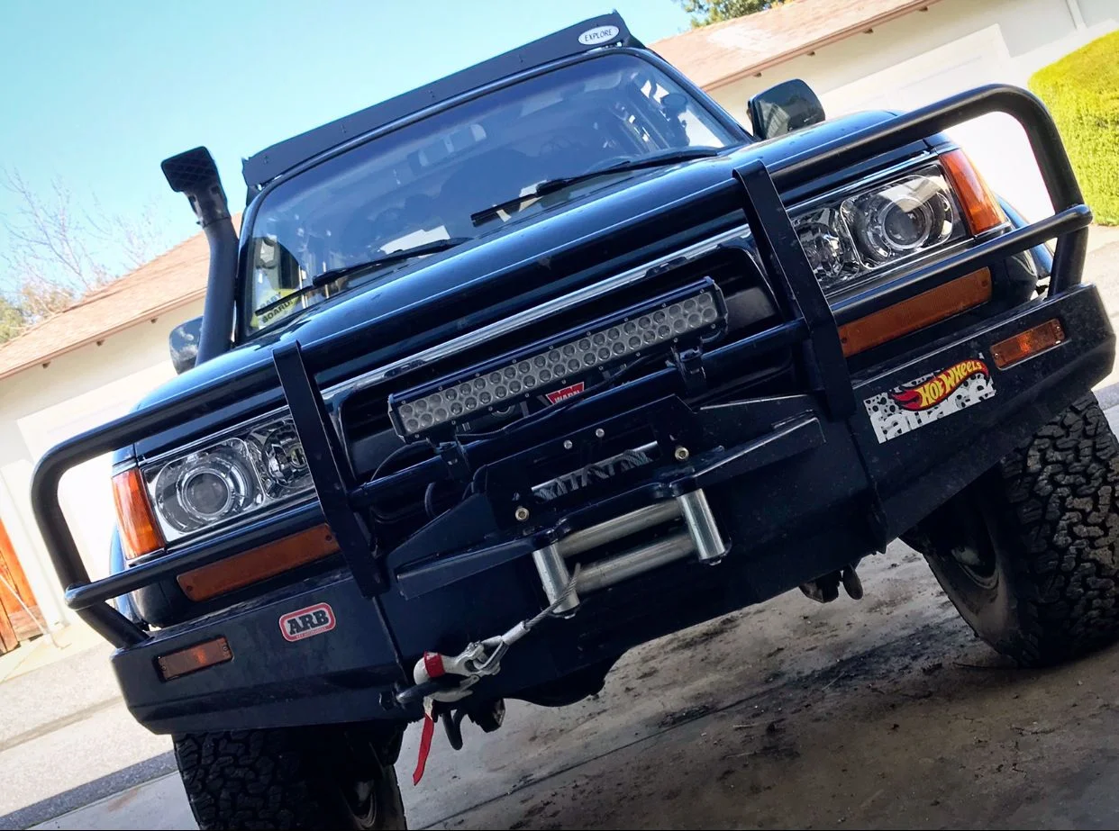

Are your o2's still in the factory location, low on the exhaust pipe ? I know on my 94 I had to move them because when it rained I would throw o2 codes. Pretty sure it was getting into the connectors. Put them where the PAIR system used to be and haven't had a code since.
Yep. That’s been the plan since I got it. Just haven’t gotten around to it...

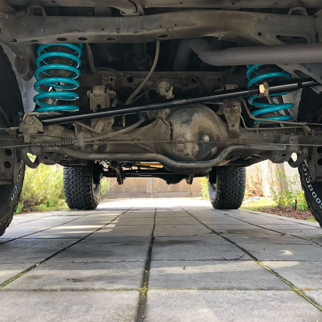

How do you like those panhard rods? Look really nice.
