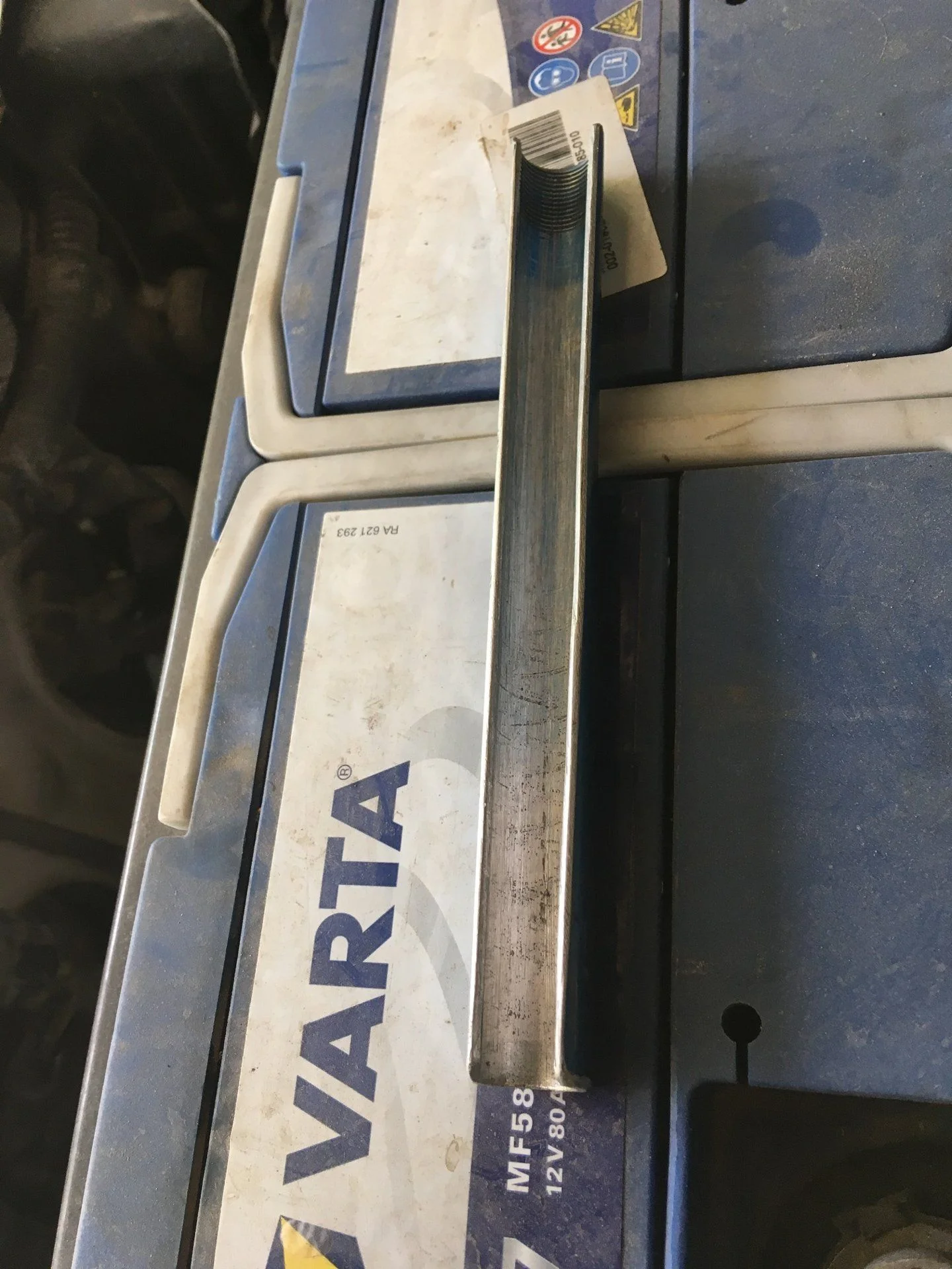

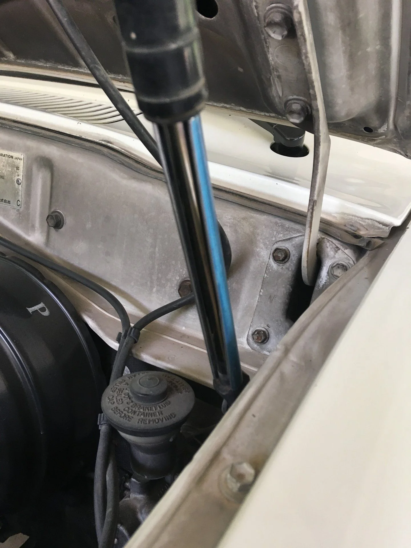

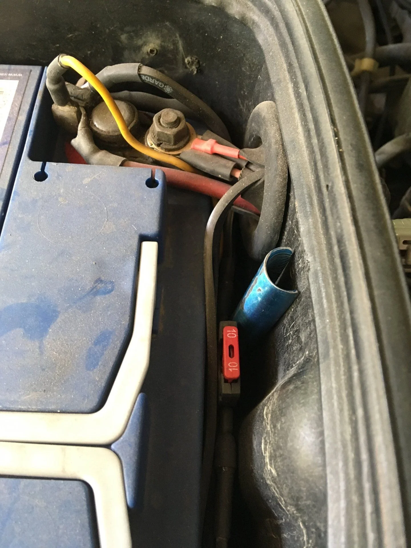

SPECIAL TOOL FOR DEAD HEAD HOOD STRUTS.....NOT TESTED ON REAR LIFT GATE :
Used a 16mm(o.d.), 2mm thick aluminum tube from an old speargun pump, took it on a table saw (very carefully) and fab'd this special tool, even found a secure home for it near the battery for easy access .
It works :clap:

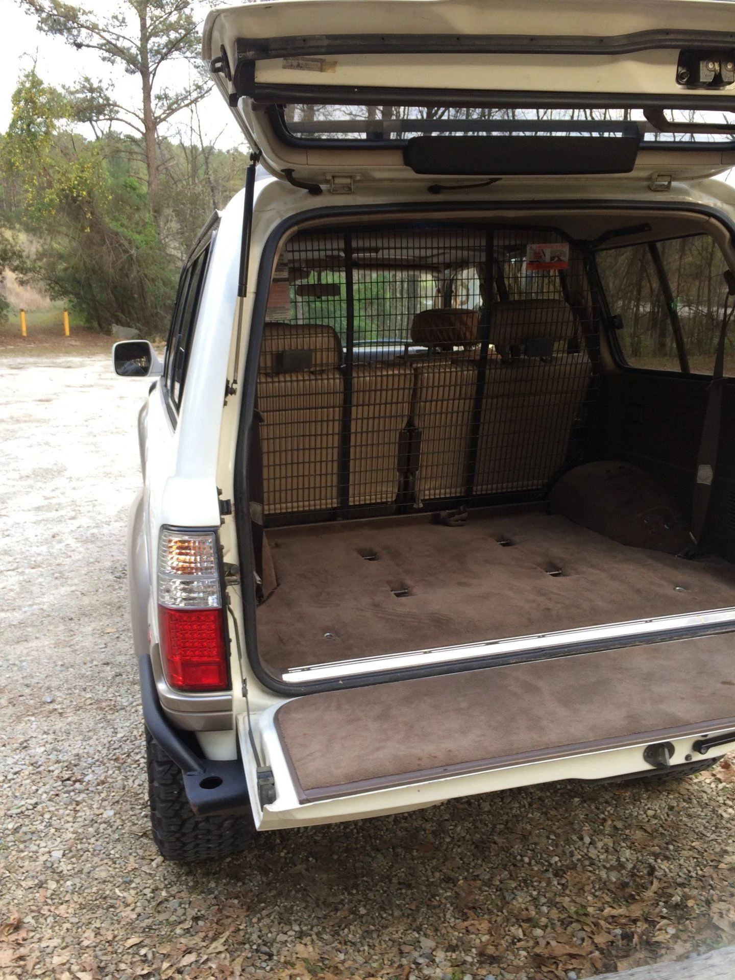

Milford cargo barrier

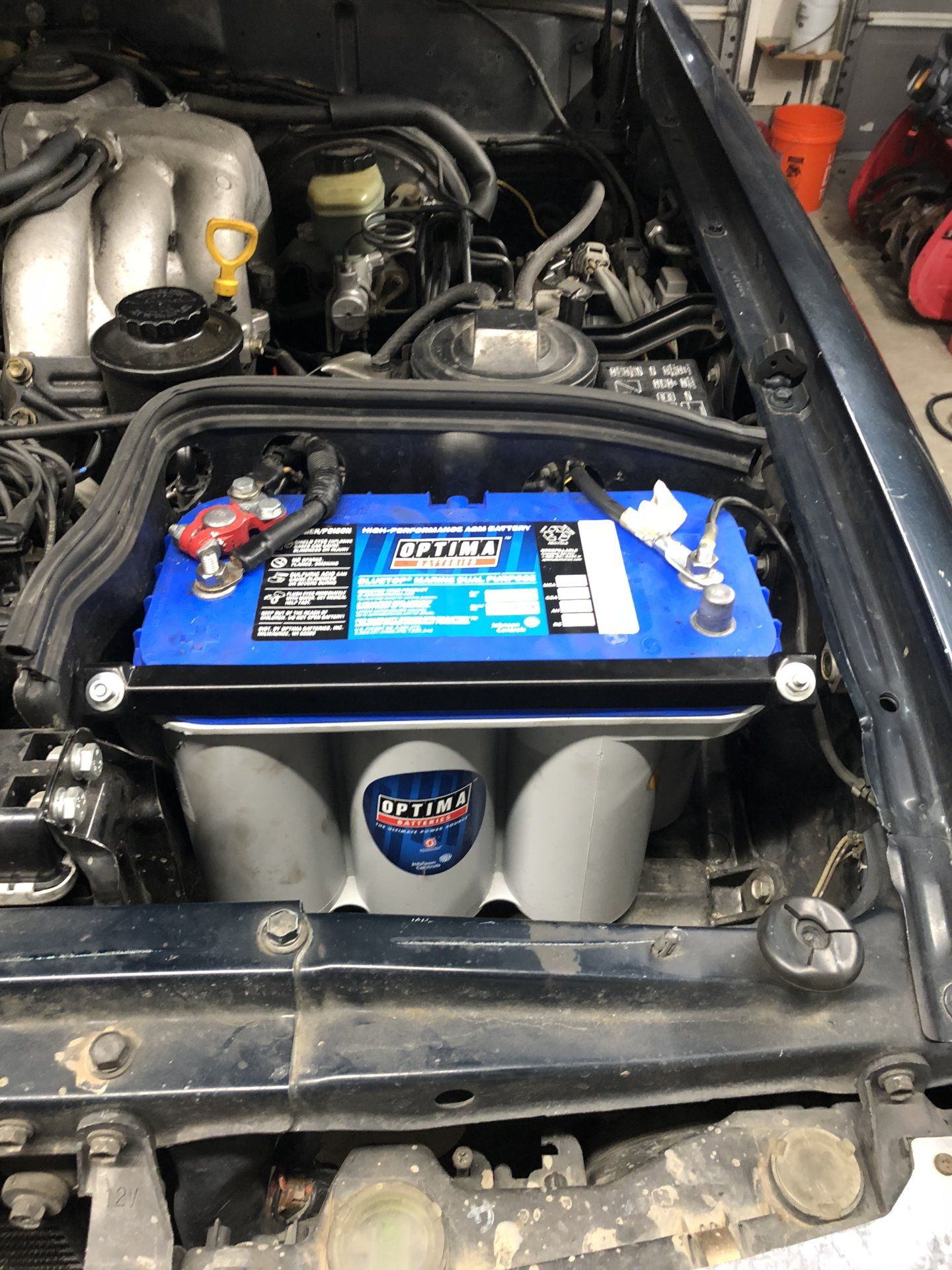

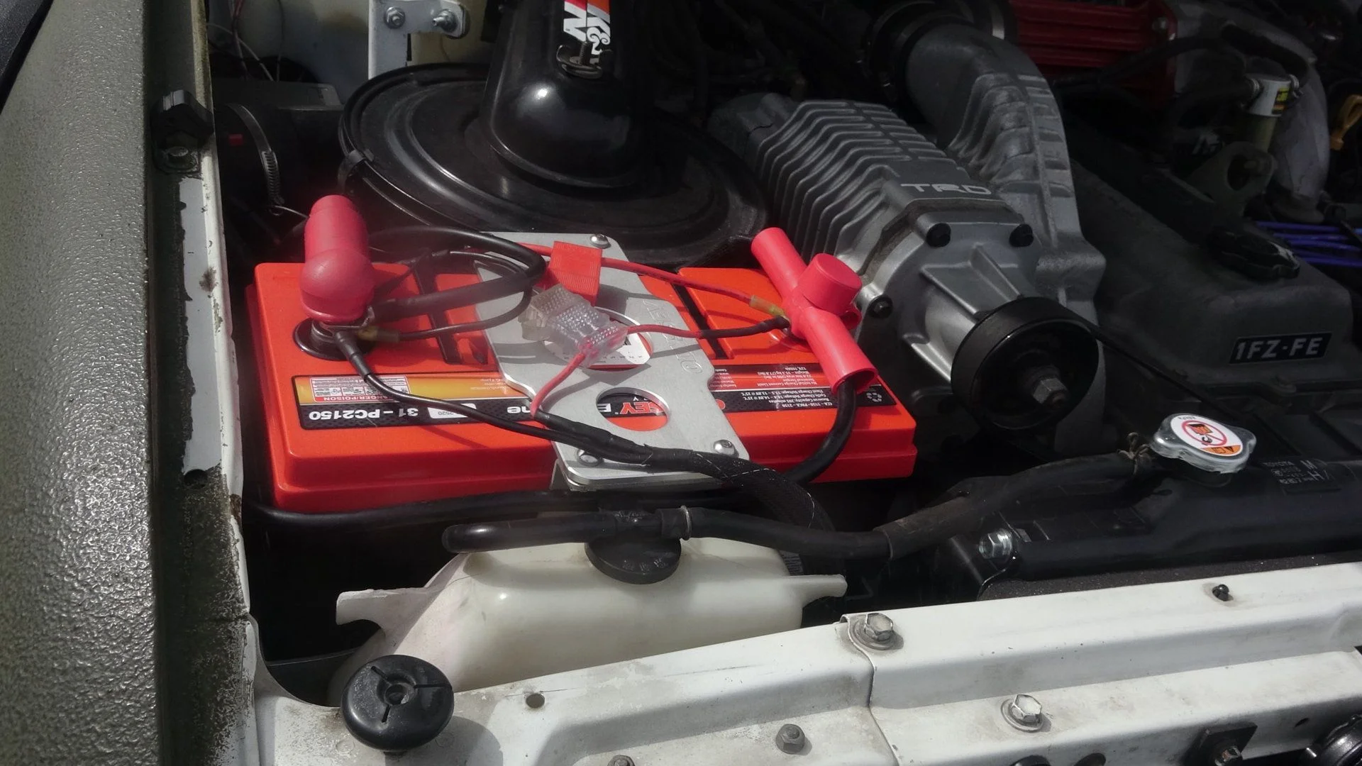

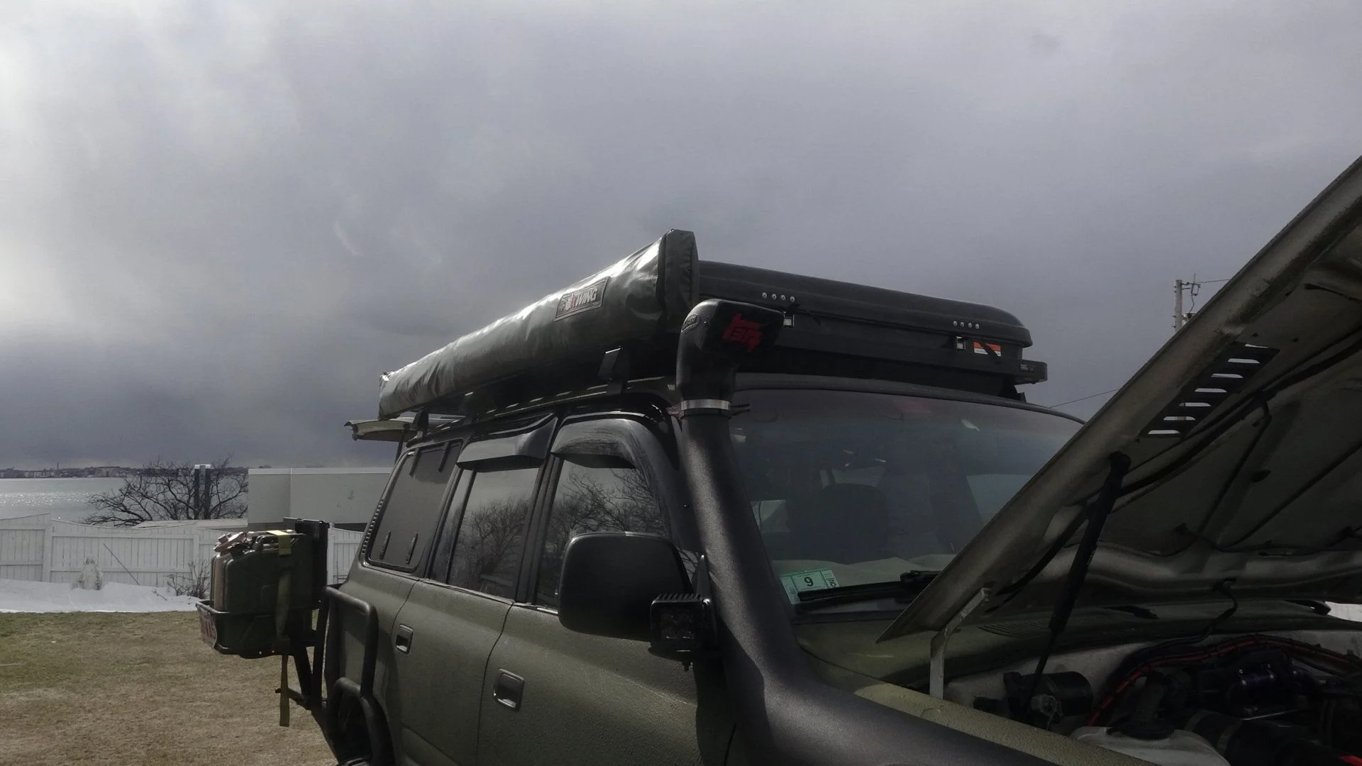

This has been a productive weekend installed the slimline 2 rack all aluminum so its lighter than one I built out of Hannah steel. reinstalled RTT, etc treated all rubber seals on windows I have to replace runs but not this weekend and finally after 3 finally made a braket up that bolts up to factory battery box holes and is strong enough to securely and safely hold down the 100AH battery for my house battery. waiting on a set of 50in KC gravities and will e mounting with yodateq windshield mounts. with this rack and some other deletions Ive lightend all my UP top weight as much as I could, and KING shocks arent shipped yet. so theres that. View attachment 1661965 View attachment 1661966 View attachment 1661967
@RFB What was necessary in order to get the Odyssey retainer bracket to bolt in?

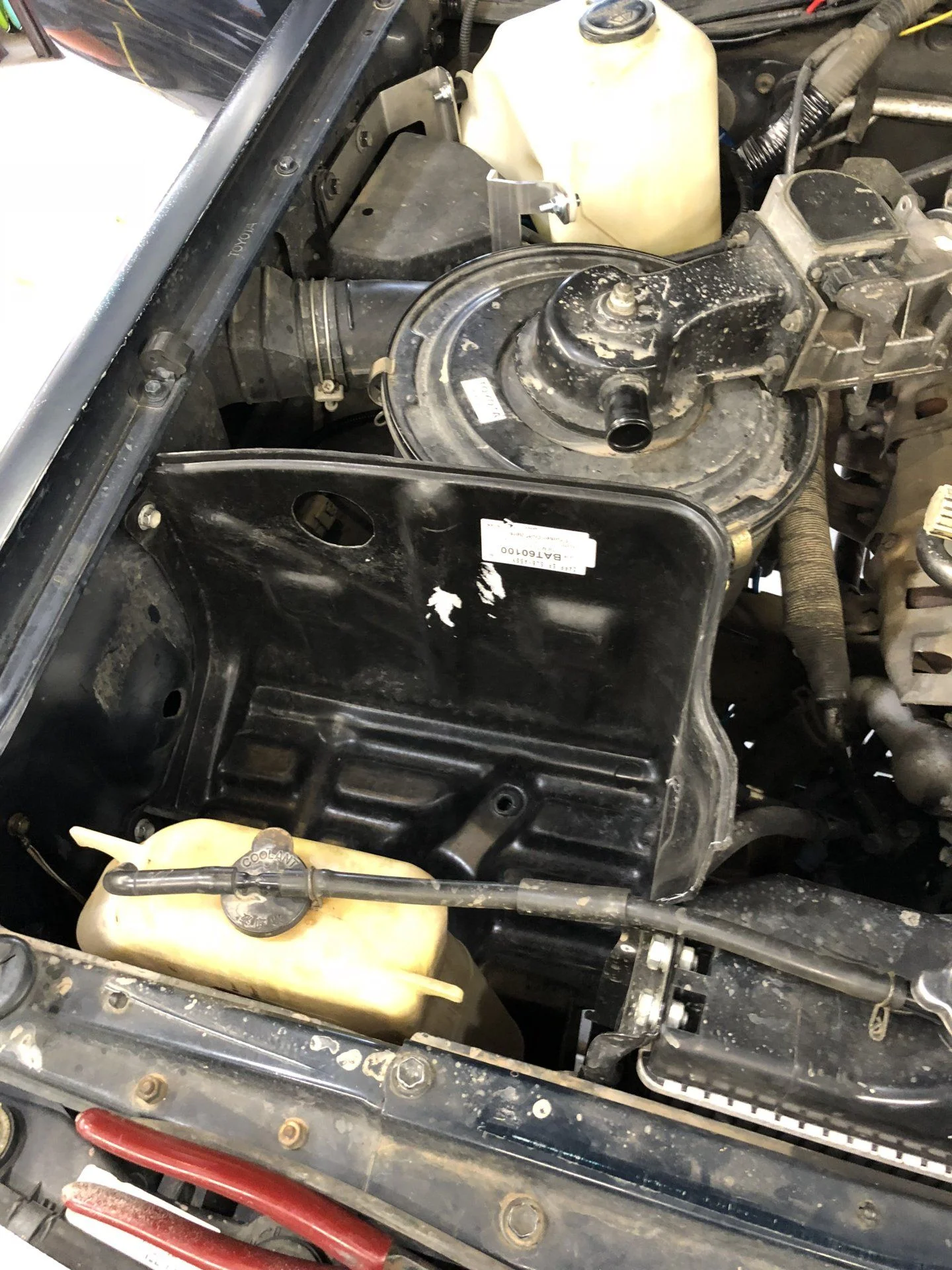

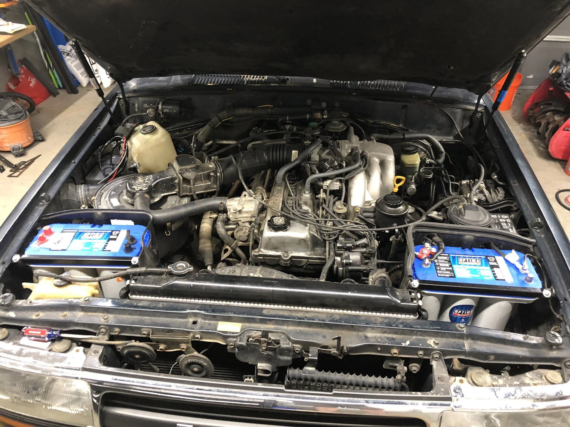

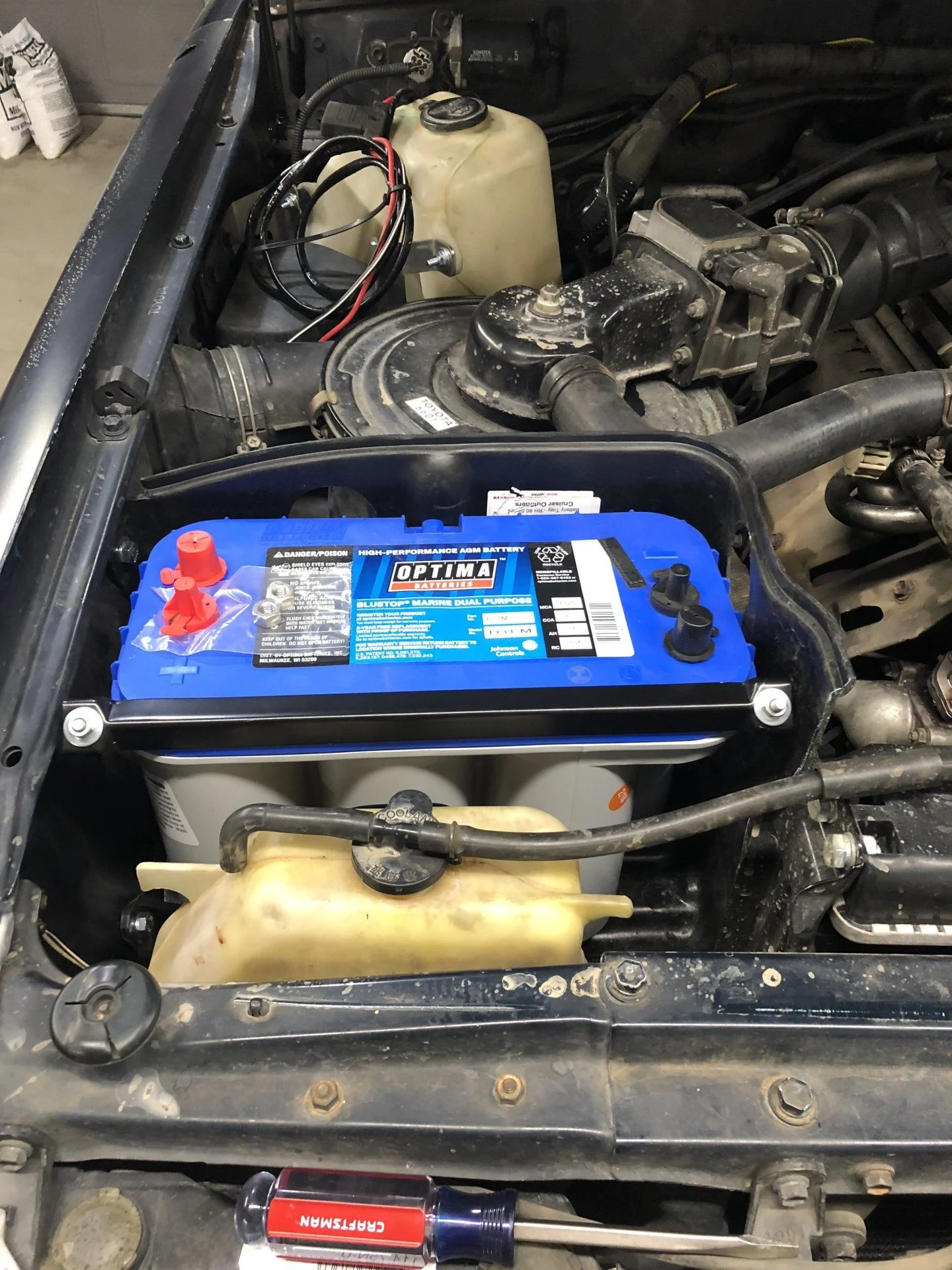

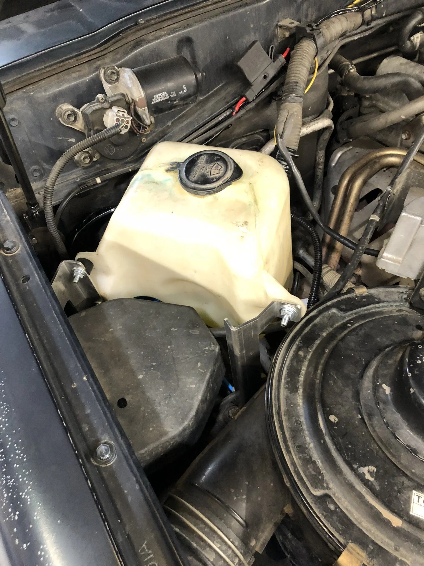

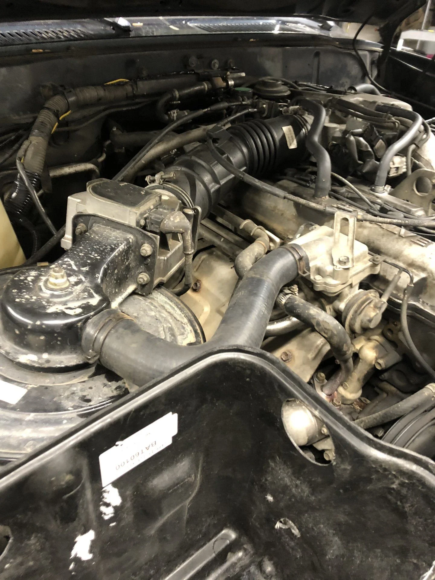

Washer bottle relocated w/ slee kit. Grabbed Napa p/n 9260 hose to eliminate resonator (cut small section of air cleaner side resonator hose. Place small section inside 9260 hose and reattach to air cleaner. A little heat helps. Reuse lower hose clamps on Napa hose. Awesome. Factory battery box installed. Radiator side requires slight trimming. Second blue top 31dm installed. Electrical next.
I made the same thing out of a piece of PVC 3/4” pipe, cut it 6” long and cut a slice down it length wise using a razor knife......... works great! *I put a piece of Velcro on mine, then another on the interior lip of the fender, and it has stated there for a year or so with no problems!

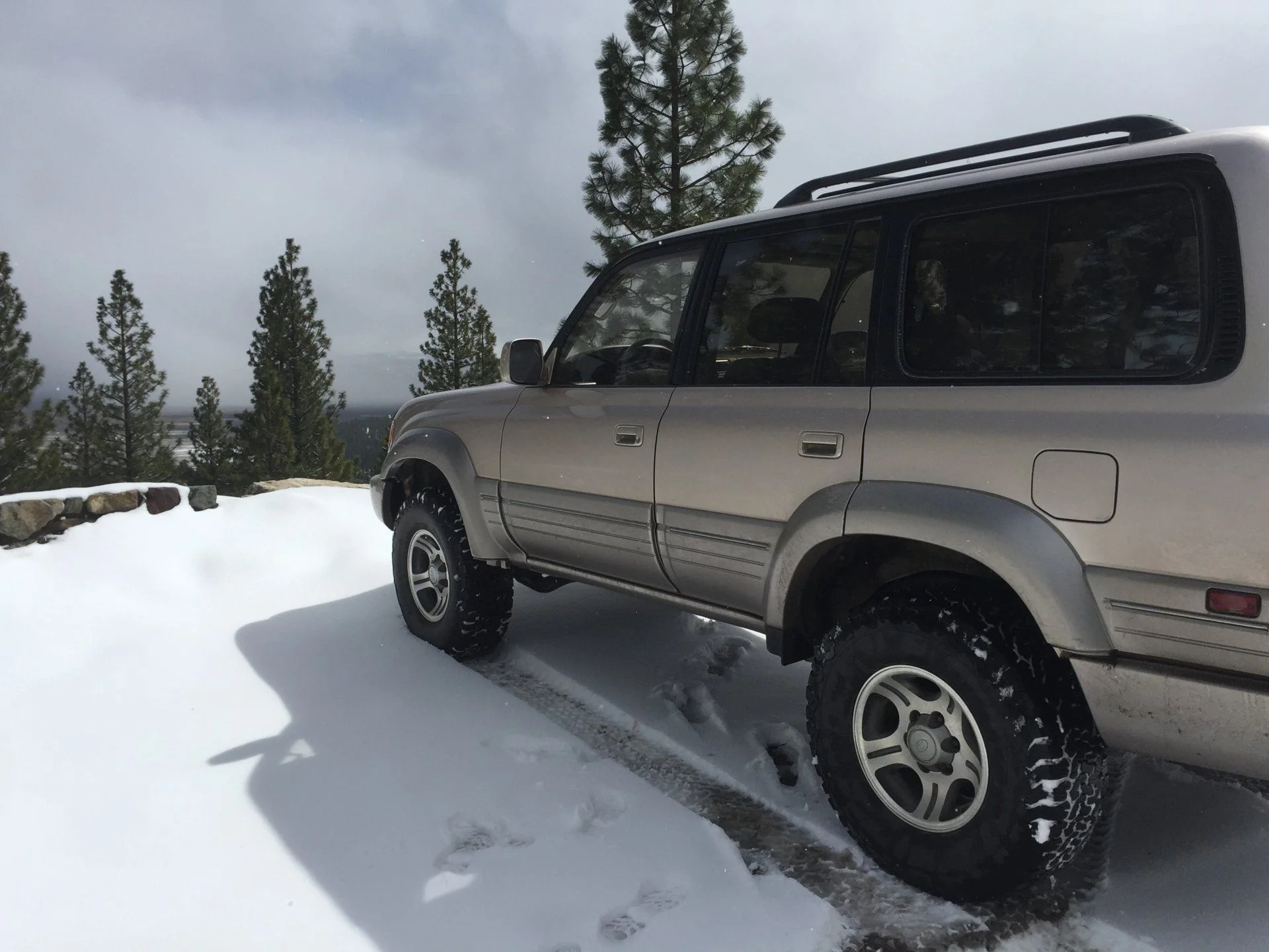

Thru Truckee then north on 89 to Sierraville, Sattley and up on the Sierra Valley overlook...on and off snow all the way
Views were not to good like many years ago because the ponderosa pines got big and blocked view..hoping for some bark beetles to bring em down ;) ;)..Im serious..
Is
that flat or angled? and was it custom built or DIY ? Im interested that has lots of uses beside the obvious.
Hey RFB it’s from an Australian company, Milford Cargo Barriers. It’s angled a bit to allow room behind the headrest while the center to bottom are angled to be close up to the rear bench.
