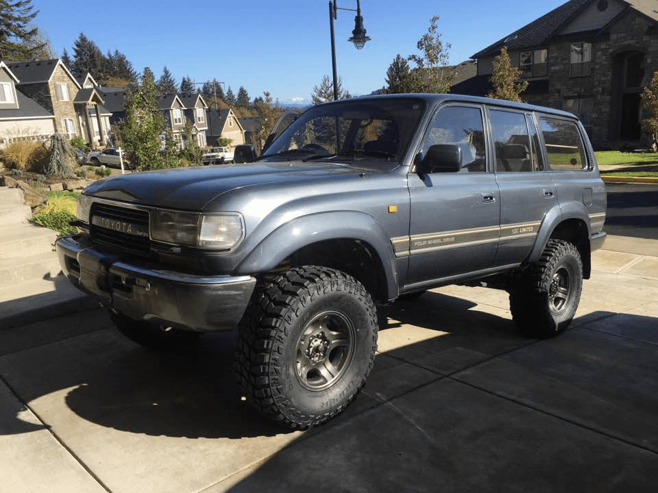

After a long few months of a build, the "black hole in my garage that I throw money into" was finally drive-able.
Some of the recent upgrades include:
1. FZJ80 brake upgrade with Toyota factory rotors, calipers, and 100 series pads.
2. Replaced front wheel bearings, inner axle seals, trunion bearings, and trunion seals
3. Longfield front axles and updated drive flanges.
4. Replaced rear wheel bearings
5. Reupholstered sunroof shade
6. Cooper STT Pro 315s mounted on repainted LX450 wheels
7. Complete 4" Ironman Lift
8. New brake hoses and LSPV that is now only a PV...

Did you paint the wheels yourself? If so, what paint and color did you use?
Ride looks great!
Ride looks great!
Thanks,
First i took the wheels down to metal, hindsight I would have paid to sand blast them.
Then I used a self etching primer, 3 coats.
Duplicolor wheel paint in Graphite, 3 coats.
2 coats of duplicolor wheel clear coating.

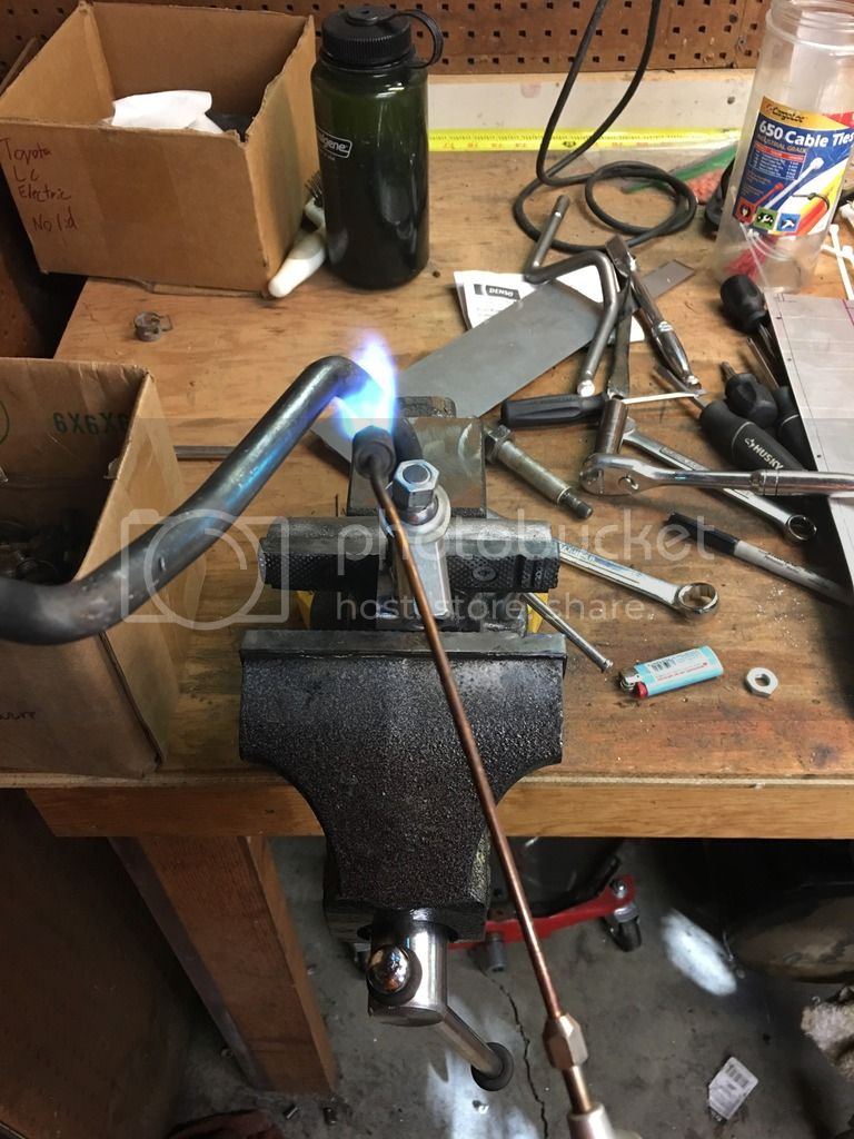

Yeah RTV isn't going to work there at all, even JB Weld will burn out right there, you need a plate.
Yes. It's getting plugged. Fighting getting that nut off so I can plug it properly. For now it will get RTV. I don't think that's under pressure...
I gave up on the EGR pipe and filled it with JB Weld. I stuffed little balls of it down in it then pushed it in with a screwdriver. It's red neck as all get out but I was running out of patience and daylight.
Do you think the steelstik JB Weld stuff will hold up? It says it is good to 900 degrees...

It is going to be close. I would guess the temp out of the exhaust ports is right at 750-1000 degrees depending on load.

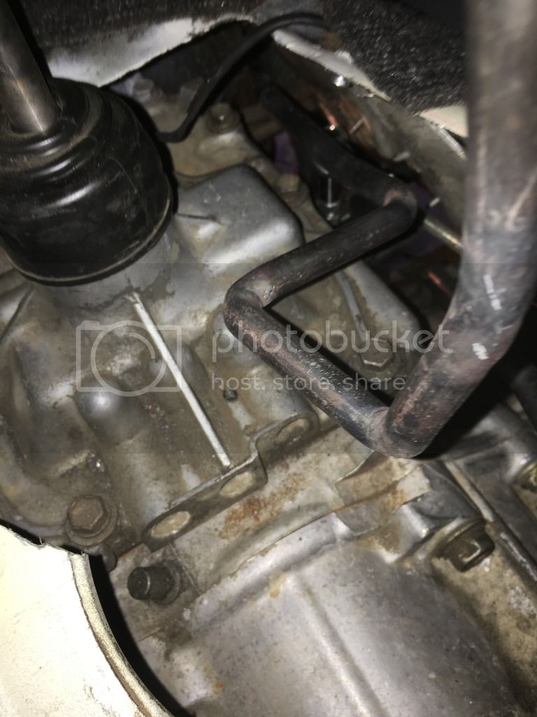

So much work getting twin sticks in the right spot.... NEVER AGAIN... lol
Just need to get my shift boots so I can finish up the console.

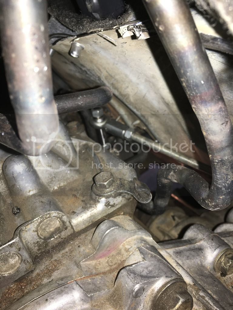

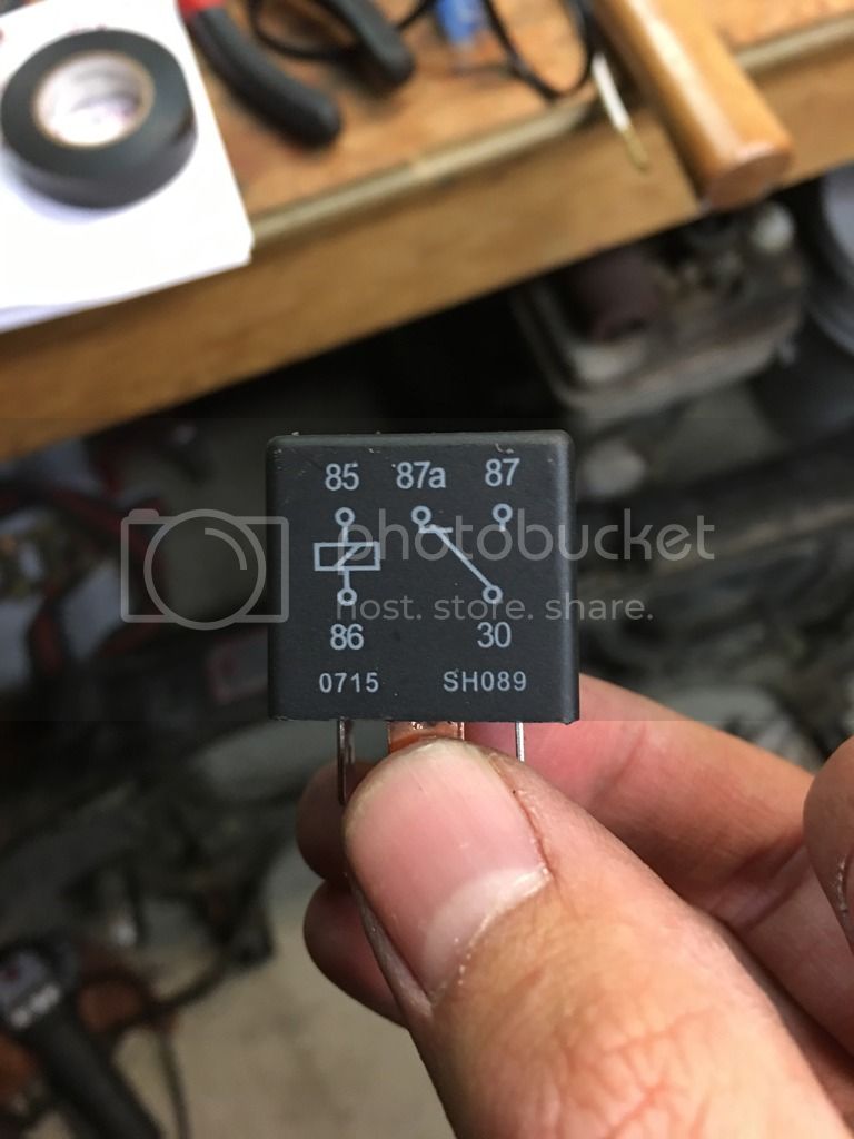

Clutch switched I used to try to get the cruise working.(not working could use help with this)
Relay becasue switch sent the opposite signal I wanted to the ECU...
Wiring harness I made for clutch switch and relay
