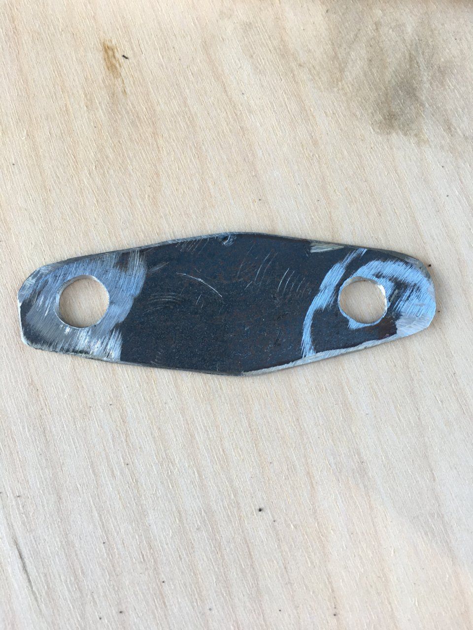

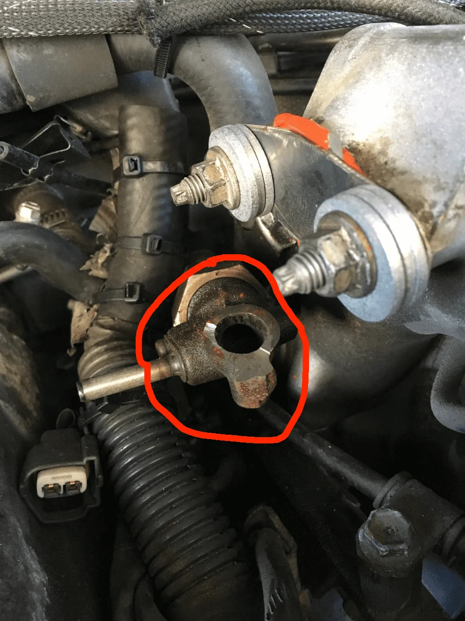

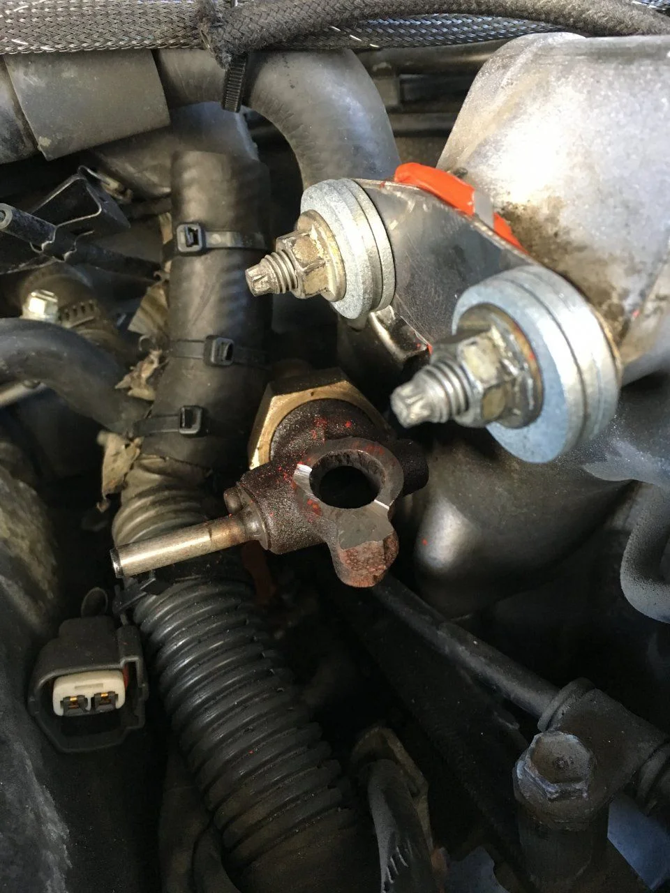

Are you going to block the lower one off too?
I heard some people using their cars strictly off road, block off both ends.
Not sure where the lower one is. If I know where it is I will. This one will be "strictly off road". o_O
Yes. It's getting plugged. Fighting getting that nut off so I can plug it properly. For now it will get RTV. I don't think that's under pressure...
Unfortunately, there is hot exhaust from cyl #6 coming through there. Either remove and block at the back of the head, or you probably could make a round cap retained by that damned stubborn nut you are trying to remove.
Installed Trail Gear's spindle nut upgrade and new outer drivers wheel bearing today. The last time I checked my bearings I noticed drivers outer had minor pitting repacked both sides with synthetic wheel bearing grease done. My opinion
the trail gear stuff I've seen it's not bad stuff the spindle nut upgrade nice
Repaired last weekend's alternator failure. Pulled the alternator, took apart the back half to get to the brush holder. Pulled the brush holder and flushed it out with water to get the mud and silt out. Once the brushes were moving freely, put it all back together. Happy to report the alternator is now working fine :-)
Don't plug it. Remove it completely. There may be a block off coming for that as well ;)
Where does that pipe go?
Back of the head. Totally accessible. It's like "right there" :p
Define "accessible". I can't seem to find it. I'm about to give up and plug the hole with JB Weld Kwik steel for the time being...
@NLXTACY i found it. FAWK THAT!! I'm using JB Weld.
