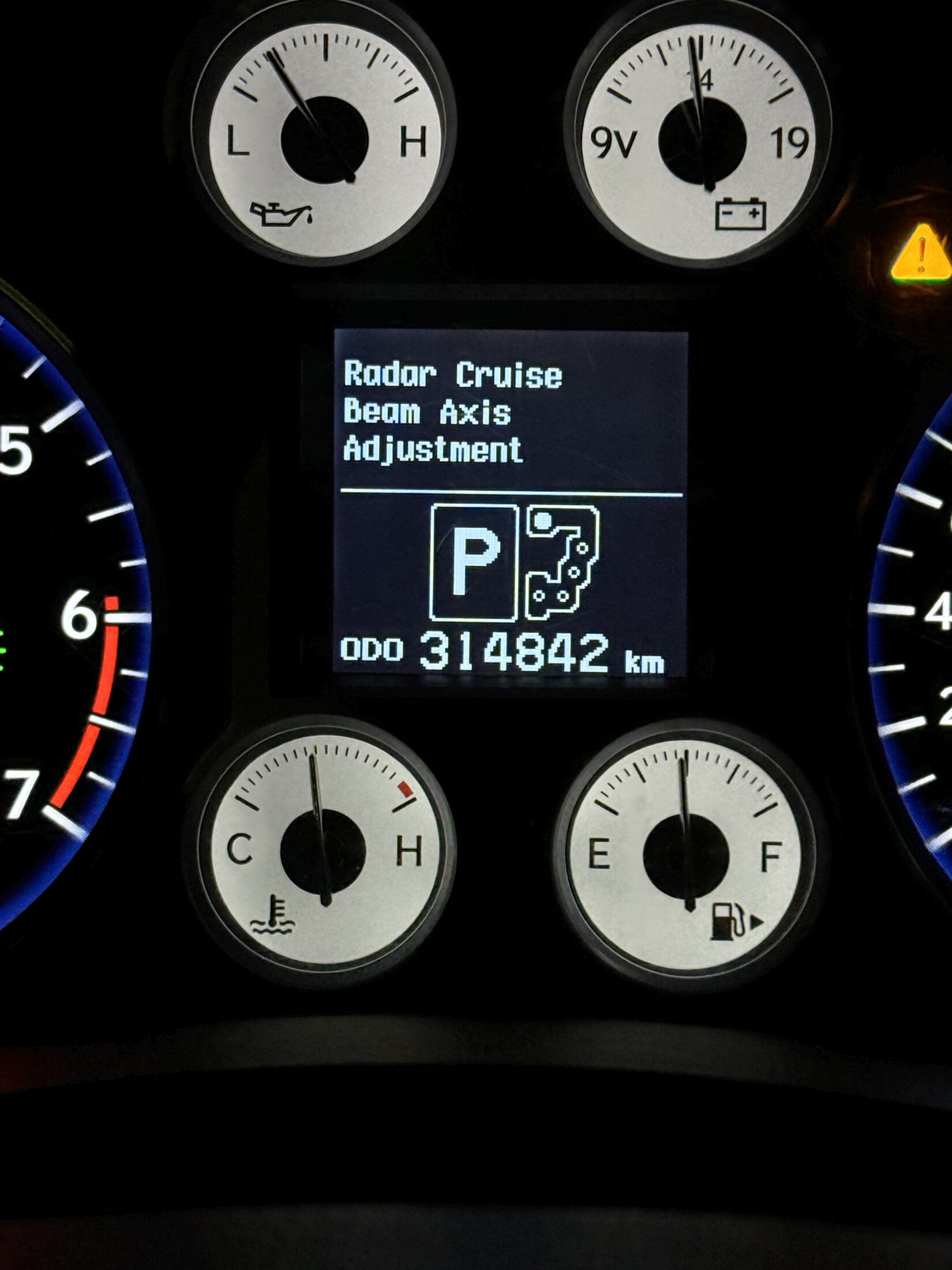

I also tried the radar, cruise beam axis adjustment protocol with steering wheel shortcuts. This also did not have any long-term effect.
Any luck with fixing this? My 2008 LX has the same issue and same message aswell, if you have the Tech stream software perhaps use it for re-calibration? also my seats belts still tighten when sudden braking.
