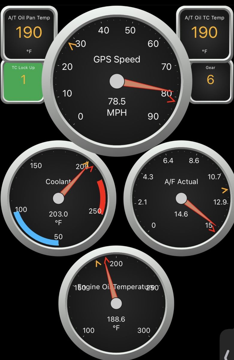

On a hot day after it is fully heat soaked, I generally am around 200-204. That takes a while though. I checked my old screenshots and I see one max temp that looks like it might be close to 208 (see red arrow below) once. I set me warning zone on my gauges to 220 and have never got close to that.
Nice custom dash.
Thanks. I've made a few changes since this screenshot so I can track max temp of the transmission but the style is the same. I like how easily I can see what's going on.

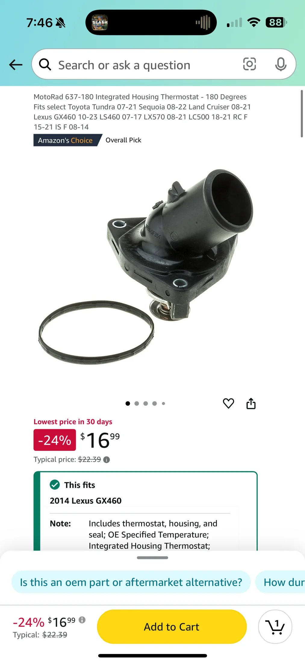

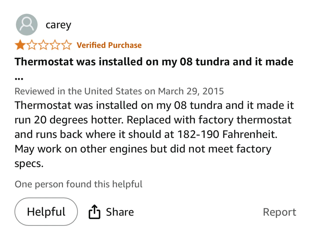

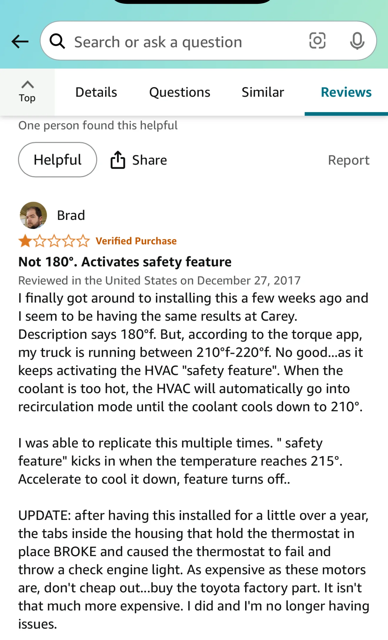

The radiator was replaced not long before I bought the truck and I just noticed they installed a Motorad thermostat.
I guess I will be swapping to an OEM thermostat this weekend
