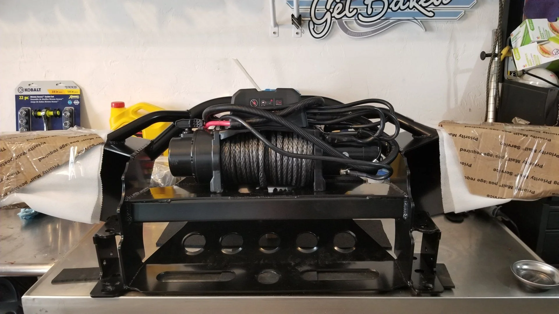

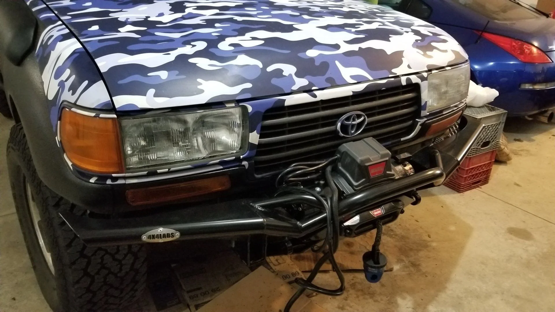

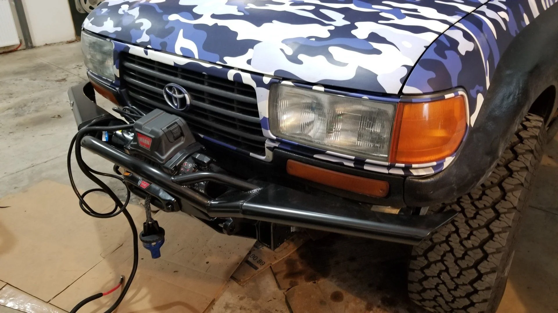

Mated the bumper and the winch ... but having some issues getting it over the frame and mounted. Trying to ratchet strap the frame today to see if that helps. Past that .... I'm totally open to suggestions.

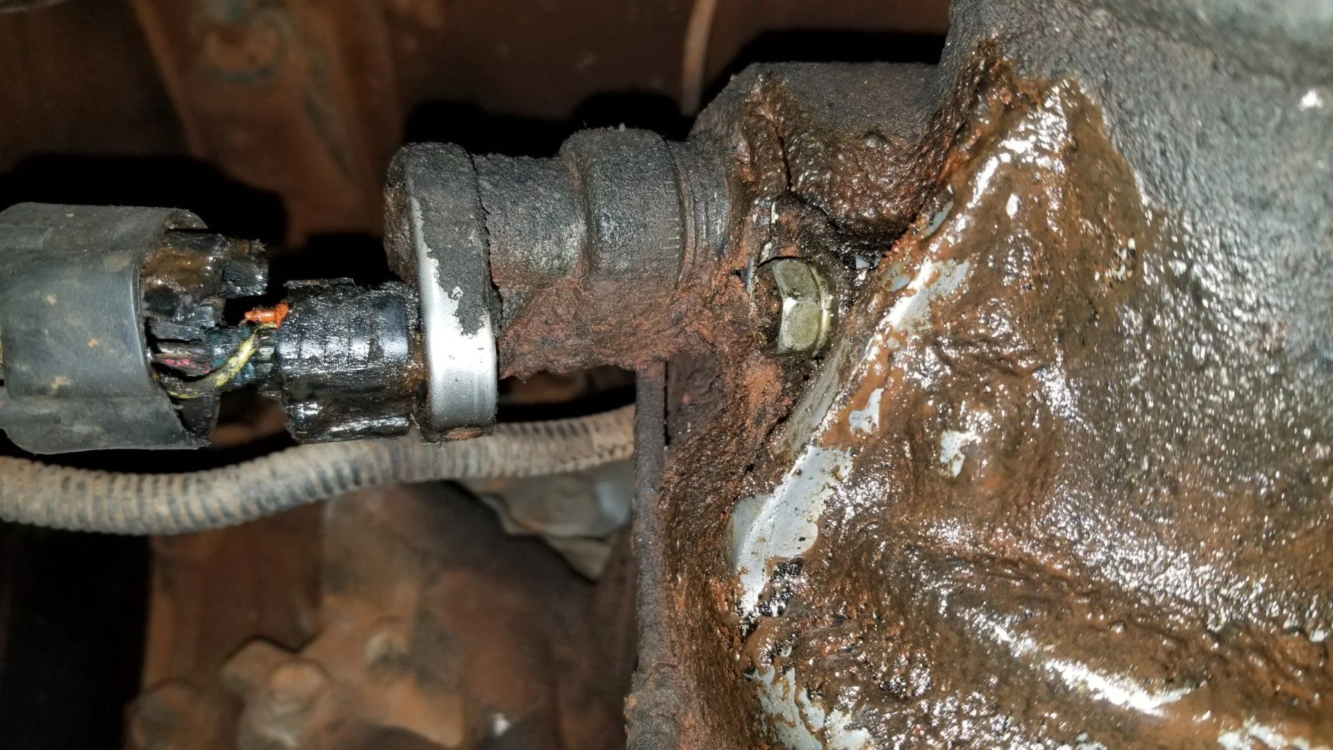

Finally, since I can't seem to fix one thing without immediately finding the next broken item, I tried to better secure this speed sensor and now the speedo doesn't work at all and I have a PO500 code. It's been busted and hanging like this since I bought the truck. Man this is frustrating :bang:
I finally got it ... mostly. Had to ratchet strap the frame rails and pull them together. Then stop caring about the powder coat and "tap it" 20-30 times side to side with a 2lb sledge hammer. Got the strap from the ratchet stuck under the lower flange for like 20 mins ... that was fun. Top and bottom bolts look like they will line up, not sure about the sides.
