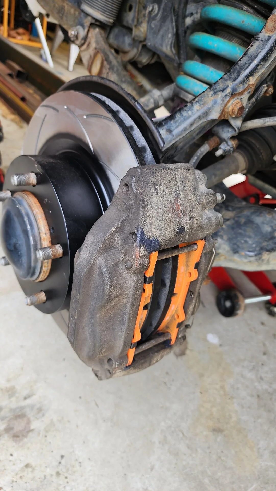

Where we started, removing factory bumper, wheels, suspension ECT.

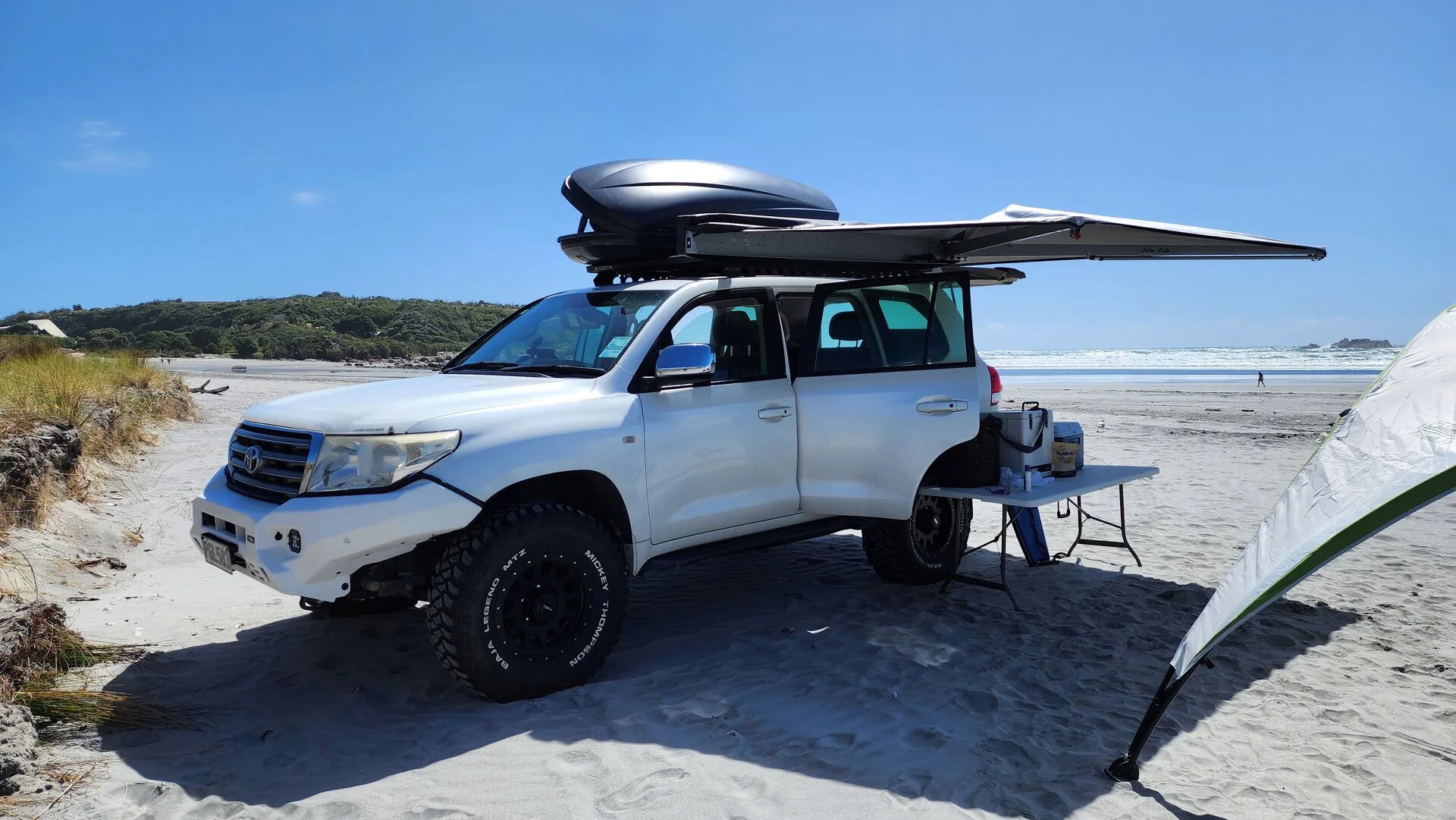

I Had already fitted up the Rhino Rack platform and AluCab 270 awning.

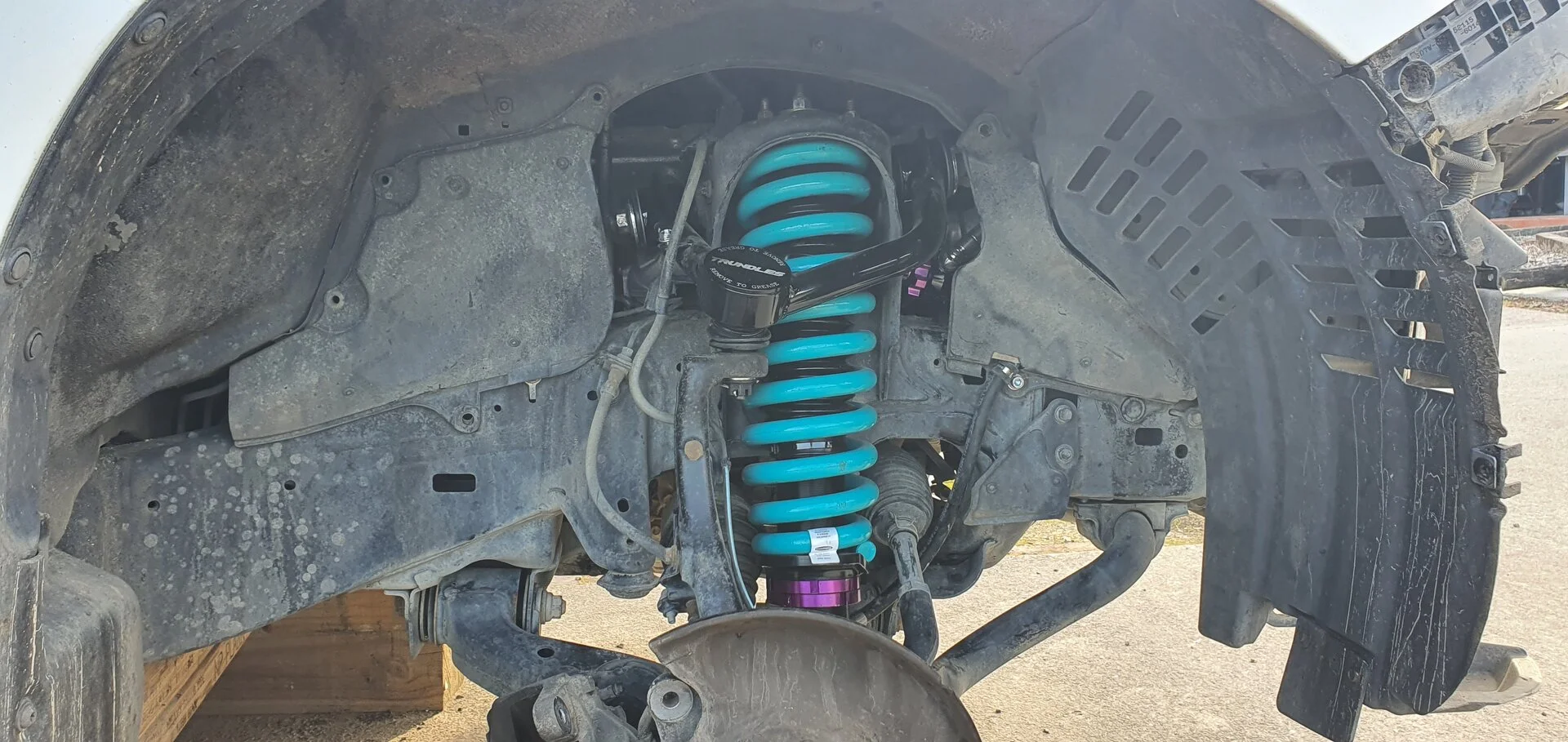

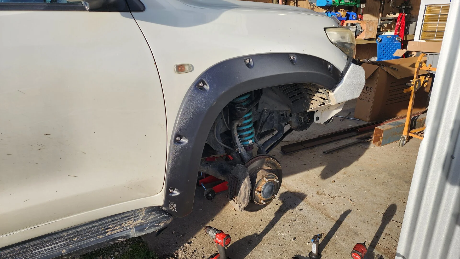

Dobinsons 3" lift fitted all round, MRA with remote reservoir, included Dobinsons upper control arms and Trundles diff drop and adjustable rear sway bar.

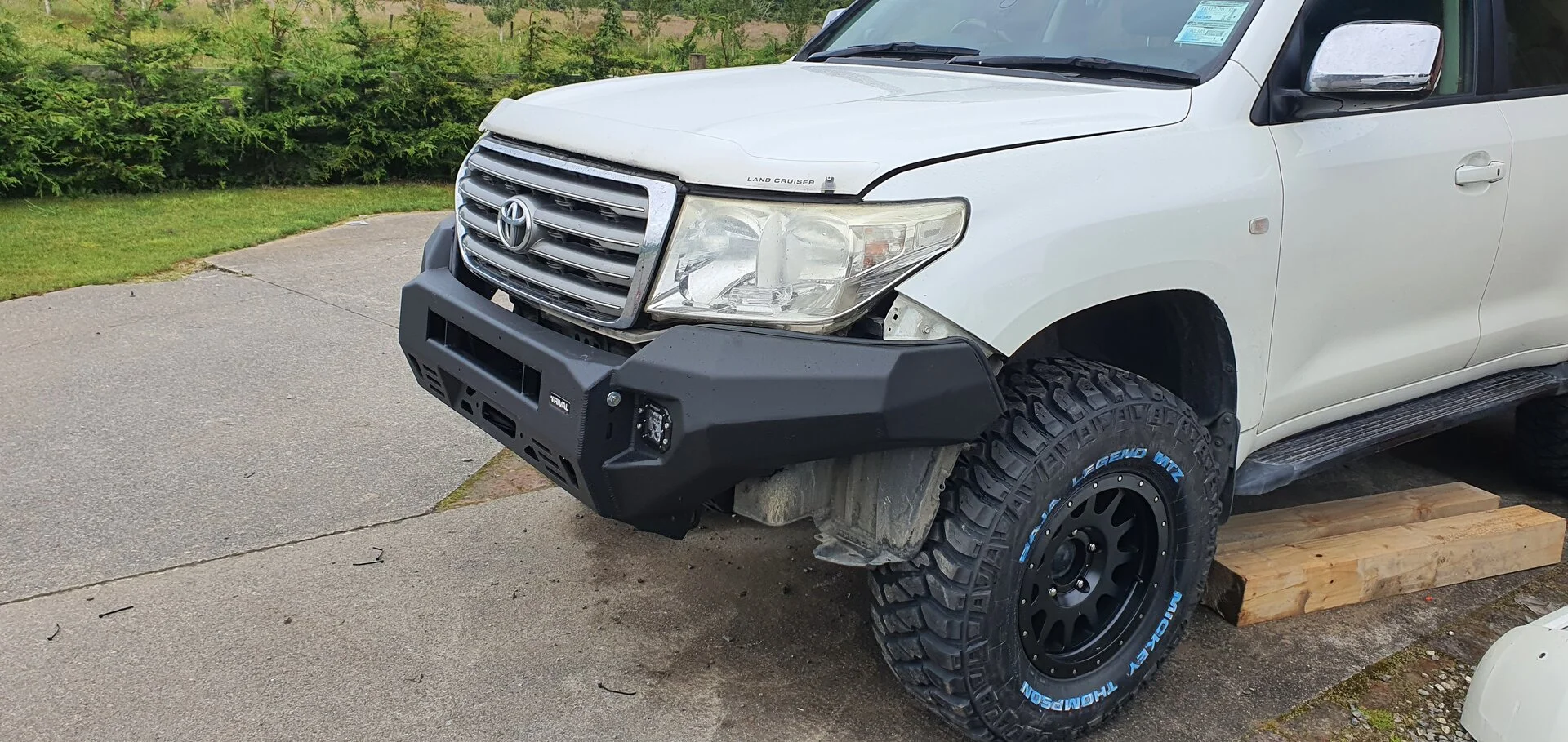

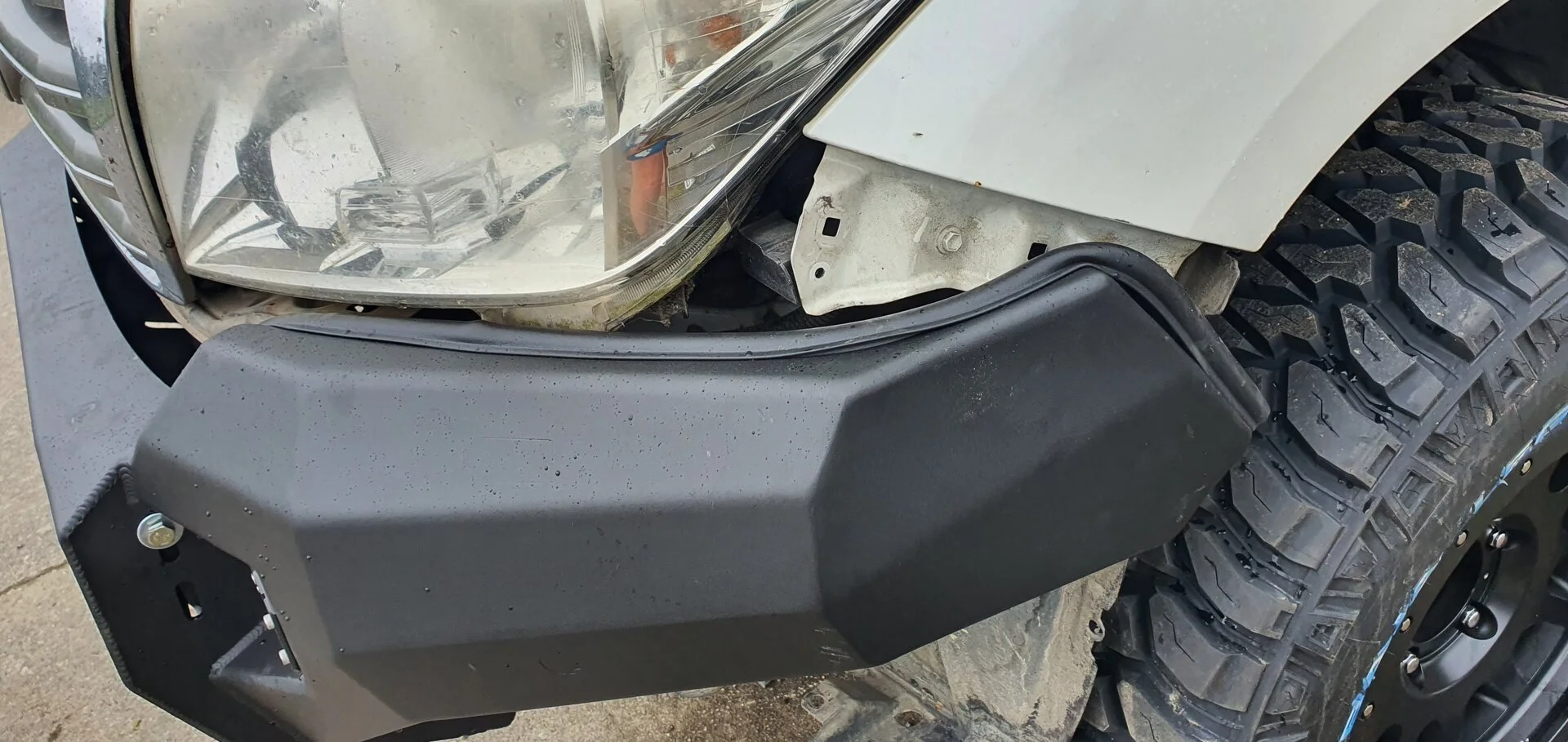

A wee bit of drama with the Rival bull bar, I was sent the later model option, which clearly doesn't fit. Foiled my plans to have this looking sharp for last Xmas.
Stage 1 complete, correct bull bar fitted, I Raptor coated it (Colour matched), ready for the beach..

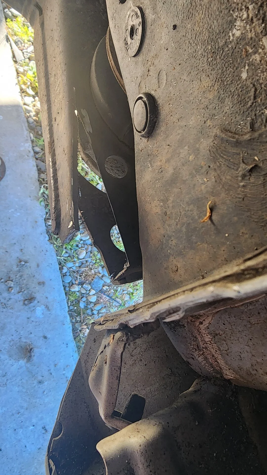

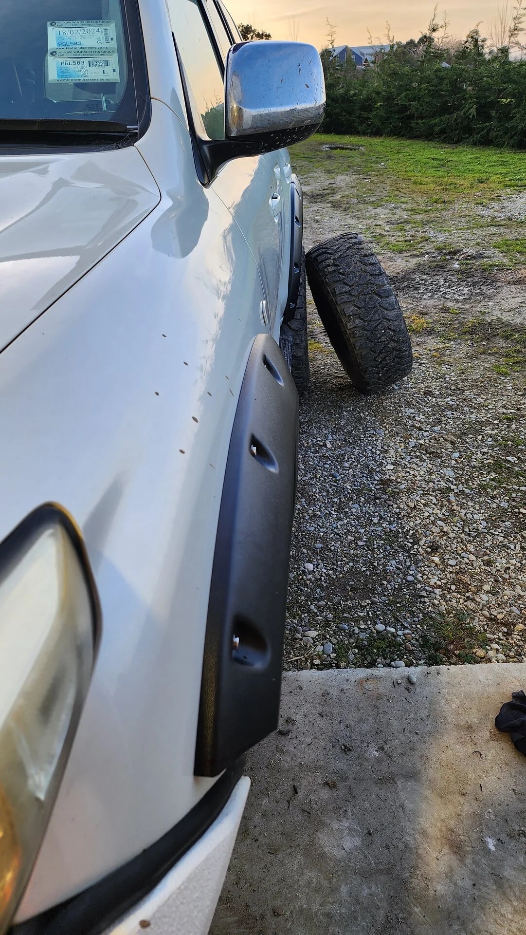

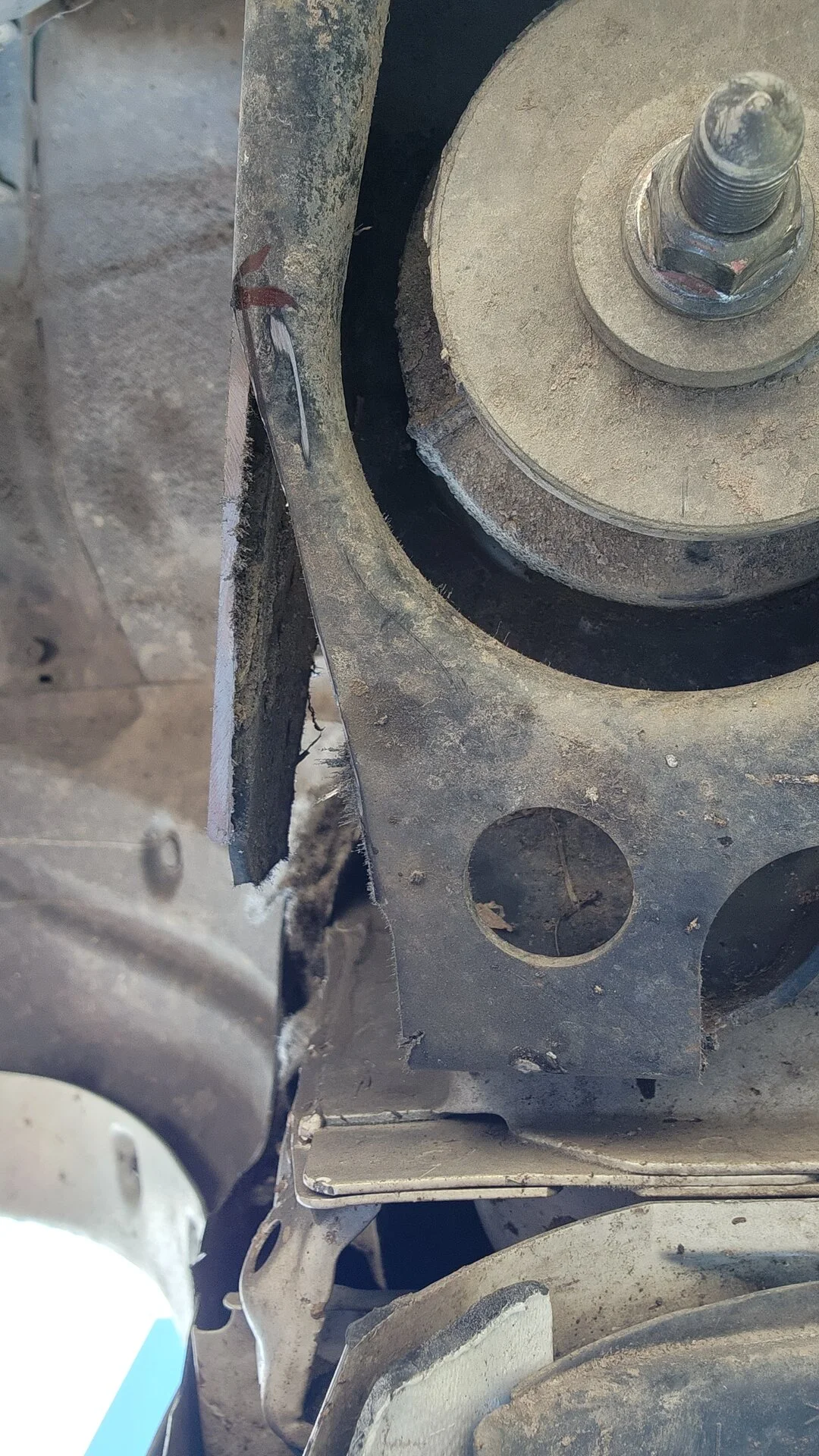

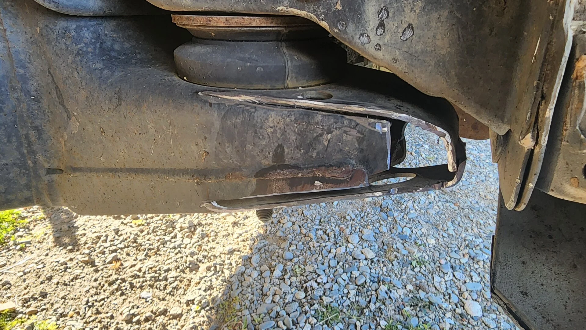

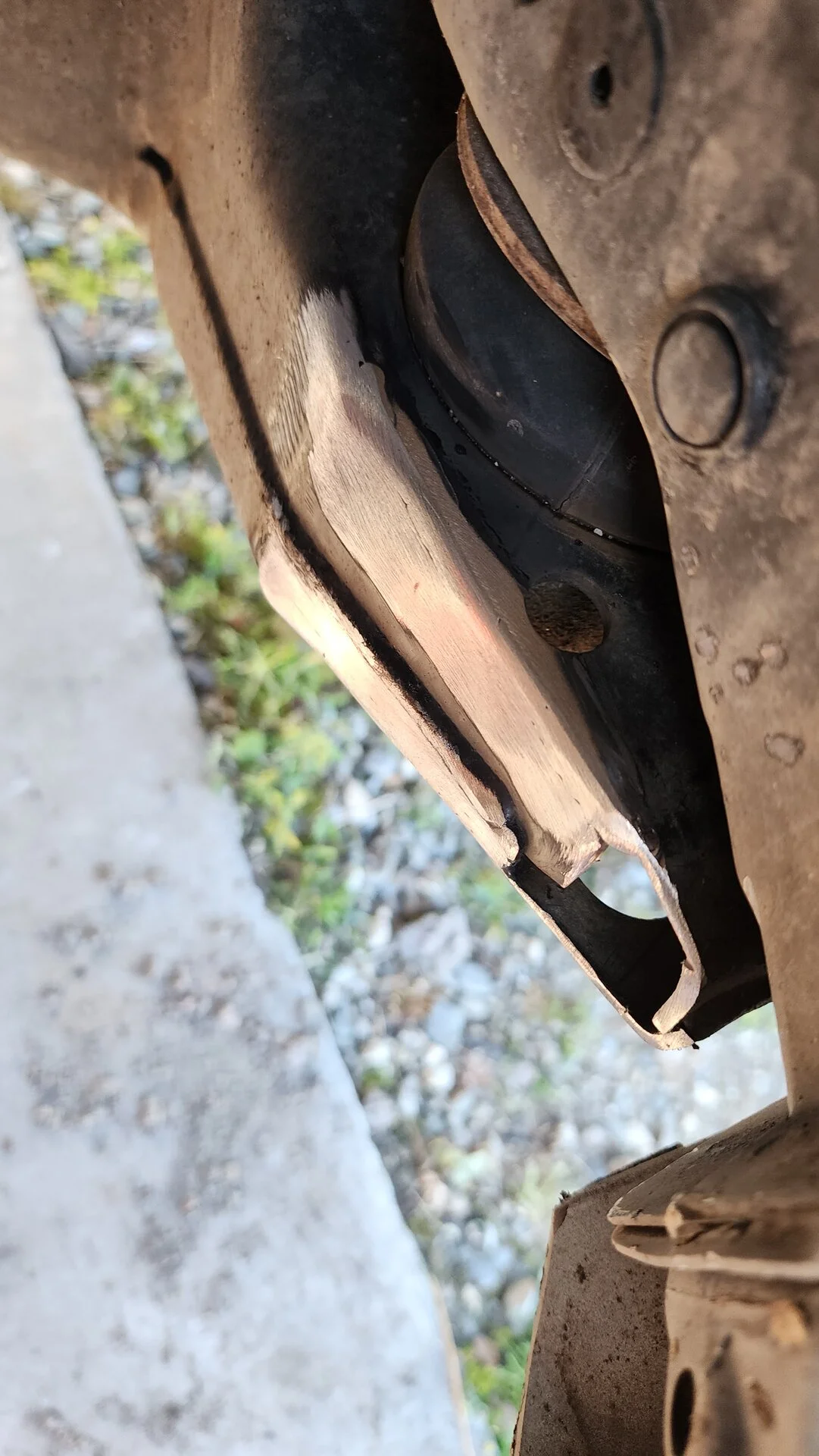

At this stage, I had a wheel alignment done, but still rubbing on cab mounts, and will nee a bit done before I can get it certified (welcome to NZ), Flares, speedo adjust, brakes ect. Pretty much left it like this for next 6-8 months.

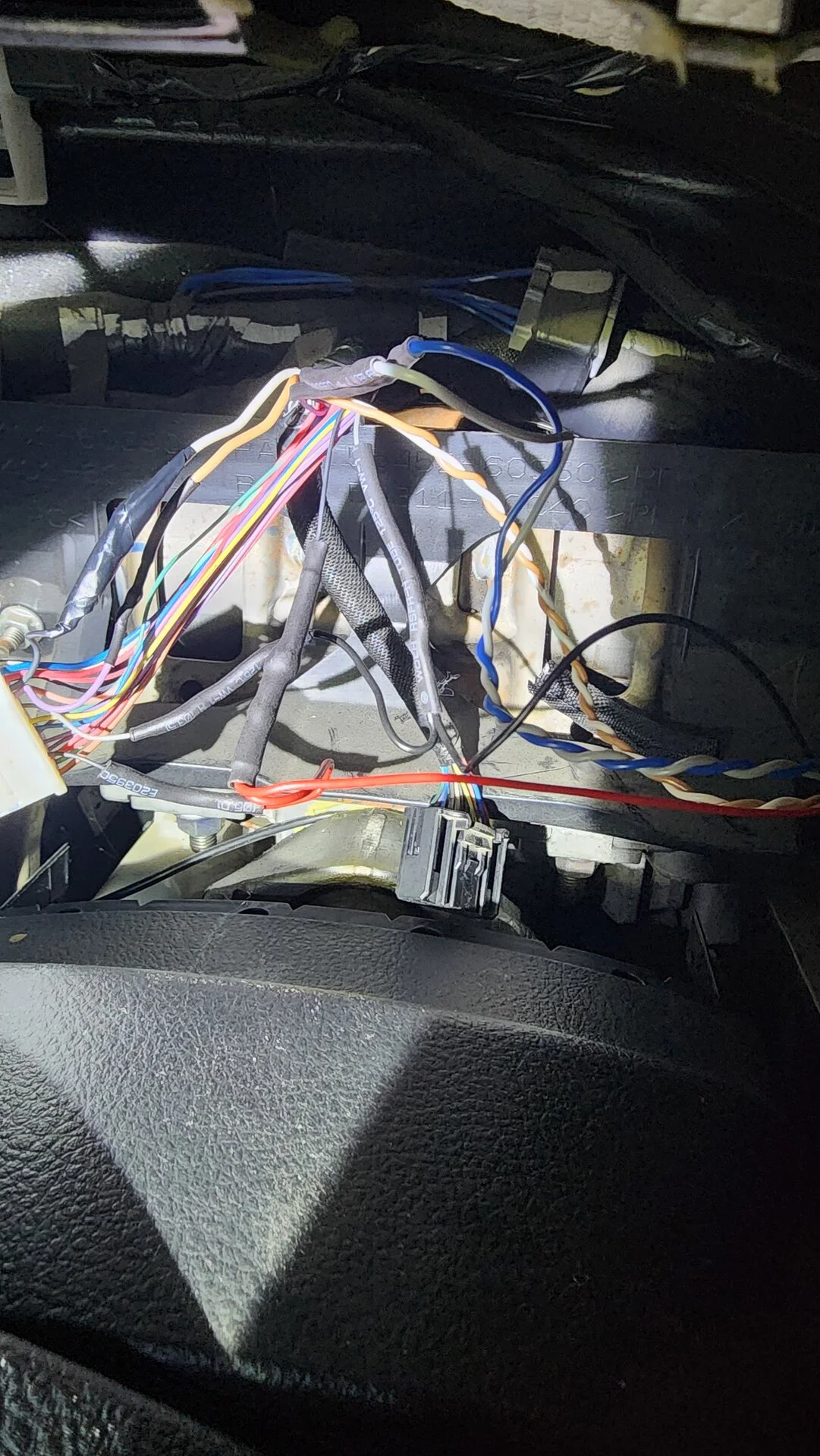

EVC-X throttle controller and V-LINE Bluetooth fitted on the inside.

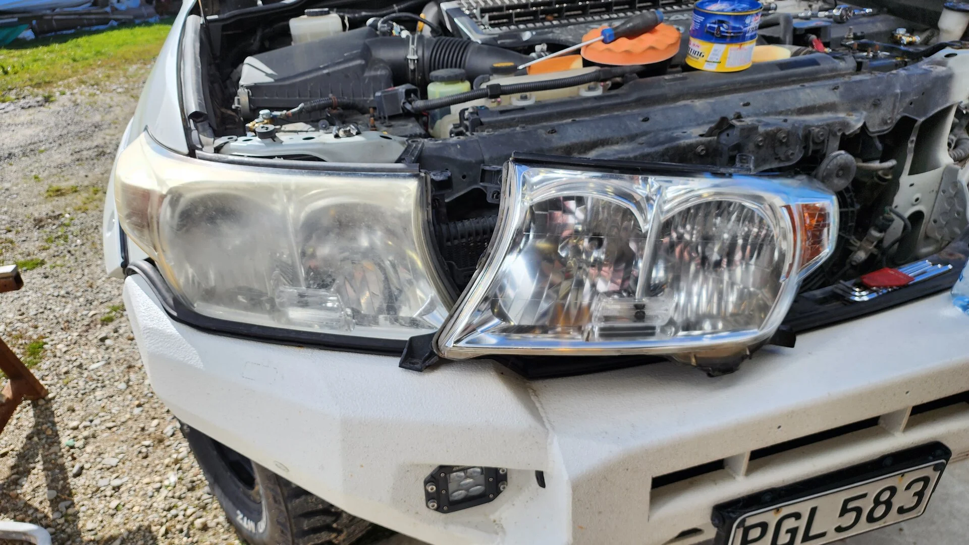

And that's us for now. Plan next is Snorkel, Airbox, Exhaust and then I have a bunch of lighting to wire up, spots, light bar ect. and a decent winch.

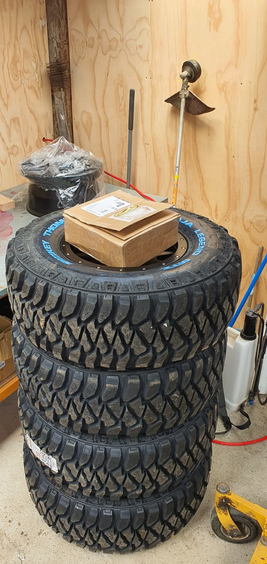

are the flares for the 0 offset wheels required?

Does this rig have KDSS?
If so what are the specs on the wheels to clear such a wide tire?
