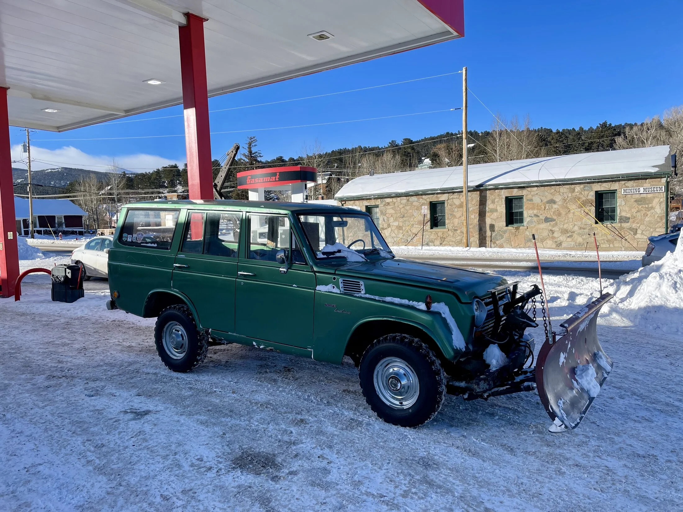

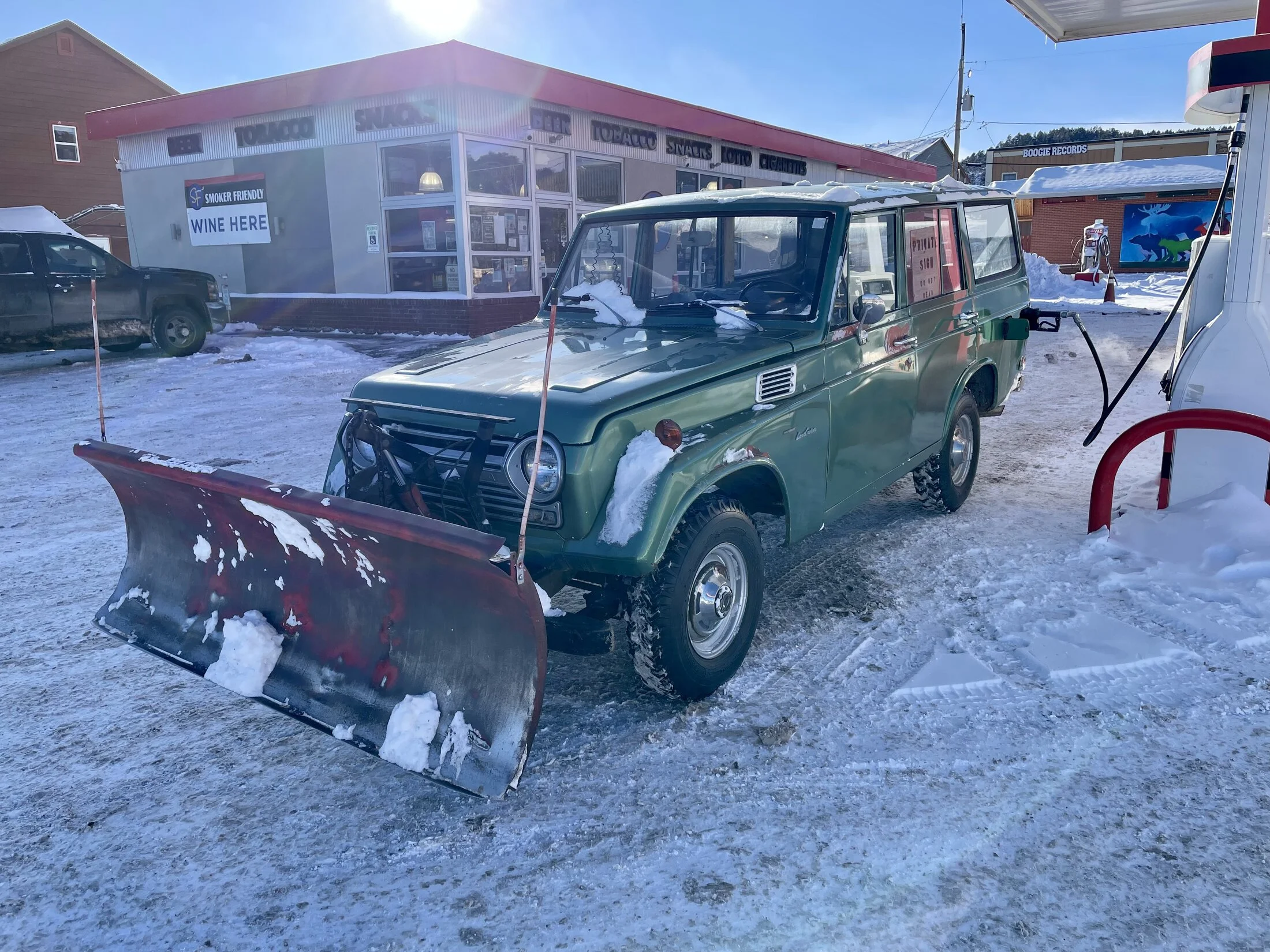

Was 1 degree yesterday and I needed to plow 5-6 inches of snow. The old PlowPig55 was a little slow starting (going to need a new starter this spring) but when it did start the accelerator cable (like the old brake cable on your bike) snagged inside the cable housing and locked the throttle wide open and red lined an ice cold F motor, screaming like a car at a drifting completion. Thankfully the hood was up and I jumped out and lifted the throttled linkage and got it to idle......I was terrified it was going to blow a new engine! Anyway, I pulled the throttle cable, ripped out the plastic liner and reinstalled the steel cable and got it running normally. Finished plowing, the engine seems fine and took the old pig to town for a drink and now need order a new throttle cable!
