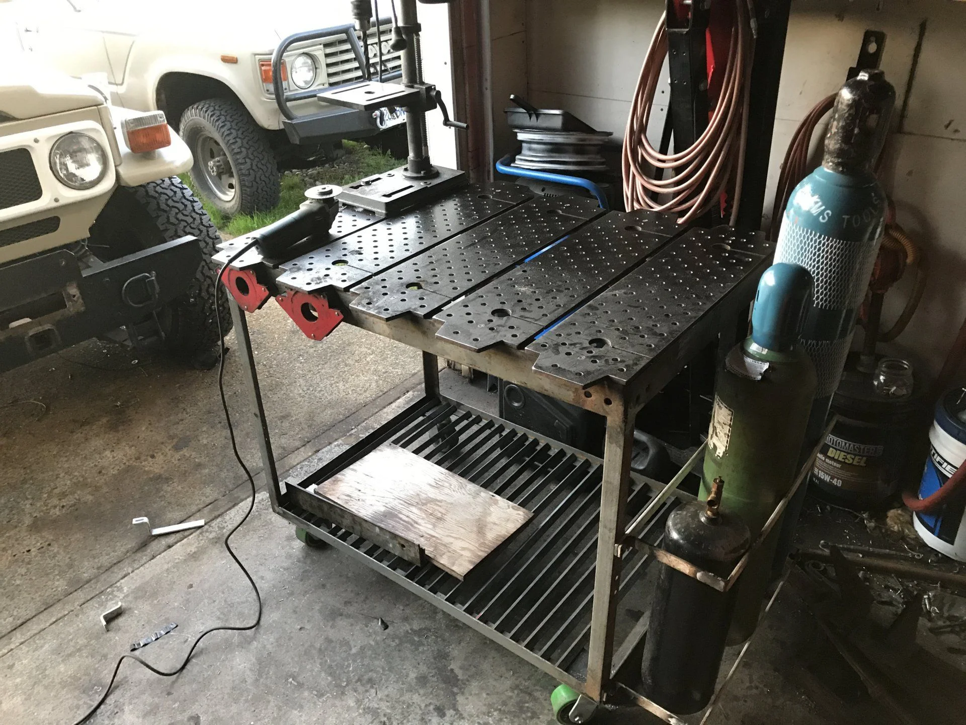

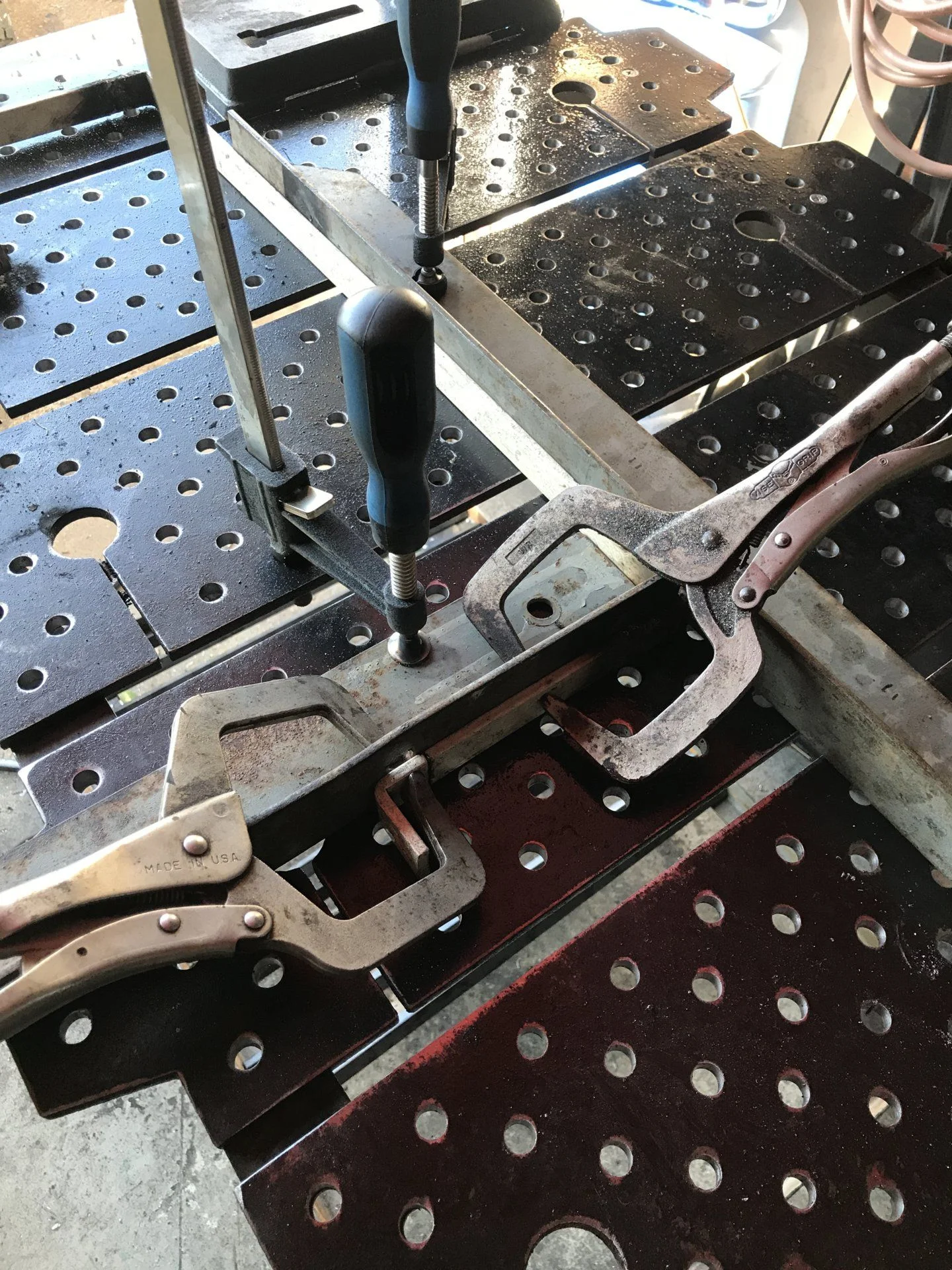

My latest project out of free steel is a welding cart/bench with fixture holes for easy drop in clamping. And a nice thick top for a heat sink. So I can weld even more!

Hey, lucky find @stevebradford... What were those pieces of metal w/ the holes for previously?
The pieces of metal are extra elevator counterweight biscuits

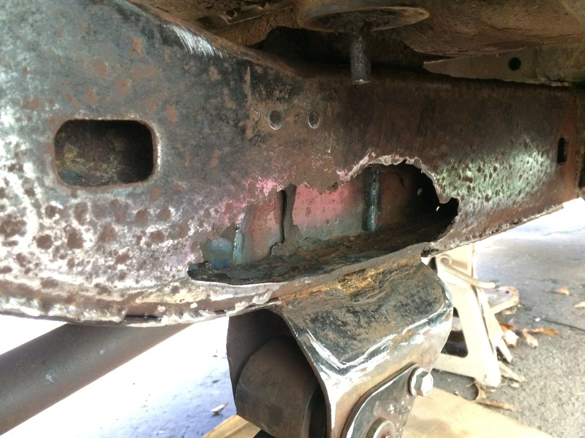

And that photo of yours above... I can only imagine, the rust hole was THAT bad? Amazing to think mine could be so much better than anyone else's!
