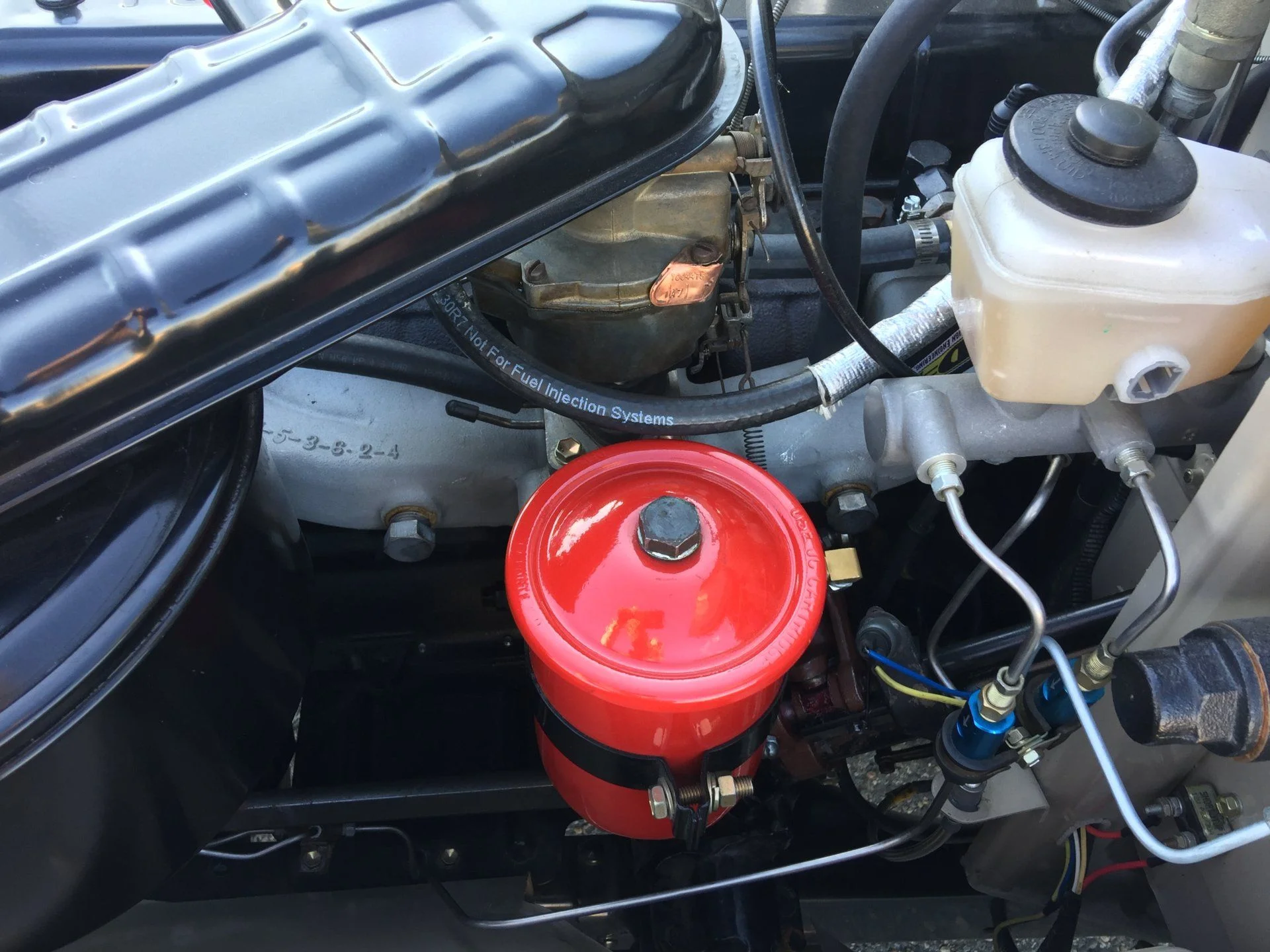

The photo below I use a 1” Tacoma master cylinder to 4 D154 GM brake calipers, no booster, stops awesome. The blue things in the brake lines are the residual valves. The residual valves are like check valves that maintain a minimum pressure at the calipers. Keeps the pedal rock solid....no pumps.

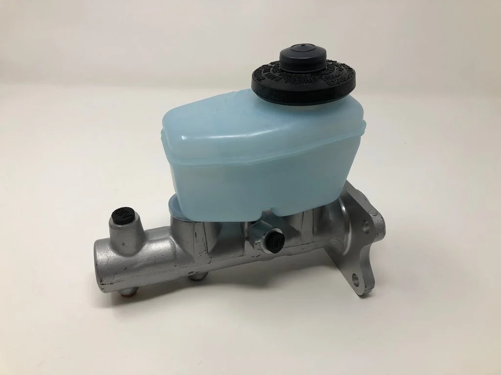

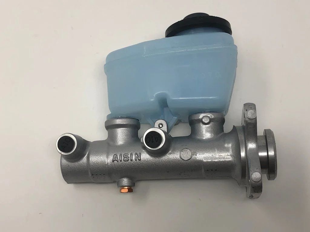

This photo is from the City Racer site
The bottom pic is the ABS type
That master cylinder looks like a non-abs and Non residual unit used on Forerunners, T100’s, etc... they are pretty common and pretty inexpensive. I think those trucks used some sort of load sensing proportioning valve instead of a residual to the rear circuit.

What's up with that rear line at the MC? It looks like it's been ground down, so could it be leaking?
