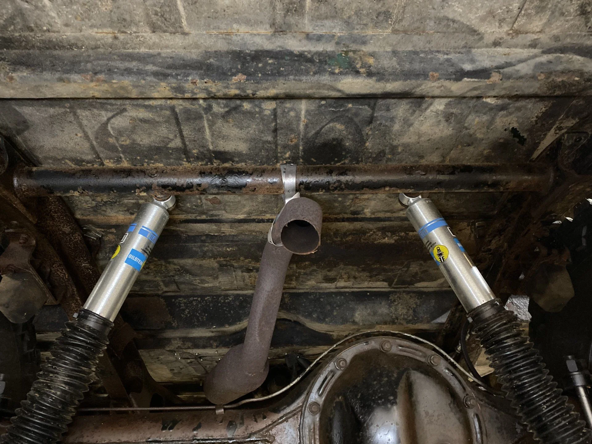

One of the plans I have had was to clean up the floor real good and Lizard Skin it from below.
I scrubbed and scraped and cleaned and realized no matter what I did under here I would simply be making what rust is under here worse by locking it in between layers of this stuff.
Soooo.......Fluid Film it is. I am happy with this decision.
Don’t laugh at the exhaust.
I laughed at the exhaust....sorry
