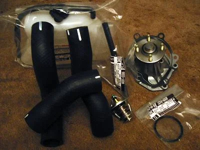

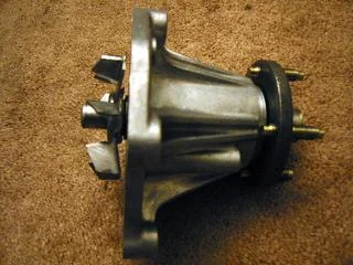

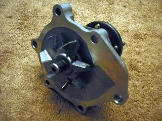

Well i got new one here planning to install it this summer with other bunch crap radiator, hoses....etc, Oh and lemme post pic new water pump :grinpimp:
