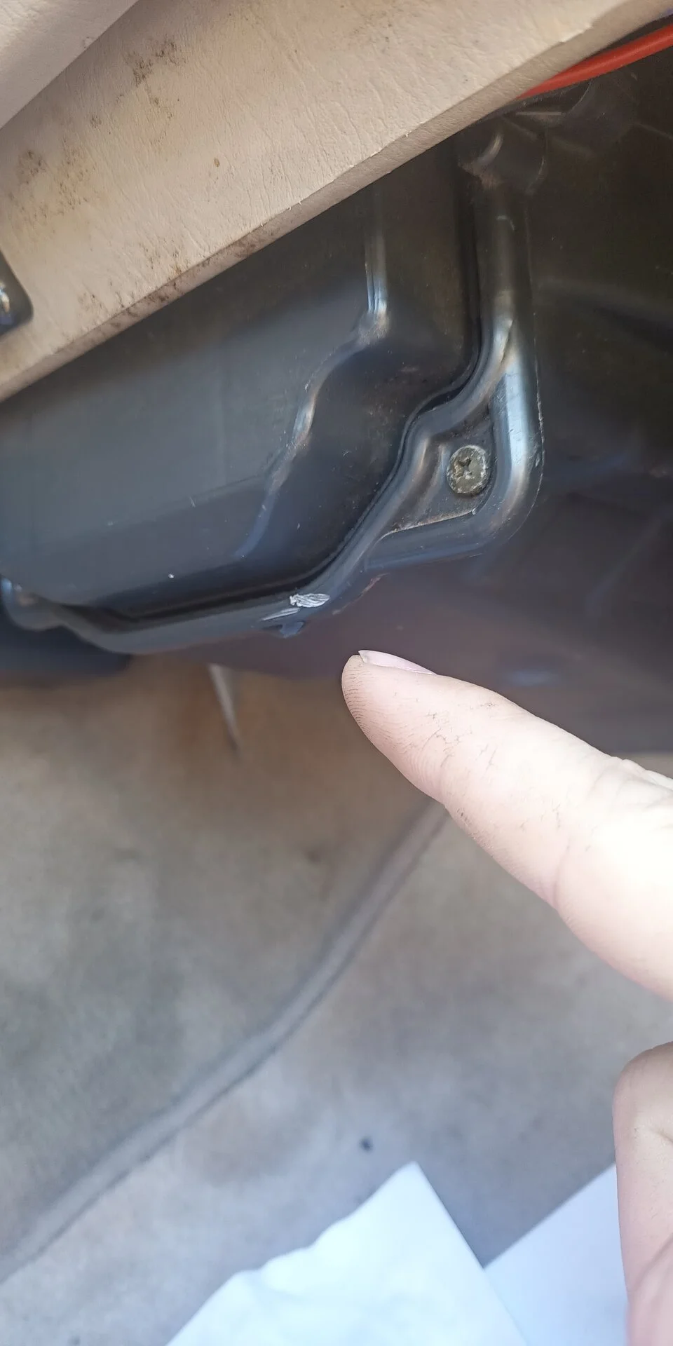

Today was 97 and about 35% humidity but the past couple weeks I've been running my air conditioning on high and I've noticed I'm getting water dripping out from underneath the dash. I still have water coming out underneath the vehicle through the drip tube coming through the firewall but what would cause water to come out from underneath the dash.

I've got a picture of where I believe it's coming out of at least it's where it's tripping down from.
Clean the AC drain. It is located right on the other side of the fire wall and can be seem as a black rubber hose pointing down.
Just found this on mine yesterday. Pulled the cabin filter cover, gasket was basically trash, filters and area were disgusting.
Part number for gasket (88578-47040) doesn’t return as a gasket in the store. Will order and report.
Will follow as I am in same boat.

I've got a picture of where I believe it's coming out of at least it's where it's tripping down from.View attachment 3382625
if you have a sun roof check the drains for blockage and also remove cabin filter cover and clean out leaves dust buildup good luck
I did that last year I believe I ordered some fish tank tube cleaners that were like 5 ft long and scrub them all the way out.
