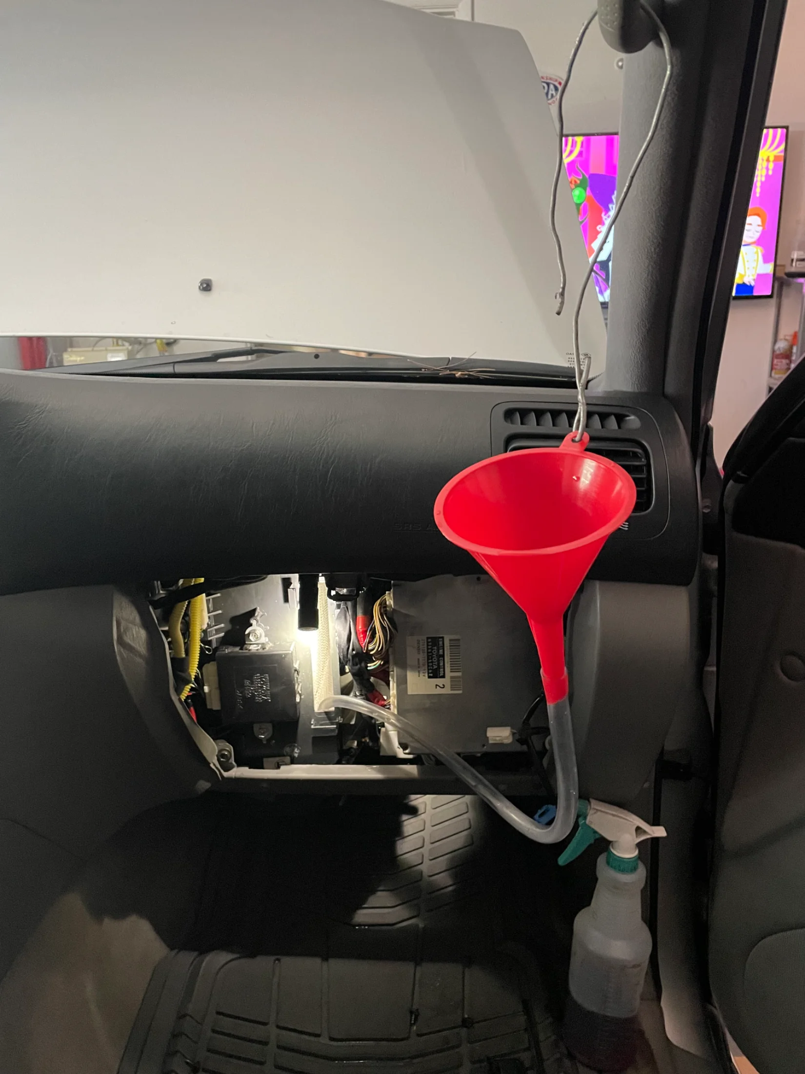

That’s usually from your evaporator core. If you’re able to service it that unwanted odor should disappear.
Open your cabin filter door to get a visual on the the condition of your evaporator fins, then service accordingly:

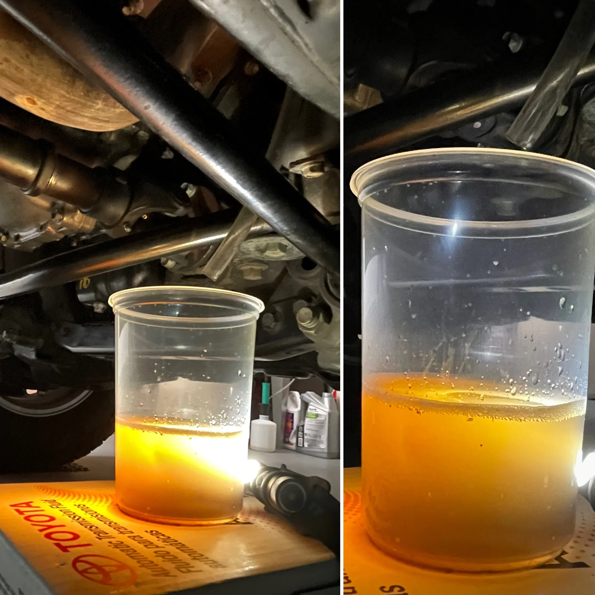

Combination of toothbrush, sprayer, funnel, hose and warm water to wash down dirt from the fins through the drain. I extended the drain using an 90° elbow fitting and clear hose you can get from local hardware store (this also help reroute that drain water from rusting your stabilizer bar bushing clamp and bolts-nuts).
Repeat process until drain water looks clear.

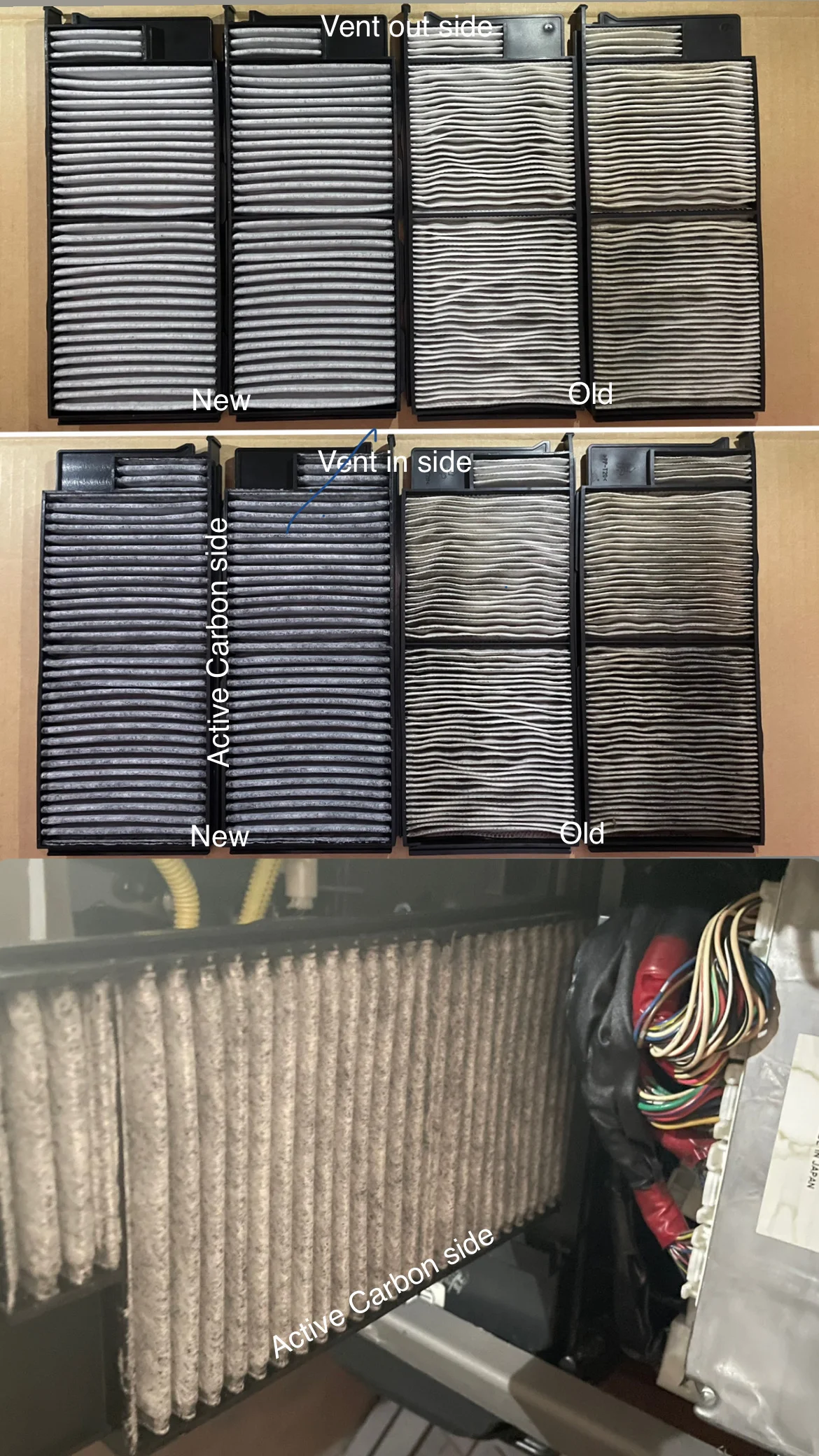

Replace (if needed) your cabin filters as well.

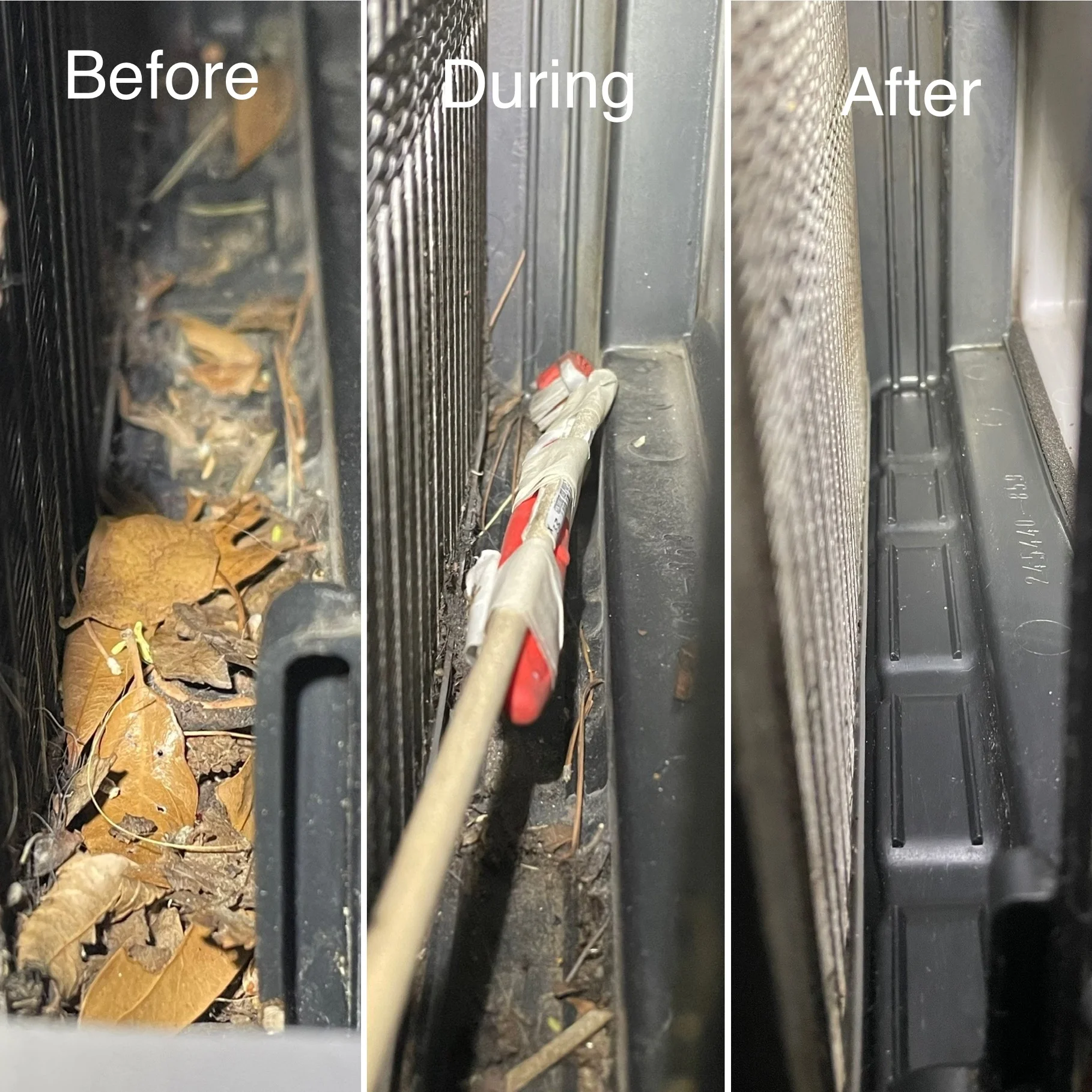

Yes, this is the way. I’ve even taken a garden hose right to the condenser in both of mine. Since the earlier vehicles didn’t have filters, it can be very dirty in there. Later vehicles with filters from the start are much cleaner. When cleaning my cores initially, I pulled off the whole front door and replaced the seal in that as well. The picture of leaves above are not an anomaly but a standard. Simple green or coil cleaner, a hose and making sure to install carbon filters will keep it fresh. I’ve never found these vehicles to keep the moldy smell (like a tight European vehicle) once they are cleaned because they have an auto function and don’t naturally default to recirc. Usually the cars that are worse, are very well sealed, and kept in recirculation mode all the time. These systems are not that sealed imo.
