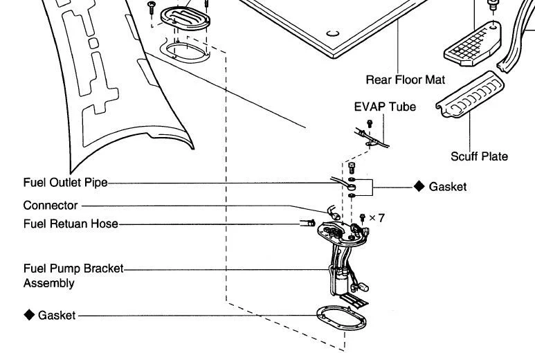

I've looked at 50 plus parts diagrams and searched threads unsuccessfully.
Please....Can anyone tell me if the fuel supply line at the tank (the banjo fitting) should have a washer?
Yes, it does require a copper washer.
You can get similar sized ones from O'Reilly Auto Parts. Carry in the old ones or buy the multi-size kit. You need TWO.
Thank You. Whomever was in there before me failed reinstall it. Luckily it was still sitting on top of the tank. I installed it, so all good. I'll be back in there in a week or so replacing the fuel gauge sending unit and tank seal.
