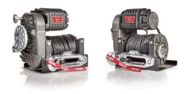

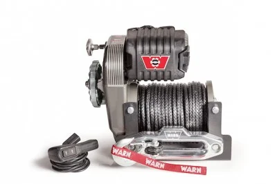

Very cool limited edition M8274-70 70th Anniversary with up graded 6HP motor rated at 10K lb pull power and 10 improvements to the 8274
999 limited run worldwide
Warn M8274-70 70th Anniversary Winch
Hate to see what they may want for it ....​
But I'm glad to know that it's rated at 10,000 lbs, since I have the same 6 hp motor on mine.
$2499.99
I have the 6HP motor on mine as well...I was happy to see that it brought 8274 into the 10K pull power range ;)
So, 1974 (when the 8274 came out) is not 70 years ago. Still a nicely upgraded winch. But at $2500 they will have a tough time selling these.
But it does look like some nicely upgraded components, especially the Albright contactor.

Yes, Im guessing it must mean WARN is 70 years old not the 8274 which was 1974, from what I gather...

I like that they drilled and tapped the main shaft for a bolt and washer setup verses that C clip.....

I like that WARN is using a "bolt and washer" for securing brake assembly on...wonder if they will sell them as separate parts, I would like to convert mine over...
