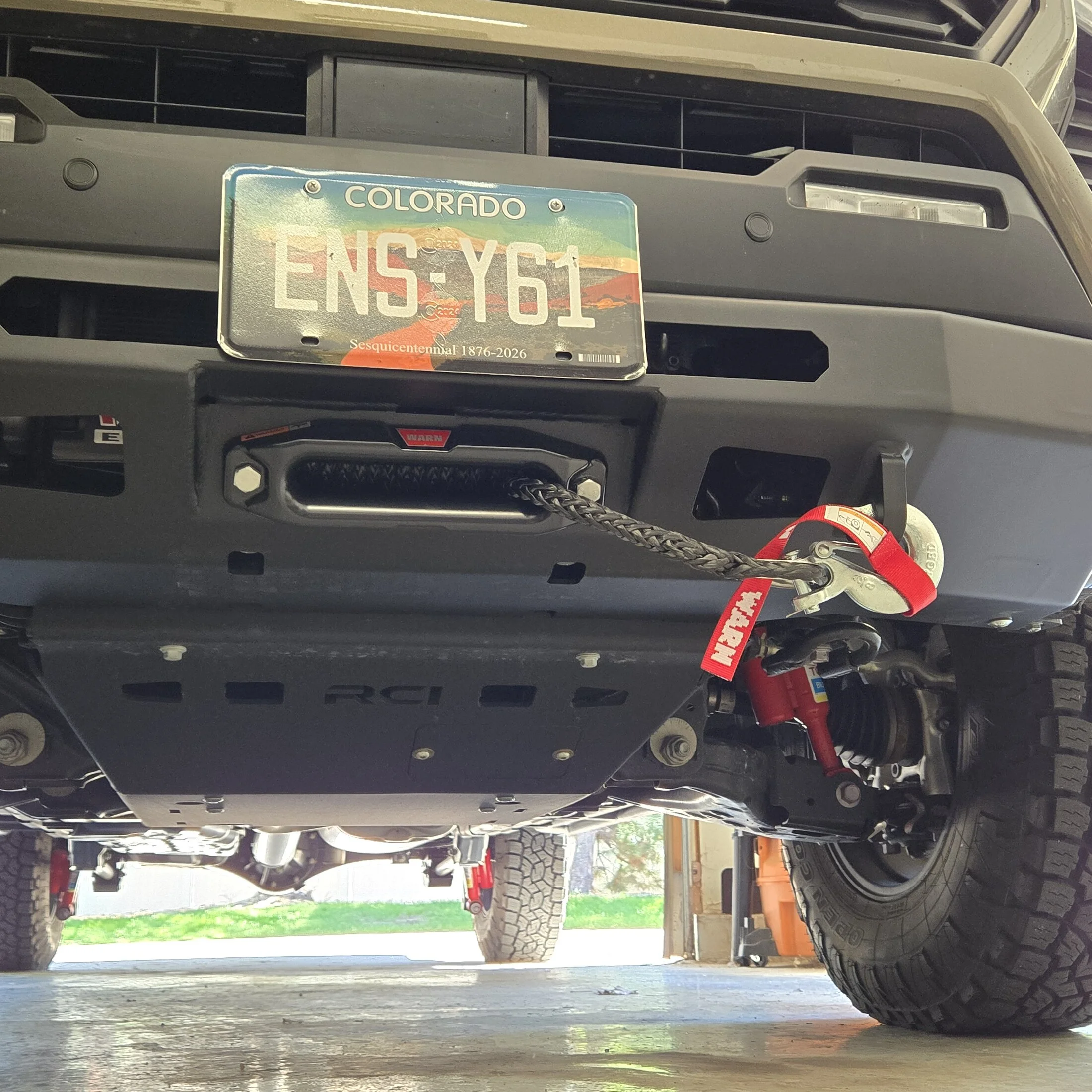

From what I am reading, even though it is wireless with the remote, I would need to install a wireless hub to use the phone app to control it, is that correct?
The app will connect to a Xenon Warn winch or a hub controller. Since it is already wireless, this seems to be a poor implementation
I can get my hand in the hole (see photos) to work the clutch, attaching the control cable would seem to be challenging if the batteries die. I haven't tried it yet, but it is tight getting my hand past the clutch. Guess I will need to carry fresh batteries and a small screwdriver in case the wireless remote batteries die.
It says if you install the hub, you should disconnect it or there will be battery drain. No comment on battery drain with the wireless remote.

This is on my 2024 Tacoma
