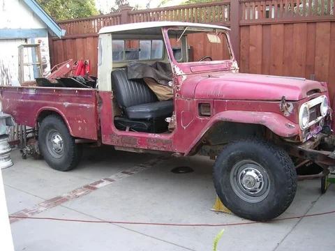

front hub caps on the back seem a little out of place.
even on blocks, it's still a very nice 45...
crusty
