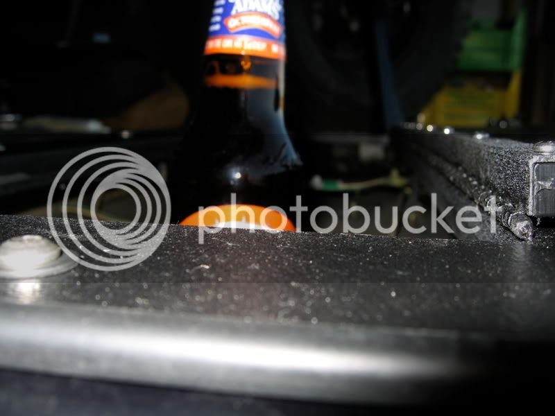

The construction along with the hardware used are both top notch. The seams/gaps are matched and aligned well. The door is well constructed with a full length hinge. The wrinkle finish appears to be durable. The supplied hardware consists of stainless button head bolts and washers. The nuts feature a locking ring fixed at the base. The rubber weatherstripping is nicely matched in size and also fits well complementing the overall quality of the product.

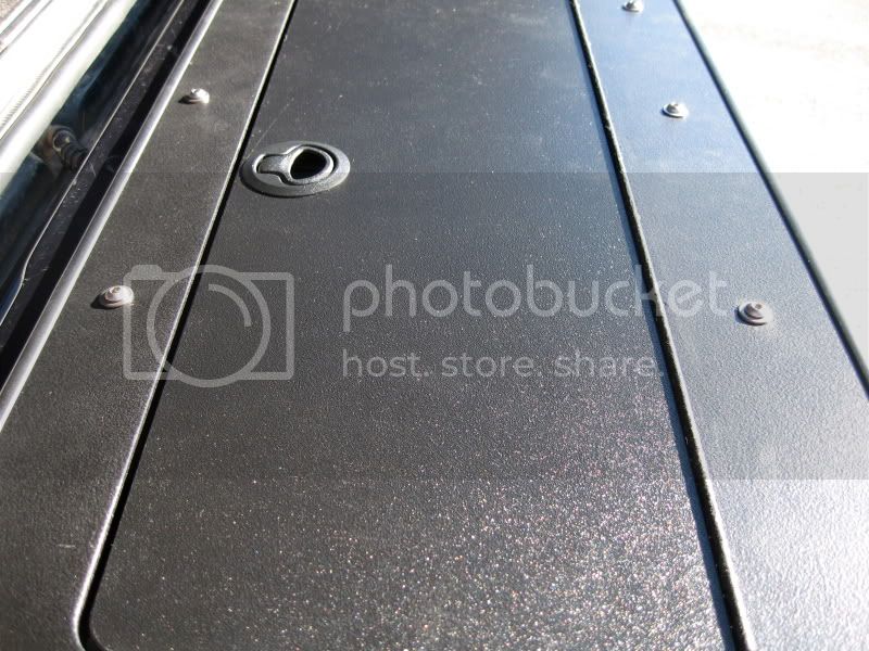

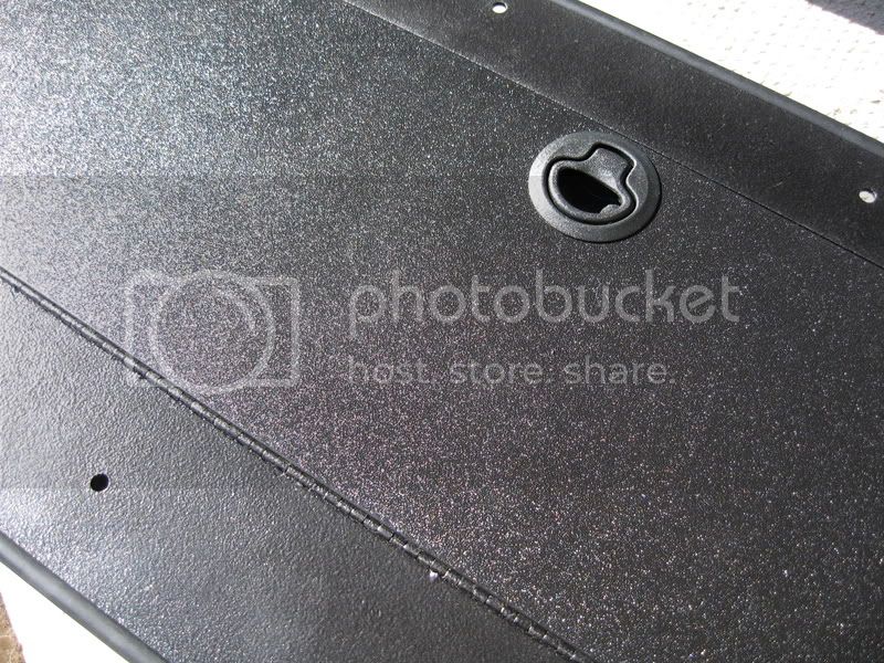

Door detail.
Latch detail.

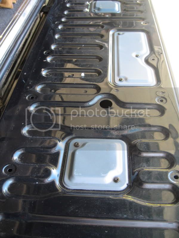

The virgin tailgate after being stripped of the interior carpet and before the template was placed.

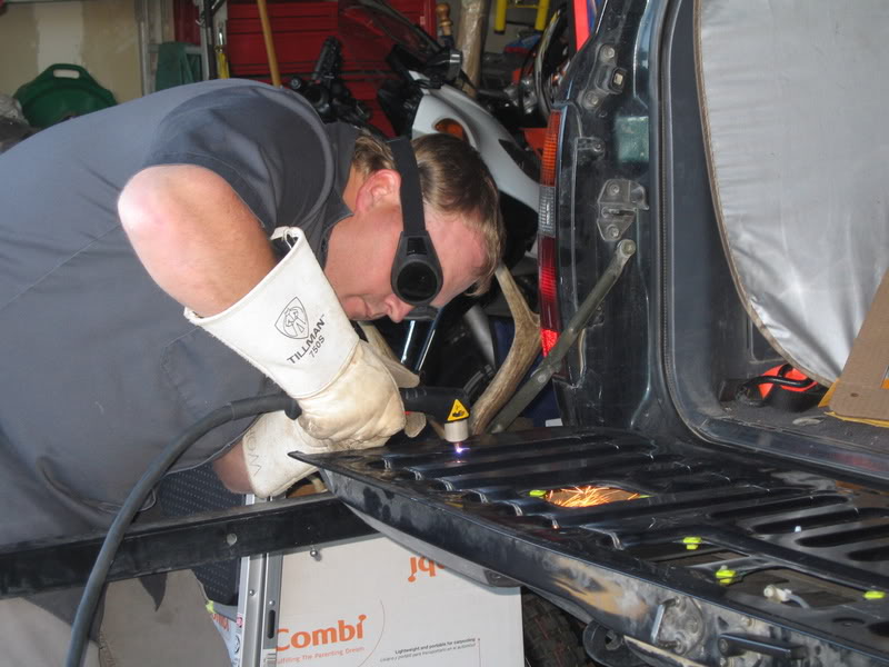

So, yesterday ended with my needing to get a 20 amp AC plug adaptor to operate the plasma cutter. After a quick trip to the hardware store, I bought the correct 20 amp wall socket came home and wired it into the wall. That was after verifying the circuit breaker was also rated at 20 amps.
I finished removing the anti-rattle foam inserts for the tailgate lock bars. There are two of these.
I also removed two of these little round rubber inserts. They would have melted and made a mess with the plasma cutter.
The tailgate ready for the cut. The template has been traced with a welders pencil.
The only cut that hurts is the first one.

Here I'm using the scientific method for measuring depth. This is to illustrate how deep the tailgate is on the 80 series.
An observation for the installers out there.
In this pic you can see two support braces (In the top of the frame) or what's left of them. I had to turn up the amperage on the plasma cutter to penetrate them fully. Also be aware of the wire loom for the license plate bracket. I unclipped mine from the sheet metal, then placed a welding glove over it for protection.
Also located in the same general vicinity of those vertical cross braces are a series of a spot welds (I think three or so). They run horizontally across the tailgate from the driver's side to the passenger's side. I made a simple half circle cut around these spot welds keeping my cut pretty tight to the spot welds. If you cut "Below" the spot welds you are left to deal with half of a cross member.

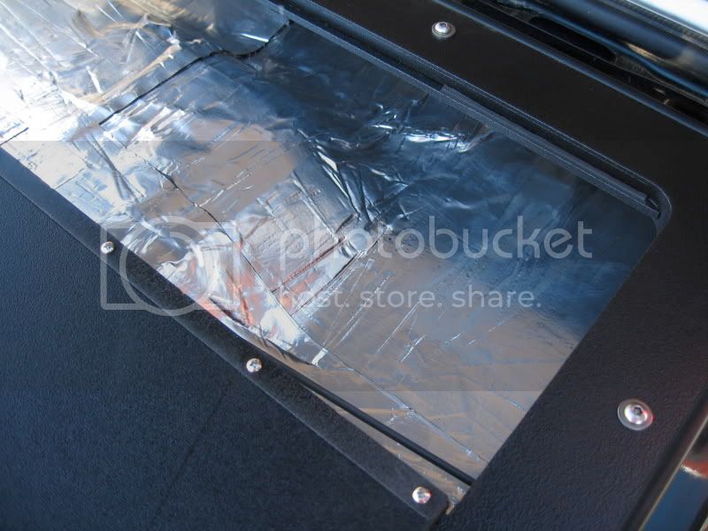

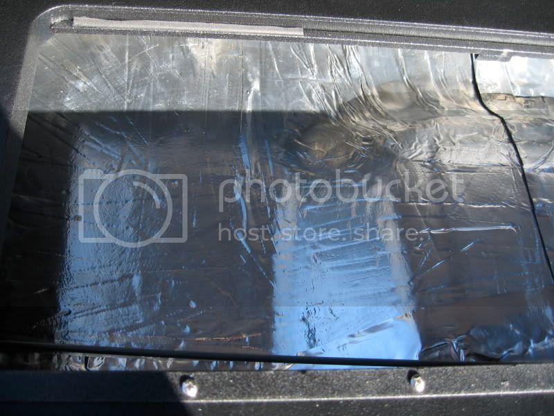

I started in the corners and worked my in from there. I used one full sized sheet in each of the corners. I peeled the backing paper about halfway off, so that the entire sheet wouldn't stick at the same time. I then used a heat gun to gain some flexibility only because it was pretty cold this morning (The directions say you do not need to use a heat gun...I'm impatient).
I then used another full sheet to span the small gap leftover by the corner pieces. This was working from the hinge side towards the lift gate side.
For the remaining top portion I cut a full size sheet into thirds and that provided enough coverage for the entire tailgate.
All that's left was a trip to try it out. Before the Damplifier Pro was added there was a "Tin" like sound coupled with rattles every time you drove the truck. After the install, I am very pleased to report that the "Tin" sound and rattles are gone.
