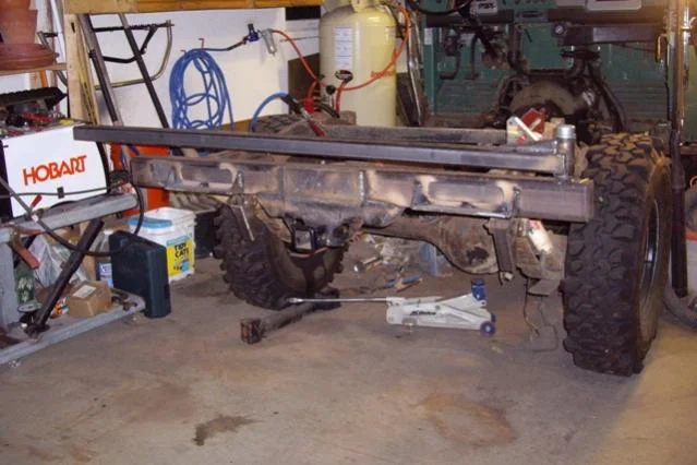

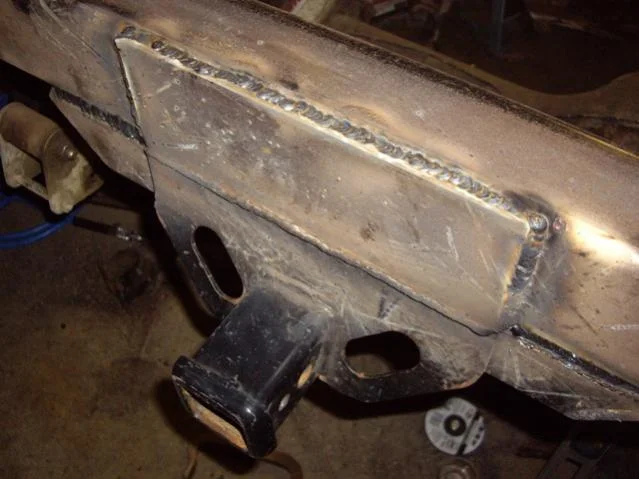

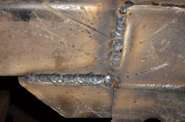

Made solid progress rebuilding the rear frame and new cross member. I was really putting down some hot welds, several root passes before the pancakes. I am also using SEM copperweld primer...thinking that it might help me with penetration. The welder is a Hobart 187 (220V) so i have plenty of power....just short on technique.
Open to criticism or thoughts......

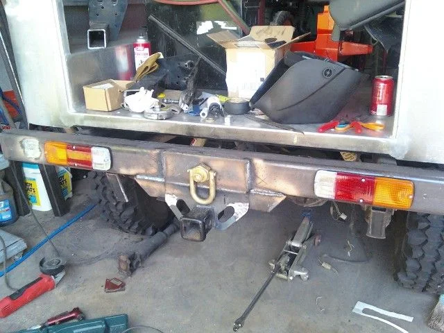

And some of the bumper in progress...
The plate above the receiver hitch is meant to reinforce the bumper from a recovery. I have a nice swivel hoist ring that I want to mount but would like to have this ring mounted to a reinforced section.

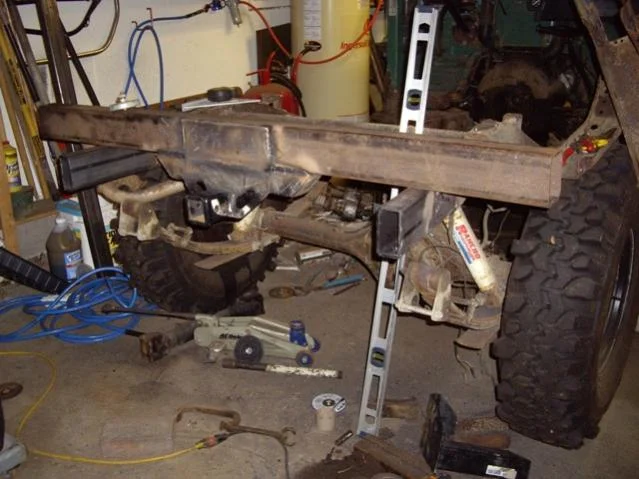

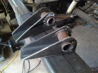

Late Saturday night and Sunday....I was able to add some gussets to the rear frame in order to mount my new shackle hangers. I fabbed up some shackle hangers, boxed out the rear bumper or capped it off. Then I put a hole into the bumper to retain the stock lights. Still have to do the other side.
I also put the tub back on the frame, thanks to some help from a not to happy wife.
Then...I started to load up the tub with everything loose in the garage...wanted to get some weight in there so I could drop the jack stands and see how the springs loaded down. I need to read up on how to place these shackle hangers. I am really not sure how to do this correctly....

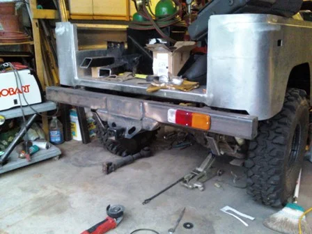

Found an hour today to finish the tail light fit up.
r
I also drilled some holes to fit in the recovery point. I picked up a 360 degree swivel hoist ring on ebay. Its got a 3/4 threaded bolt that goes through the bumper. I'll tighten a nut on the backside through a new hole on the backside of the bumper.

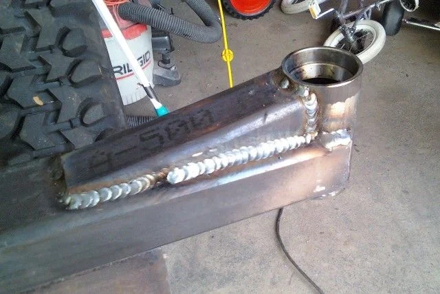

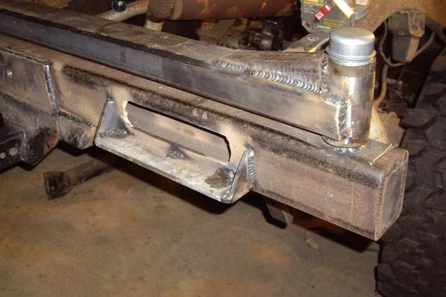

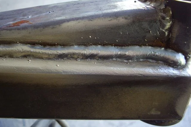

Got the swing out tire carrier set up tonight. I used 1/4 inch 2x3 box tube for the main arm. It is very heavy, but I wanted to avoid major deflection over time. I also really took my time with the welds on the spindle carrier, lots of cleaning, weld through primer, etc. The gusset is probably overkill but as I am not a professional welder, I thought to be on the safe side. The swing out arm actually rises about 1/2 inch over 4 feet. This was not intentional, but probably will work in my favor once the weight of the tire is added on.
I also fabbed up some tail light protectors. I have busted three lenses and am tired of replacing them.

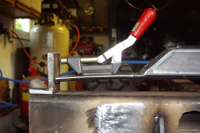

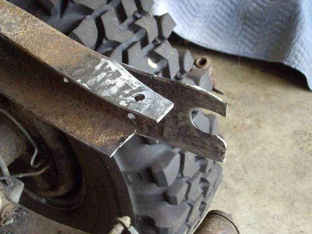

I think I am at a stopping point on the tire carrier. Today I fabbed up a latching system..see the picture below. It will probably work fine. However, I still need to get the tire carrier built up and I don't even have a spare tire yet. I think I might stop on the tire carrier for now. The bumper is basically done, though final wiring is needed and some groundings.

Looks great, but I fear the latch plate is really thin.Why the taper there?
I am not all that happy with the latch in its current form. I think it tapered down while grinding the metal. It must have heated up and bent a bit, that's all I can think of. Its not purposeful. I forgot about that spare tire...thanks.
Simple, but effective! Nice job.

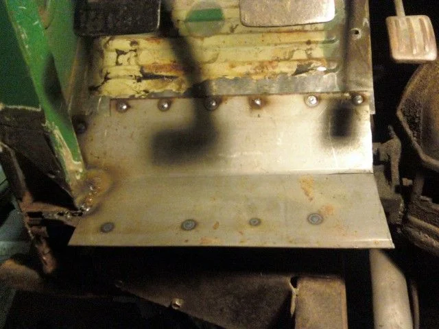

Spent about 2hrs this afternoon cleaning up the frame from the cowl back. I used a wire wheel and needle scaler to do most of the work. This evening I cut out several inches of rust floor boards underneath the pedals. I then bent up a piece of 16 gauge steel and tacked in in. Most of the visible steel in the picture will be covered by the aluminum tub, but a few bolts are needed in this new area. I wanted it to be strong.
