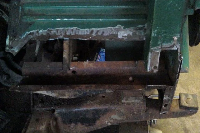

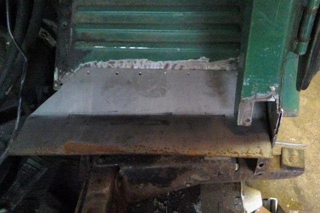

I was able to cut out some rust on the passenger side this evening and tack in a new patch. I am using 16 gauge and making loads of use of a air powered reciprocating saw. I lost the lock nut/washer to my angle grinder and can't use my regular cut off wheels. I am sure it is under the pile of debris on the floor.
Not quite complete in the pics below...but getting there.

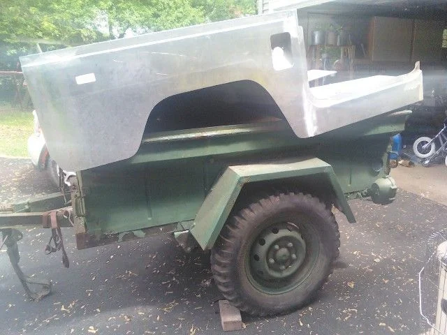

Since I am healing nicely...I was able to work on the floor patch panels again this afternoon. I also got the alum tub loaded onto the trailer (with some help from the father in law). The tub needs a bit of work before installation.

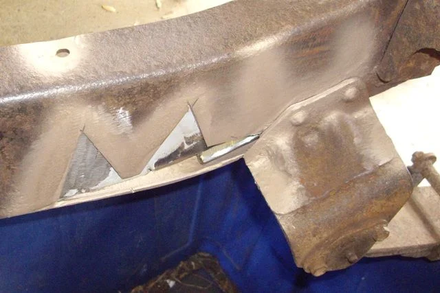

I have a crack on the passenger side sill that needs to be rewelded. Here is the original thread with pictures and such: https://forum.ih8mud.com/40-55-series-tech/260111-aqualu-aluminum-tub-crack.html
So, I contacted an autobody shop in Hinesburg, VT that also does a lot of aluminum fabrication for various dock construction companies on Lake Champlain. I am hoping they can lay down a 12 inch bead for me and not charge me an arm and a leg. This afternoon I cleaned up the crack in the sill, ground down the original s*** as weld, and prepped it for the garage to take care of this week.
easier to borrow my pickup for a few days to move that around?
I can rock the camry....
Thanks for the offer. I will likely drop off the trailer/tub combo at the shop and leave it for them to fit it into their schedule. I can't imagine that it is more than 15 min of work with most of that getting the trailer into the aluminum welding bay. Course...now I am thinking that I am going to get ripped off...and lose my 416 and alum trailer.

I am sure they rounded up and nearly claimed an hour of work, but in fact I did the prep on the weld bead, drilled out the crack ends, etc. Just seems steep for a 12 inch bead....anyway....karma comes around.

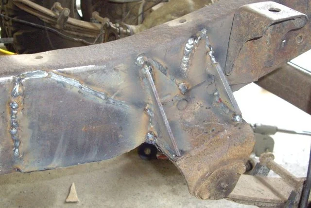

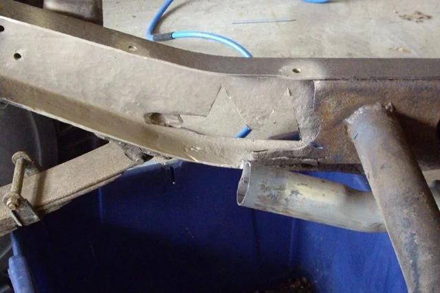

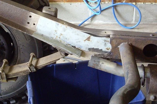

The drivers side front leaf spring hanger developed a small frame crack. I knew it had to be addressed and some scab plates welded in. Some of the frame areas in this section were paper thin. I cut those away and left areas that were 14 gauge or better. I then took a piece of 5/16ths angle iron and started cutting it down as a interior plate for the frame. After that was welded in place, I attached a triangular plate on the outside of the frame using 1/4 inch. Several gussets were added to the original leaf spring hanger for reinforcement.
I was also fighting my welder all the time...really sloppy welds today. Might have been the beer.

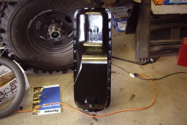

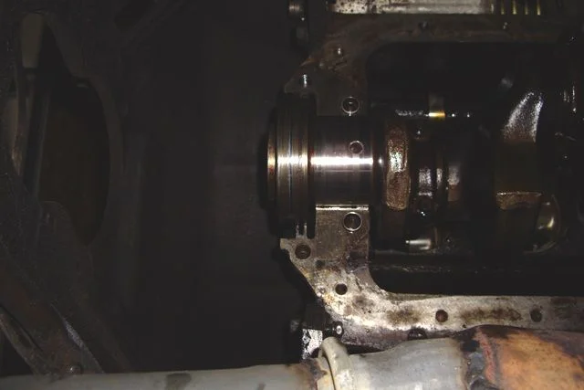

I also went after the rear main seal. I removed the oil pan, got it all cleaned up and inspected. Apparently the spot welds can create rust holes in the oil pan over time. This was not the case with mine. I degreased it and painted it up. I also tried an intermediate step using a diluted phospheric acid wash to as a rust converter. This worked well and likely killed a 3 x 4 section of grass.
To remove the main seal I followed the tech advice posted on this thread: https://forum.ih8mud.com/40-55-series-tech/139889-h55-splitcase-into-02-79-40-series-2.html
I removed the rear main cap, removed the rear main seal and inspected the bearing. All looks fine to my eye.
I need to find some proper gasket sealant and will start reassembly shortly.

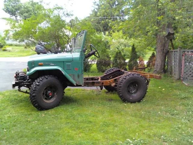

As good as mechanical progress on the FJ40 build...

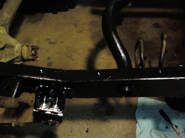

I got the bearing and oil pan reinstalled this morning, then set about to do a prepaint cleaning on the frame. I pushed the 40 out to the yard and degreased the frame one last time with a phosphoric acid wash (concrete etcher). I rinsed it all off really well then left it in the sun. Pushing the truck back into the garage was a bitch....full 20 minutes of lonely hell.
This evening I got to paint up the frame...2 coats of SEM rust shield.

I am making solid progress now......the frame is done....painted with three coats of rust shield.

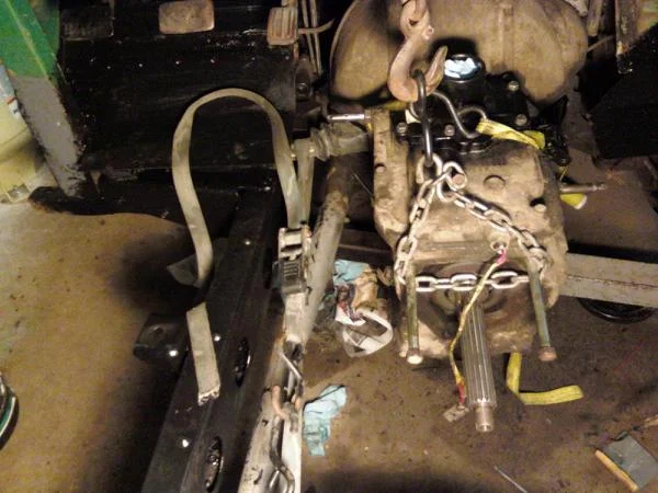

I installed the new flywheel, clutch disc, pressure plate, fork, pilot bearing, throwout bearing....all this afternoon. By late evening I had successfully stabbed the transmission back in. For me I made sure I had taken some emory paper to the pilot bearing shaft on the transmission, applied anti-seize, and also depressed the clutch fork using a compression strap. It was a bit frustrating to do it by myself, but the chubby I developed when it slipped in made it worthwhile. :)
