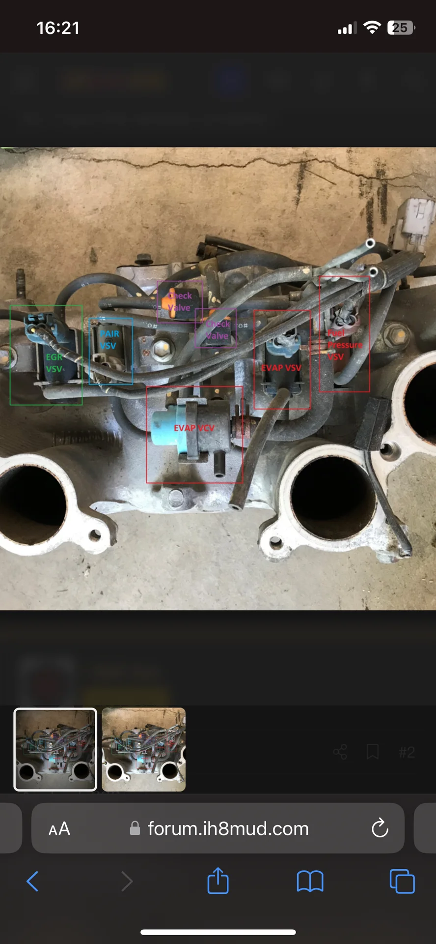

So, found out I have a leak in the plenum gasket, I’m pulling the upper off when i get the parts in, but under there I know are a bunch of VSV and VCV, I know some are related to ERG, I was getting the code a while back but did the resistor fix and now don’t really need a lot of these under here, or really want to do the hoses or more crap to go wrong, anyways would like to know which ones I can get rid of and cap off? I know I will prob need the fuel one, and maybe the EVAP for charcoal can, but if anyone has done this successfully on a OBD2 if u can please advise thanks!
