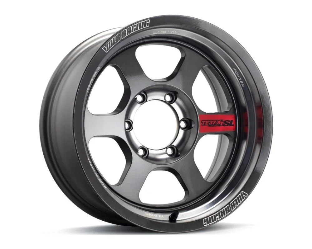

Anyone have experience with Volk TE37XT M-spec wheels on our 200‘s and if they would fit?
The size I am looking at is the only one they offer in out bolt pattern.
Link - Volk Racing TE37XT SL M-Spec Wheel 18x9.5 5x150 0mm Pressed Graphite | WVDOX00LPG - https://www.vividracing.com/volk-racing-te37xt-mspec-wheel-18x95-5x150-0mm-pressed-graphite-p-154756232.html

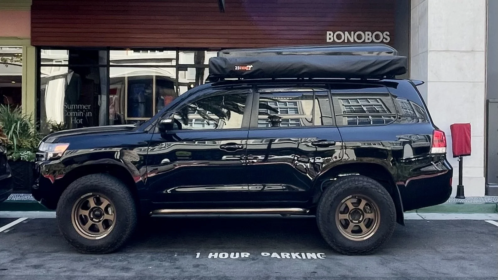

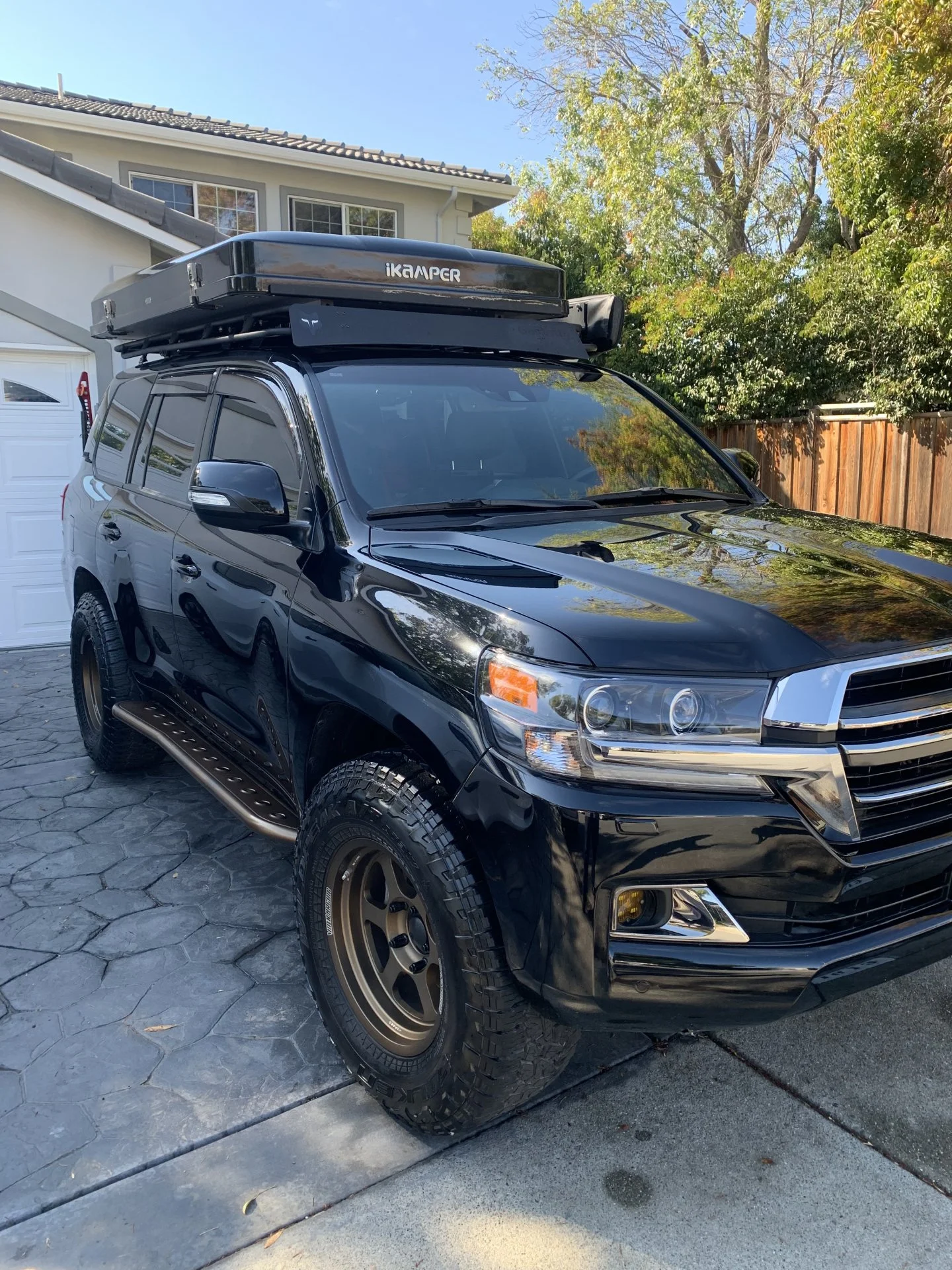

I have the wheels. Honestly not sure what the bore is but I cannot even fit the pass through center caps to make the wheel fit so I’m sure it’s the hub centric version,
These are Falke Wildpeak 295/70/18
I had to make adjustments to the fender liner to push them in more toward the front and also BMC. Sounds like a lot of work but the shop doing it does them a lot and I had my car back the same day. Looks very clean.
I do not notice a big difference in handling with the 0 offset but I was running the stock Heritage wheels with 25mm spider trax spacers prior. Maybe if I went from full stock to 0 offset I’d feel the difference.

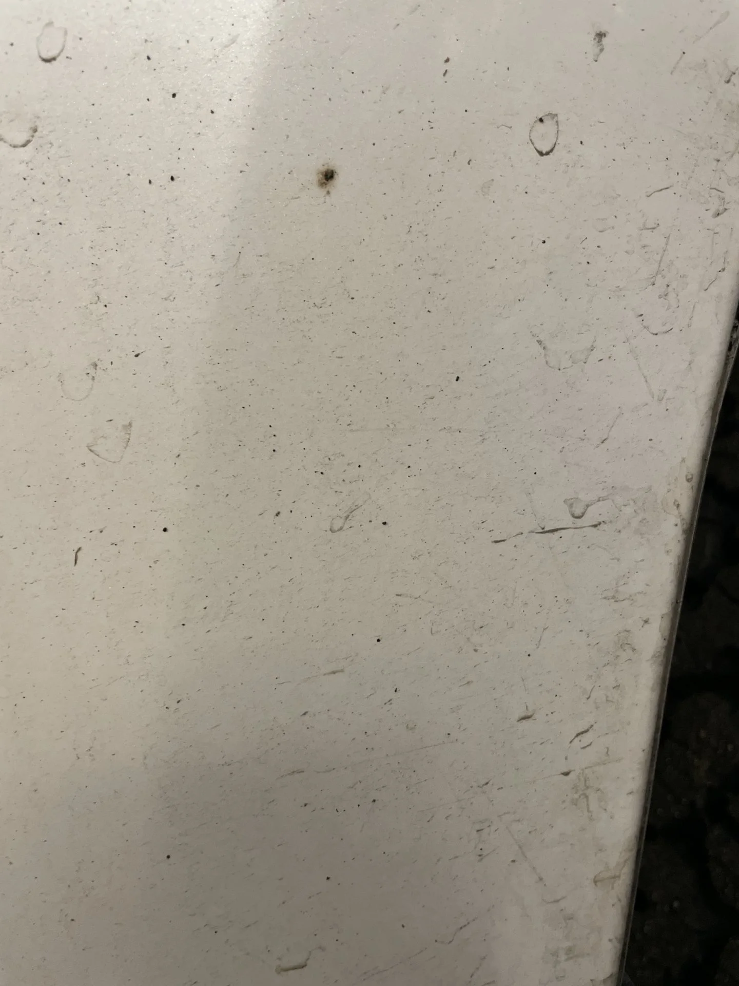

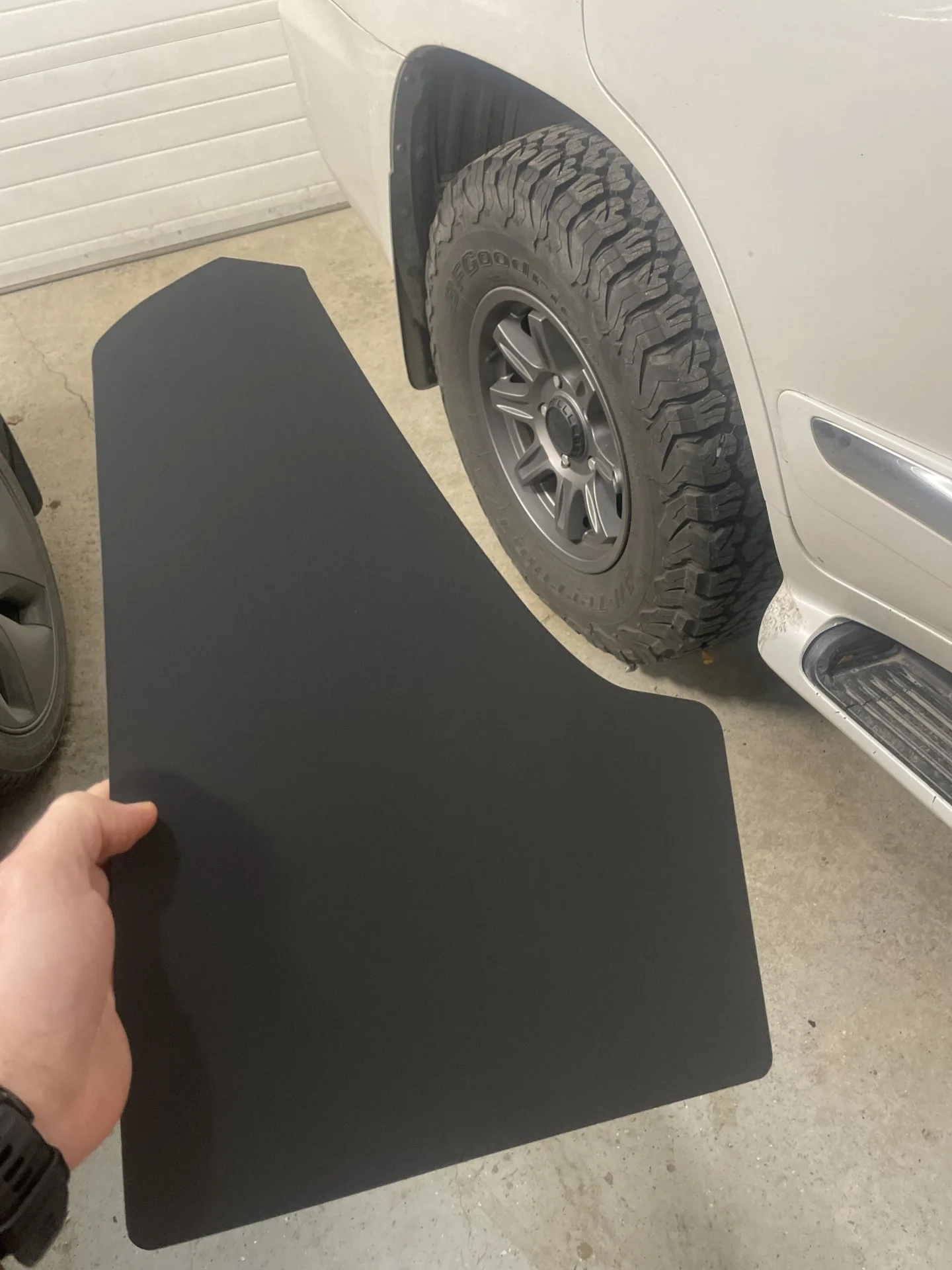

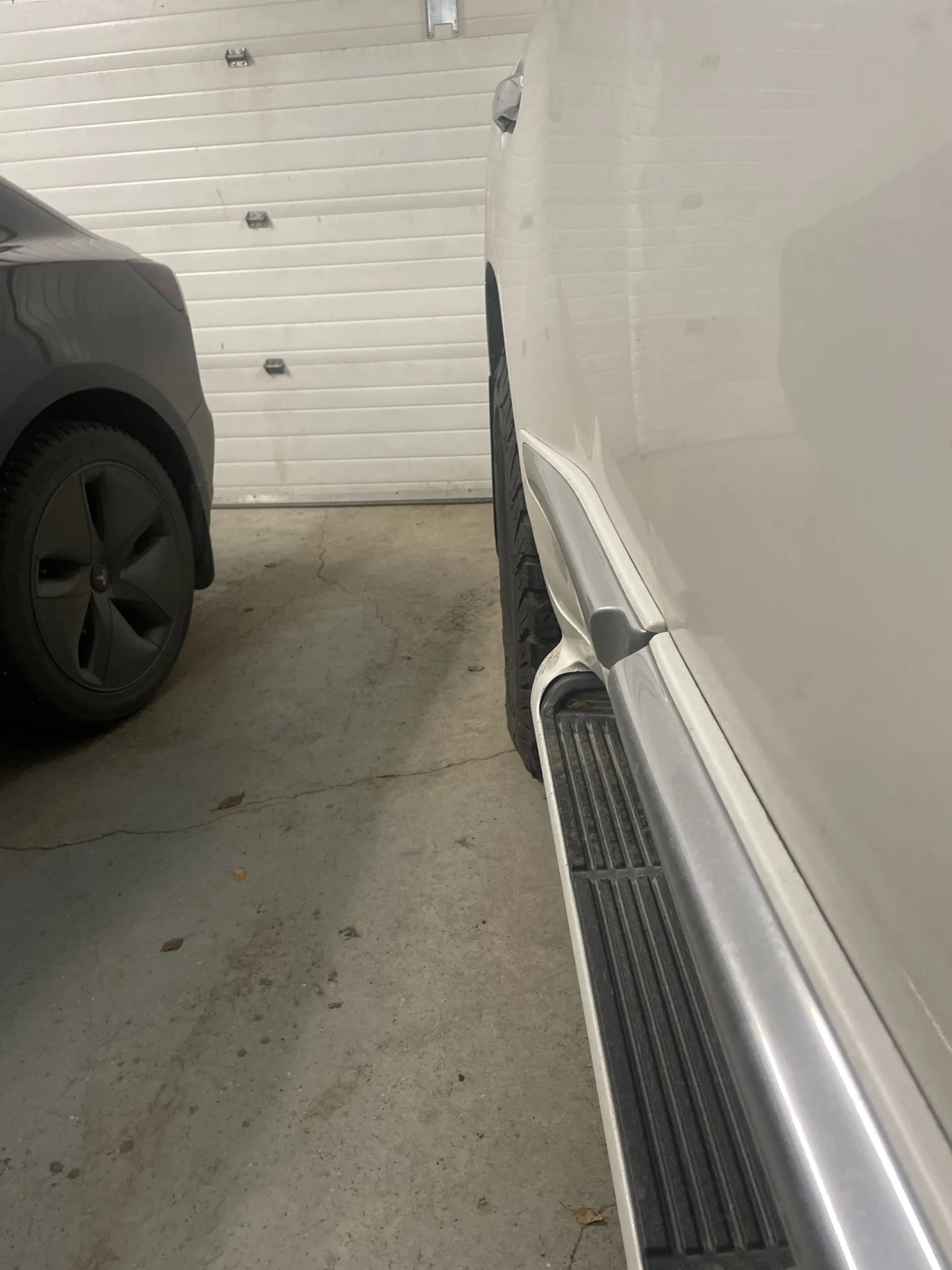

How do you prevent your paint from getting destroyed? I’m guessing rarely leave payment? When I went from a +55 to a +35 (picture of rear wheel) this past spring noticed that my paint is getting blasted (picture of a ton of chips)…. My project before next spring is to install rally style flaps.
I’ll add for context that I don’t really care about the cosmetics of my paint just worry about it from a rust prevention standpoint.

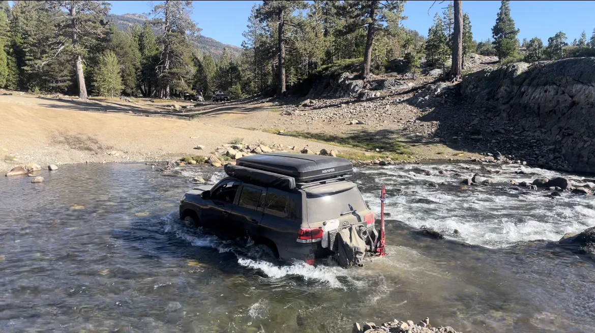

I’m not flying through dirt trails every weekend or anything but I try to get out as often as I can. Use paint protection film. I actually own 4 shops that install it lol. These photos are from last weekend. On dirt I may add.
