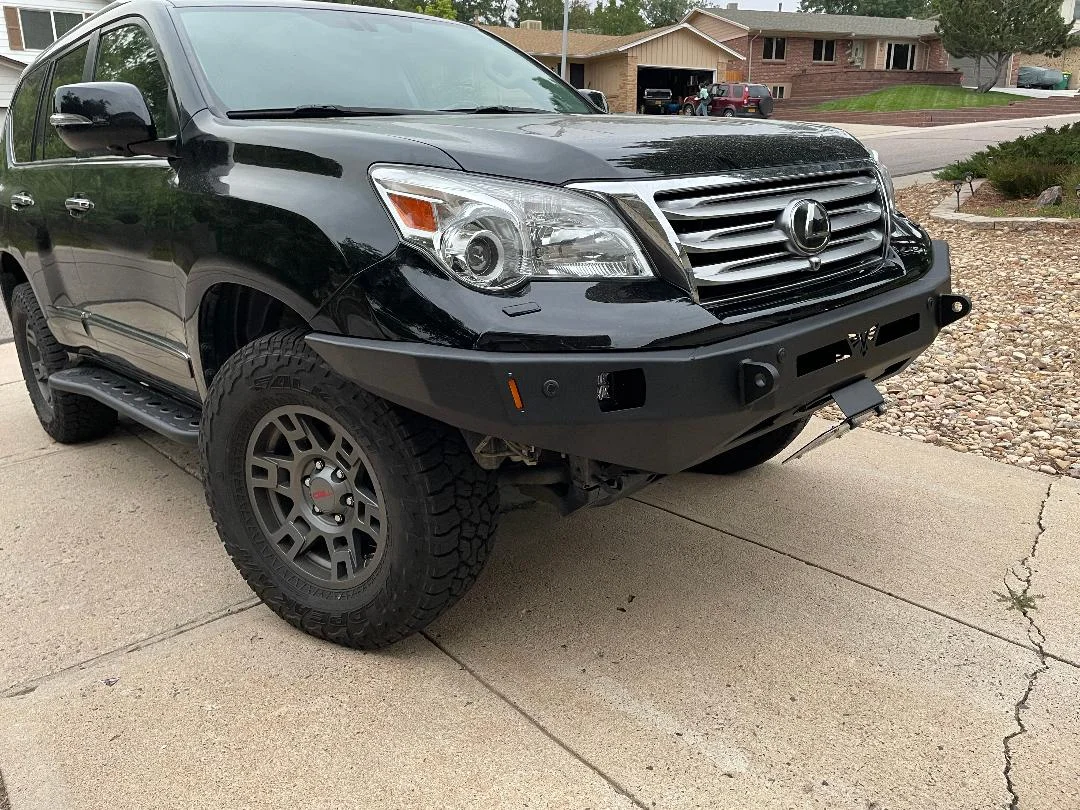

Installed the Strike on my '12. Strike Question - has anyone done the SSO washer bottle cover with it? Wondering if 1 banana install or gonna take some work to get it and the bumper to marry up. Or better to try a bottle relocation option

ordered it from Victory on 8/1/22 with website lead time of 60+ days. I saw on their website a couple weeks later that times were reduced down to 30 days and mine arrived 8/18/22. Mine was bare metal though. RSG here in Denver powder coated it to match their sliders. No communication during the sale or wait other than the sales confirmation email and tracking once it shipped - but I wasn't expecting any. It is a really good looking, clean bumper and totally changes the appearance. Fender liner cutting/securing is a concern with the wide open front vs. OEM as I found out on the highway the next day. And then trying to figure out how to hide/protect/relocate washer, wires, etc. like my question to start the thread.

I put one in mine, see here, but I see you have headlight washers? The SSO cover will only fit a reservoir with 2 pumps, and not with the third for the headlights. More discussion in the thread I linked.
The SSO washer bottle cover wont fit three pump tanks and that relocation kit wont work for three pump tanks either.

thanks for the input. I do have headlight washers(as I drive around with my pinkies up eating my caviar) so that makes sense with the 3 pumps being an issue for the 4runner/GX SSO part. Thanks to @Washingtontaco and @re_guderian for the education and food for thought
